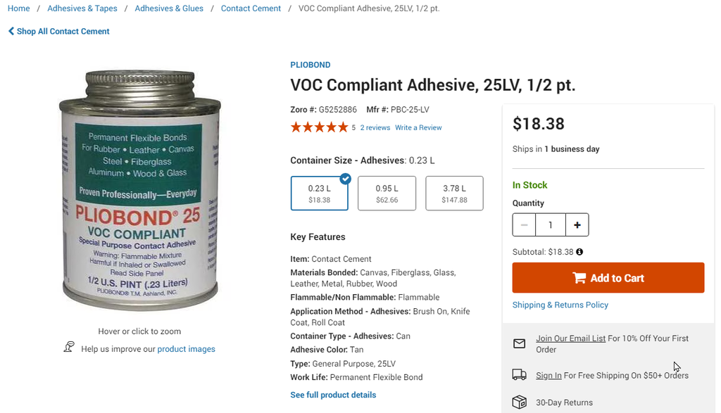

davem1111 2,267 #3 Posted May 8, 2023 15 minutes ago, JoeM said: I have seen Loctite brake lining adhesive kits that can be used on clutch plates. Never tried one. I have used JB Weld on the brake bands and it worked. What about this stuff - I googled for the loctite adhesive and this came up also: Share this post Link to post Share on other sites
JoeM 9,650 #4 Posted May 8, 2023 If it can take the heat? Seems pretty pricey, but what isn't 1 Share this post Link to post Share on other sites
davem1111 2,267 #5 Posted May 9, 2023 5 hours ago, JoeM said: If it can take the heat? Seems pretty pricey, but what isn't I looked at the Loctite stuff and it's a lot more expensive for the amount you get, so I ordered the Pliobond and 4 disks. Well, this will be an experiment. I'll put one of the refurbed plates on my main mower, and let you know how it works out. 2 Share this post Link to post Share on other sites

Racinbob 12,812 #7 Posted May 9, 2023 (edited) JB Weld works great like mentioned. I don't like the stated 'permanent flexible bond' statement on the Pliobond. heat may not be a problem but it is next to a hot engine. Edited May 12, 2023 by Racinbob 1 Share this post Link to post Share on other sites
