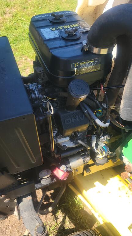

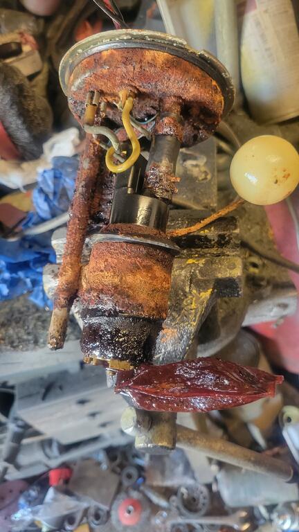

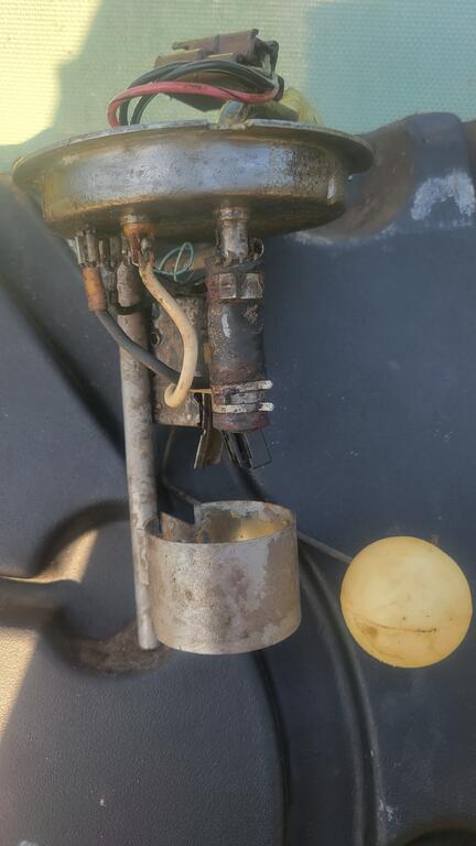

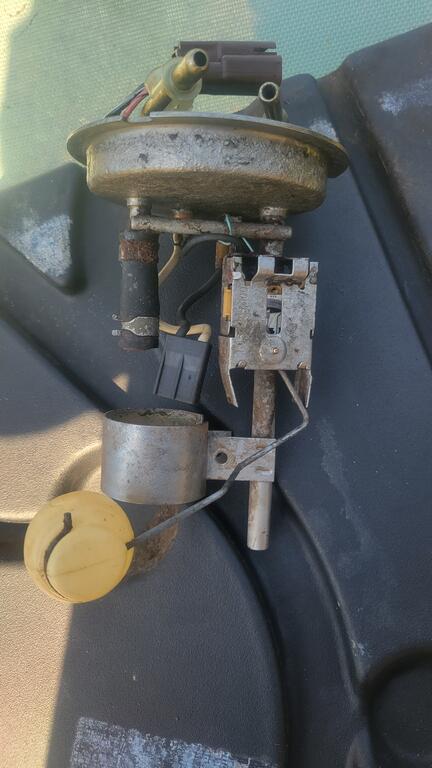

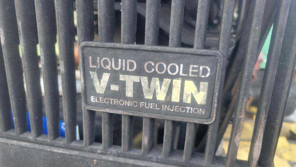

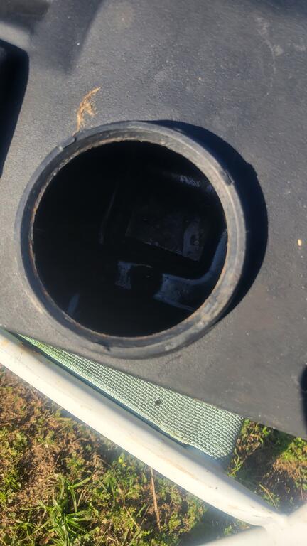

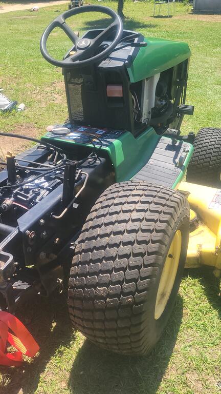

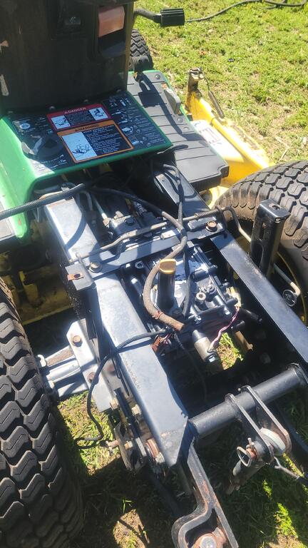

RED-Z06 2,718 #1 Posted May 7, 2023 Definitely wasnt looking for yet another tractor..but it popped up on marketplace for $200 and i was on my way in 10 minutes. 1996 Deere 445 EFI. 22HP Liquid cooled kawasaki with fuel injection. Guy had picked it up as scrap and figured it was worth more as a tractor. Got it home and the engine was free, put a battery in, replaced a couple fuses, cleaned some terminals and it spun, had compression. Put fuel down the throttle body and it kicked off. No fuel..popped off the injection feed line..key on, nothing. Had 12v to the in-tank pump but it didn't work. Pulled the tank..full of 8-10 year old gas, water, and rust off the sender. Tank was an easy clean but the sender was tough...but it cleaned up...rheostat even worked for the gauge. Fuel pump was destroyed, so i replaced that, new tank sock and new inline filter...it fired right up, no smoke. Leaked water like a seive out the water pump so i replaced the water pump and a bad thermostat...now it works perfectly. The 60" deck is next up, all 3 spindles are quiet, but the 2 idlers are shot..thankfully they are the rebuildable type. New belt and blades ready to go on and change the gearbox oil. 3 2 Share this post Link to post Share on other sites
T-Mo-(Moderator) 4,848 #2 Posted May 7, 2023 I had a 445 with a 60 inch deck and a 54 front blade. The 4X5 series from Deere were arguably the best garden tractors made in that era, 1993 to 2001. The only downside to the pre-1998s was the plastic cam gear issue in the Kawasaki engines. Solid drive shaft to the transmission and to the deck. Power steering, liquid cooled engines, fuel injection on the 445 and 455 (diesel), differential lock on the 445 and 455, hydraulics. They really up the ante in the garden tractor category. Not as heavily built as the 420 and 430 tractors they replaced, but somewhat more ergonomic in design and comfort. And AWS (all wheel steer) models were available. 1 1 Share this post Link to post Share on other sites

RED-Z06 2,718 #4 Posted May 7, 2023 1 hour ago, T-Mo said: I had a 445 with a 60 inch deck and a 54 front blade. The 4X5 series from Deere were arguably the best garden tractors made in that era, 1993 to 2001. The only downside to the pre-1998s was the plastic cam gear issue in the Kawasaki engines. Solid drive shaft to the transmission and to the deck. Power steering, liquid cooled engines, fuel injection on the 445 and 455 (diesel), differential lock on the 445 and 455, hydraulics. The really up the ante in the garden tractor category. No as heavily built as the 420 and 430 tractors they replaced, but somewhat more ergonomic in design and comfort. And AWS (all wheel steer) models were available. This one somehow still has the plastic cam at 960hrs...i didnt have the parts on hand to swap it to the steel cam while I had the water pump off. 1 Share this post Link to post Share on other sites
