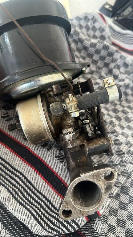

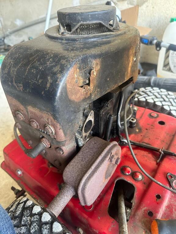

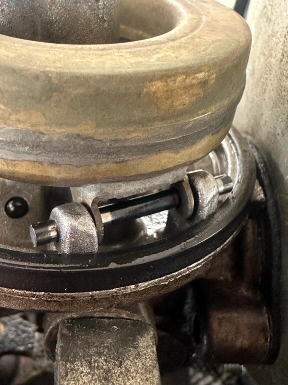

Jaron Snijckers 3 #1 Posted May 3, 2023 Hi Guys, My Name is Jaron, I start a project with an wheelhorce R26. I have some problems with the carburateur, Its leaking fuel because a little spring inside is missing. Who can help me to a drawing of exact type of carburateur to replace? Its a Lauson Power carburateur with numbers 132 and 25 in it. Stats: Wheelhorce R26 Model 3-2700 Serial 139337 Production Amnor N.V. Belgium Regards, Jaron Snijckers 1 Share this post Link to post Share on other sites
Jaron Snijckers 3 #2 Posted May 3, 2023 263 442 (also a number in the carburettor) 1 Share this post Link to post Share on other sites
ri702bill 13,316 #3 Posted May 3, 2023 (edited) Jaron - Welcome!! Are you referring to the little bent wire "clip" that goes in an undercut on the needle and the other end is "L" shaped to go over the tang on the float, similar to a Tecumseh carbureator?? If so, it is only there to "pull" the needle off the seat as the float drops. Not having it may not be a problem, as long as the needle seats squarely. By chance, is your brass float fuel-logged?? Take the pivot pin out, hold the float near your ear and shake it - there should be no sloshing sound..... A fuel logged one will not rise enough to seat the needle..... Does it looks like the clip on page 16 of the Carb ID pdf??? Bill Tecumseh_Basic_Troubleshooting_696533.zip Edited May 3, 2023 by ri702bill Share this post Link to post Share on other sites

Jaron Snijckers 3 #7 Posted May 4, 2023 Thanks for your help and answers! Were can I buy revision set for Carburettor or replacement part and whats the correct type? 1 Share this post Link to post Share on other sites
Jaron Snijckers 3 #8 Posted May 16, 2023 On 5/4/2023 at 12:01 PM, Jaron Snijckers said: Thanks for your help and answers! Were can I buy revision set for Carburettor or replacement part and whats the correct type? Anyone? Share this post Link to post Share on other sites
rmaynard 17,643 #9 Posted May 16, 2023 I think that a standard Tecumseh rebuild kit should have what you need. I'd check Amazon. Share this post Link to post Share on other sites
