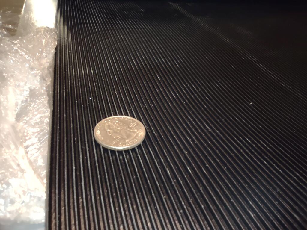

Achto 32,095 #5 Posted May 3, 2023 I purchased this do make the step treads on my 953. It does not have a self adhesive backing. My plan is to use 3M 90 spray adhesive to hold it in place. https://www.amazon.com/3M-Hi-Strength-Adhesive-INVERTED-aerosol/dp/B004M8SHWY/ref=asc_df_B004M8SHWY/?tag=hyprod-20&linkCode=df0&hvadid=193160157826&hvpos=&hvnetw=g&hvrand=13595388490160218910&hvpone=&hvptwo=&hvqmt=&hvdev=c&hvdvcmdl=&hvlocint=&hvlocphy=9019452&hvtargid=pla-310360843435&psc=1 Have plenty to cut out a few if any one would be interested. 2 Share this post Link to post Share on other sites
squonk 47,371 #6 Posted May 3, 2023 10 minutes ago, Achto said: I purchased this do make the step treads on my 953. It does not have a self adhesive backing. My plan is to use 3M 90 spray adhesive to hold it in place. https://www.amazon.com/3M-Hi-Strength-Adhesive-INVERTED-aerosol/dp/B004M8SHWY/ref=asc_df_B004M8SHWY/?tag=hyprod-20&linkCode=df0&hvadid=193160157826&hvpos=&hvnetw=g&hvrand=13595388490160218910&hvpone=&hvptwo=&hvqmt=&hvdev=c&hvdvcmdl=&hvlocint=&hvlocphy=9019452&hvtargid=pla-310360843435&psc=1 Have plenty to cut out a few if any one would be interested. If you don't want them to ever come off, use windshield urethane. 2 1 Share this post Link to post Share on other sites

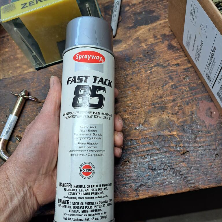

WHX?? 57,384 #12 Posted May 3, 2023 I have some spray adhesive @Achto. Used it for gluing stuff to ductwork. 1 Share this post Link to post Share on other sites

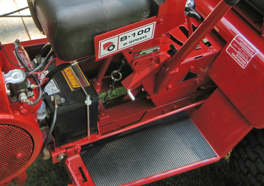

rmaynard 17,421 #13 Posted May 3, 2023 Rubber-Cal https://www.rubbercal.com/rubber-flooring/rubber-outdoor-flooring/corrugated-ramp-cleat-rubber-runners.html Also available on Amazon. This is what I use. Double-sided carpet tape works great to glue it down. This product is identical to the footrest mats on C-Series tractors of the 1970's 1 3 Share this post Link to post Share on other sites

WHX?? 57,384 #19 Posted May 3, 2023 If you didn't pull the trigger I'll bring you a can @Achto. Try it on a scrap piece see if it works. 1 Share this post Link to post Share on other sites

richmondred01 2,383 #23 Posted May 4, 2023 11 hours ago, rmaynard said: Rubber-Cal https://www.rubbercal.com/rubber-flooring/rubber-outdoor-flooring/corrugated-ramp-cleat-rubber-runners.html Also available on Amazon. This is what I use. Double-sided carpet tape works great to glue it down. This product is identical to the footrest mats on C-Series tractors of the 1970's They look nice. I’ll go that direction with the information that Eldon isn’t making them anymore 2 Share this post Link to post Share on other sites
