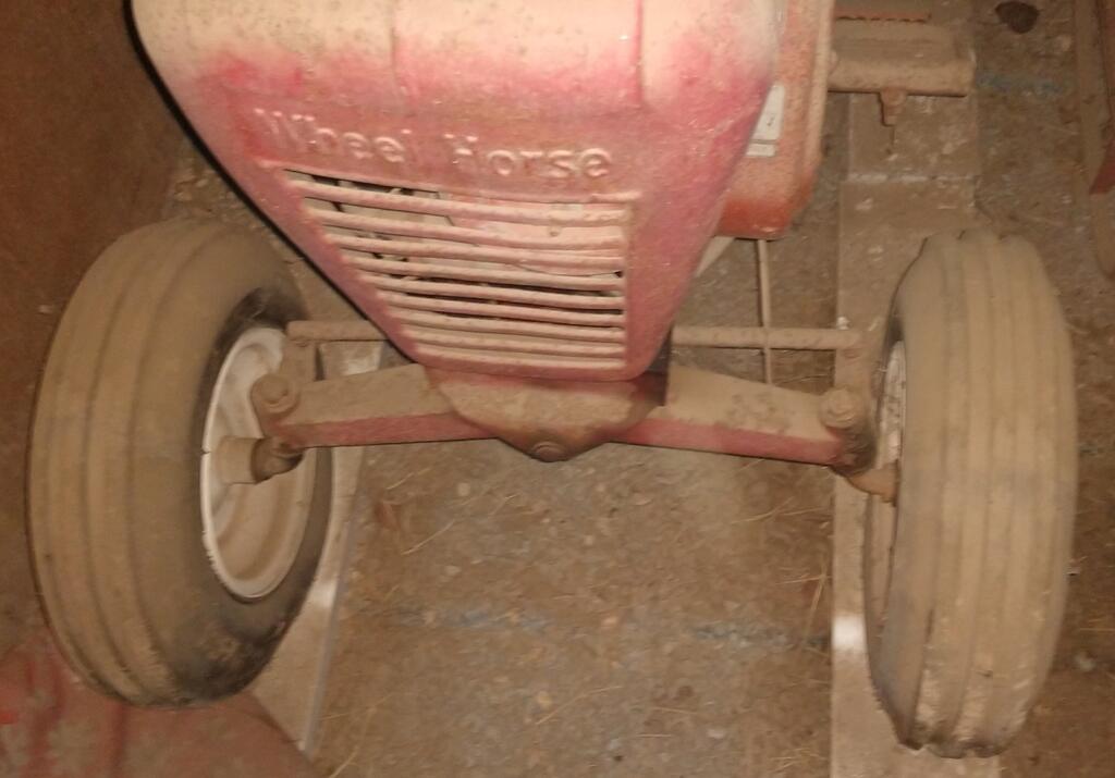

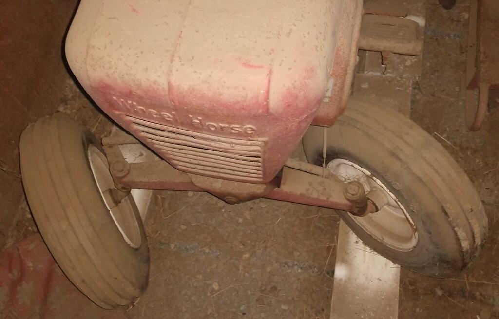

brians306 23 #1 Posted May 1, 2023 Does anyone have or can get pictures of a b and c series front axle side by side. I am wanting the front lower on my c160. Thanks 1 Share this post Link to post Share on other sites
Sparky-(Admin) 26,643 #2 Posted May 1, 2023 I’m gonna guess that the front axle in a C-100 and a B-100 are the same. 5 Share this post Link to post Share on other sites
kpinnc 19,042 #3 Posted May 2, 2023 (edited) 1 hour ago, brians306 said: I am wanting the front lower on my c160. How much lower are you going for? 6 inch wheels would drop it an inch. Any other difference between axles would be negligible. Most B and C axles are about the same. It's easier to go higher than it is to go lower. I have never measured it, but I put B/C knuckles on a Lawn Ranger axle. The difference in steering radius is crazy, but I'm not sure about height. Edited May 2, 2023 by kpinnc 1 Share this post Link to post Share on other sites

Pullstart 71,494 #7 Posted May 2, 2023 Yep, most folks run an 8” wheel spindle and a 6” wheel. It’s the most effective way to lower the front of a for pulling. 3 Share this post Link to post Share on other sites
