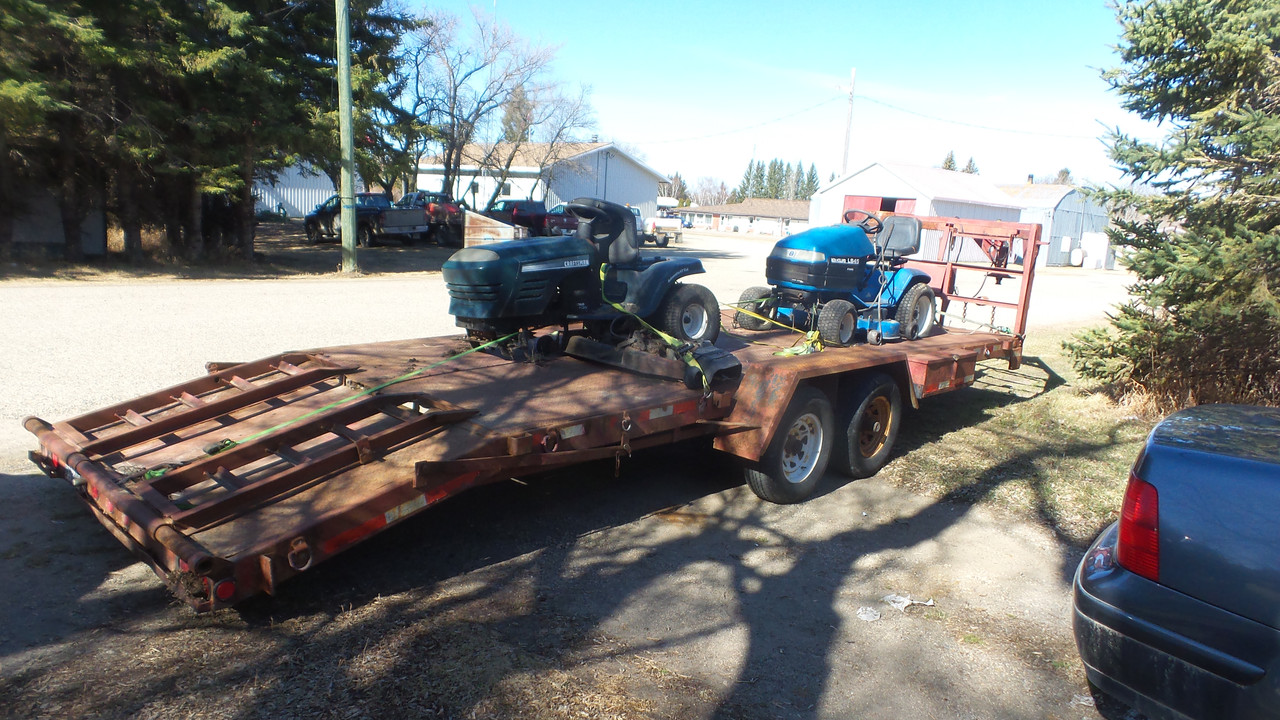

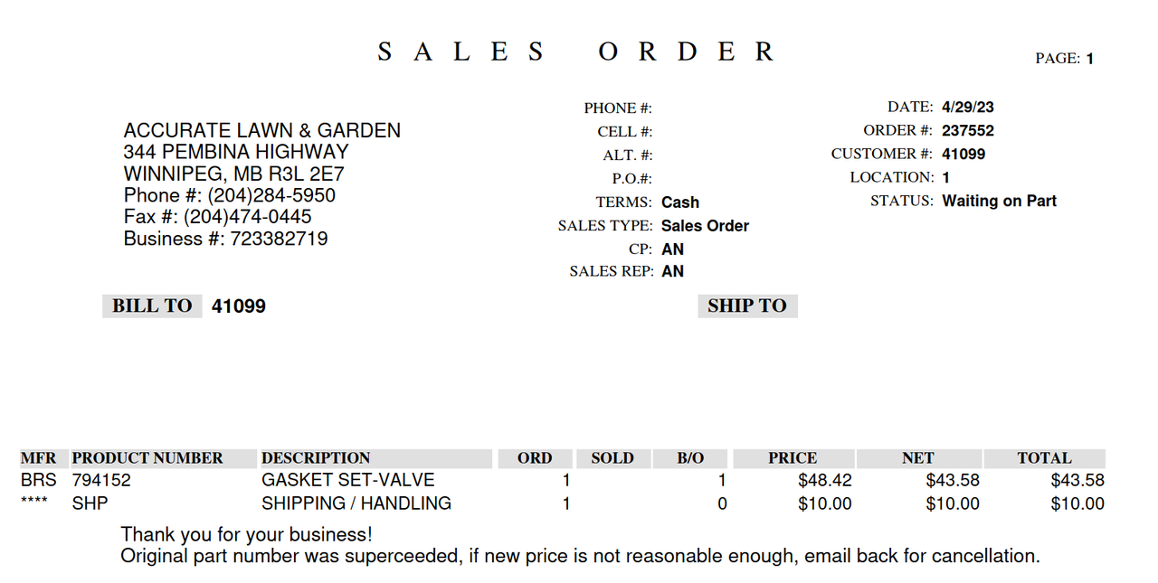

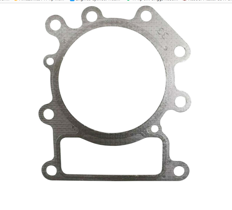

bc.gold 3,406 #1 Posted April 30, 2023 (edited) A couple of weeks ago I had purchased this Ariens Zero turn mower for $100.00 previous owner told me it uses more oil than gas. Doing some research I discover the head gasket is prone to failure, have not yet removed the cylinder head but have confidence in that this will be the issue.' Briggs and Stratton have since upgraded the design by adding web into the void where the push rods reside, my engine is first generation. New valve grind gasket set ordered. So far I have invested the purchase price, two new front tires and the gasket set for a total less than $200.00 Canadian. Installing the small front tires was a snap, held the rim in my vice then by pressing down and rotating the tire it slipped onto the rim without any great effort for the next one might soap the tire bead. Tire shop wanted $40.00 a tire to install. it's easy to see where and why the head gasket fails. Edited April 30, 2023 by bc.gold 2 Share this post Link to post Share on other sites

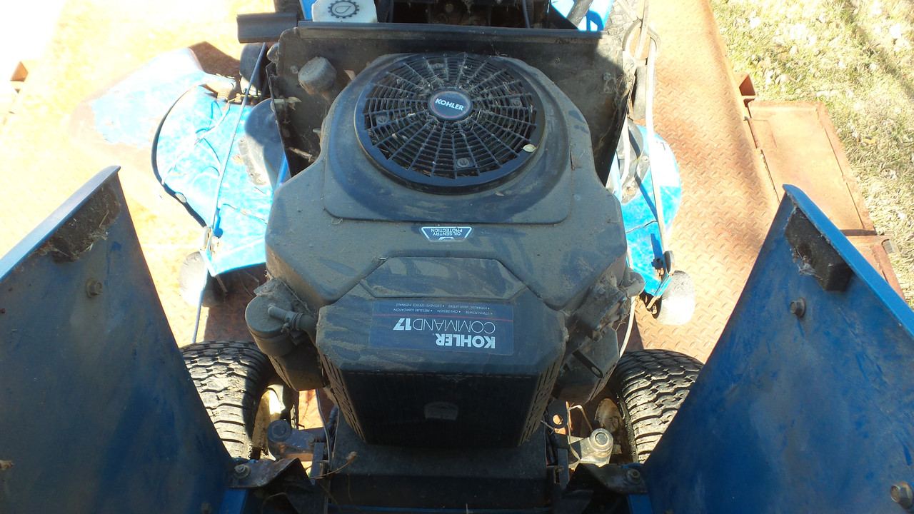

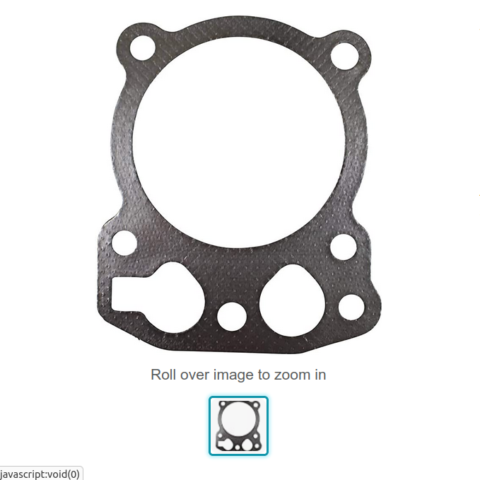

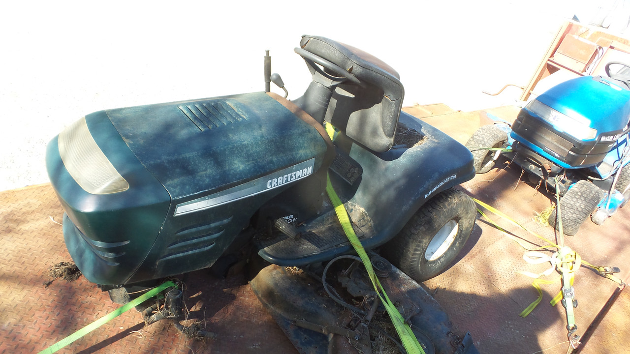

bc.gold 3,406 #2 Posted April 30, 2023 (edited) This afternoon bought another mower with a Kohler V-twin, owner said the deck was throwing the belt, also another mower with an 18 HP Briggs boxer engine but that one is waiting for acceptance on my offer. I love the Briggs Boxer engines they're dependable and have a unique sound to them. For comparison below the Kohler head gasket. Edited April 30, 2023 by bc.gold 1 Share this post Link to post Share on other sites

lynnmor 9,081 #10 Posted April 30, 2023 13 hours ago, bc.gold said: A couple of weeks ago I had purchased this Ariens Zero turn mower for $100.00 previous owner told me it uses more oil than gas. Doing some research I discover the head gasket is prone to failure, have not yet removed the cylinder head but have confidence in that this will be the issue.' Briggs and Stratton have since upgraded the design by adding web into the void where the push rods reside, my engine is first generation. New valve grind gasket set ordered. So far I have invested the purchase price, two new front tires and the gasket set for a total less than $200.00 Canadian. Installing the small front tires was a snap, held the rim in my vice then by pressing down and rotating the tire it slipped onto the rim without any great effort for the next one might soap the tire bead. Tire shop wanted $40.00 a tire to install. it's easy to see where and why the head gasket fails. I blew one of those head gaskets on a Briggs & Scrap iron, easy fix. It makes you wonder what they were thinking. Be sure to check the flatness of both the head and block, they can be way out. 1 Share this post Link to post Share on other sites
bc.gold 3,406 #11 Posted May 1, 2023 1 hour ago, lynnmor said: I blew one of those head gaskets on a Briggs & Scrap iron, easy fix. It makes you wonder what they were thinking. Be sure to check the flatness of both the head and block, they can be way out. It's a disusing peace of engineering designed to fail, if my offer on the Briggs boxer engine is accepted that engine goes into the Zero. Pat and I now have different postal codes she lives on the small acreage and has let most of the property go back to nature and mows a bit around the house as a fire break. I"m putting one of the mowers into an operable condition for her twice a year grass cutting. When I have the others home will give you guys a list of brands and models, this will be helpful in choosing the best mower for her. Share this post Link to post Share on other sites
bc.gold 3,406 #12 Posted May 2, 2023 The Kohler 17 Hp twin will replace the Intek currently residing in the Zero. I'm pulling the engines while the mowers remain on the trailer then Peter the Pastor who also has hardware disease owns the carcasses. Share this post Link to post Share on other sites
bc.gold 3,406 #13 Posted May 18, 2023 Appears Briggs has been orphaned by the manufacture, been waiting almost a month on that head gasket. Later today I'll check on parts availability for Kohler, if the 17 hp is more commonly used then I'll swap it in a scrap the Briggs. Share this post Link to post Share on other sites
ebinmaine 81,290 #14 Posted May 18, 2023 6 minutes ago, bc.gold said: Appears Briggs has been orphaned by the manufacture That may or may not be the fault of the manufacturer. My favorite place to go get small engine parts has extremely limited access to some things and amazing prices on others. It's all about the DISTRIBUTORS that he uses. Situations like yours is one of the reasons why I've gone over more and more and more to online ordering. 1 Share this post Link to post Share on other sites
