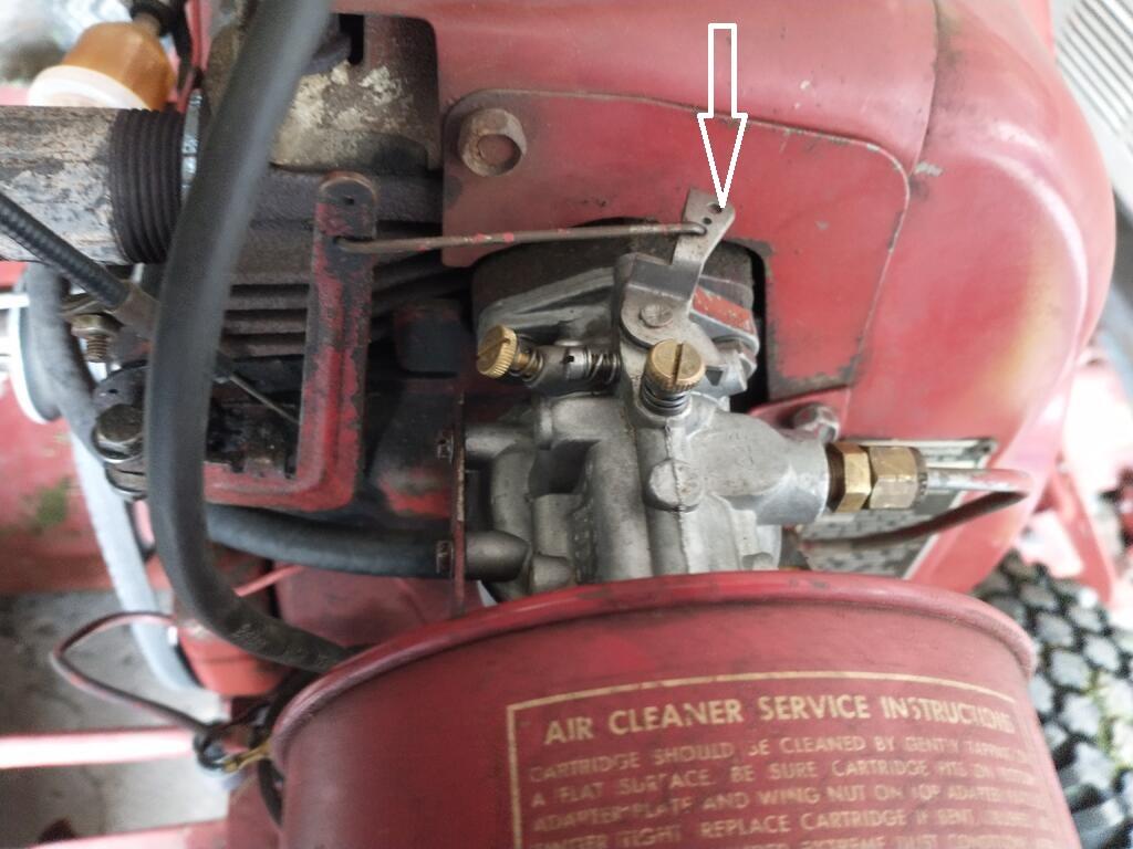

wallfish 20,733 #10 Posted April 28, 2023 Move to here for more throttle control. That closest hole makes it react fast with slighter movement of the knob 2 Share this post Link to post Share on other sites

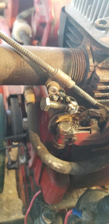

Racinbob 13,286 #14 Posted May 20, 2023 I also didn't like the extremely short throw from idle to full on my 854. I couldn't find a combination that really helped so I did this. Right or wrong it works. 1 2 Share this post Link to post Share on other sites
Handy Don 17,681 #15 Posted May 22, 2023 On 5/20/2023 at 1:48 PM, Racinbob said: I also didn't like the extremely short throw from idle to full on my 854. I couldn't find a combination that really helped so I did this. Right or wrong it works. Interesting adaptation. I’ve been comfortable with the throw on my 854. Now I’m going to have to go look at it more closely to see what’s happening. Share this post Link to post Share on other sites
Racinbob 13,286 #16 Posted May 22, 2023 Let us know if you find something. This ended up being the best solution I could figure out. Share this post Link to post Share on other sites

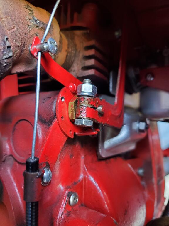

gt14rider 1,283 #17 Posted May 26, 2023 This works for me. Set high rpm 1 Share this post Link to post Share on other sites
