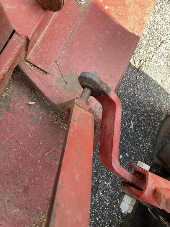

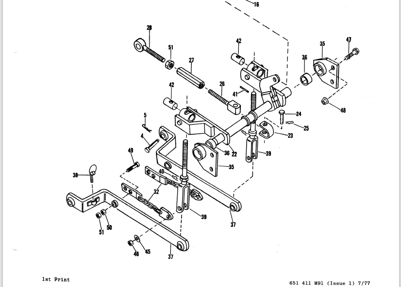

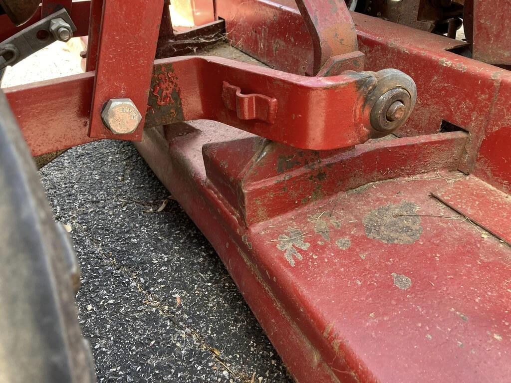

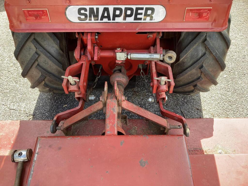

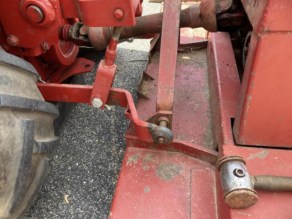

"Manic-Mechanic" 1,485 #1 Posted April 27, 2023 (edited) I have been in search of alternative lower lift links for this cat 0 3pt. The Wheel Horse Finish Mower is an implement that I do want to be able an run on this tractor. I have found a source for the Wheel Horse Lower Lift Link Assembly 104673 Even tho' the parts drawing shows these ball ends as pictured, seems as though they were repaired Goes to show, all cat 0 may not be interchangeable from factory I just can't understand why this is? Proprietary.. So close! Left I thought at first these 5/8th's Ball Ends must have been replaced, however, then I glanced at the Snapper parts manual Not modifying the Finish Mower, that's for sure! The Wheel Horse Links will solve this... Edited April 27, 2023 by "Manic-Mechanic" 1 Share this post Link to post Share on other sites
oliver2-44 11,632 #2 Posted April 27, 2023 How/why don’t the arms pictured work. I’m not familiar with the snappers but some original arms just had holes in them. I could see where someone would want to weld ball ends on them. 1 Share this post Link to post Share on other sites
"Manic-Mechanic" 1,485 #3 Posted April 27, 2023 (edited) 19 minutes ago, oliver2-44 said: How/why don’t the arms pictured work. I’m not familiar with the snappers but some original arms just had holes in them. I could see where someone would want to weld ball ends on them. They hit the the weldment preventing the pins to seat in the ball end. The Snapper parts drawing above does depict the ball end. I have researched that and these are factory.The lift links on Cub Cadet Super Cub and John Deere 318 Cat 0 are also very short at the ball. The Wheel Horse finish Mower may be proprietary? The Rototiller is not a problem tho'. Edited April 27, 2023 by "Manic-Mechanic" Share this post Link to post Share on other sites
