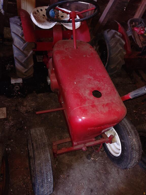

ML3 2,571 #1 Posted April 26, 2023 Found a 1960 Suburban. Original motor turns & has compression, missing carb, air filter, & some ignition items too. He supposedly has the fuel tank. Needs parts for steering also. Paint/bodywork was done a while ago- it probably will buff up decent. Tires are new in front & rears look good. Transmission seems free & it will easily go into gears. It's buried in an old filthy garage surrounded by Bolens tractors. It appears like a lot of little things might be missing. Said he had a box of parts but the garage was such a disaster doubt he would find it. He said to make him an offer, he did say he wasn't giving it away though. I was gonna maybe try to hit him @$300??? He also has 1959 Suburban drop axle but it's a lot rougher. It's basically a roller. I really thought bout if I got it putting a Predator 212 in it to get it up & running while I hunt down & repair/restore original motor. Anyone had experience putting a 212 or any other Predator in a Suburban? I have a built up 212 in a minibike & it works great. 4 Share this post Link to post Share on other sites

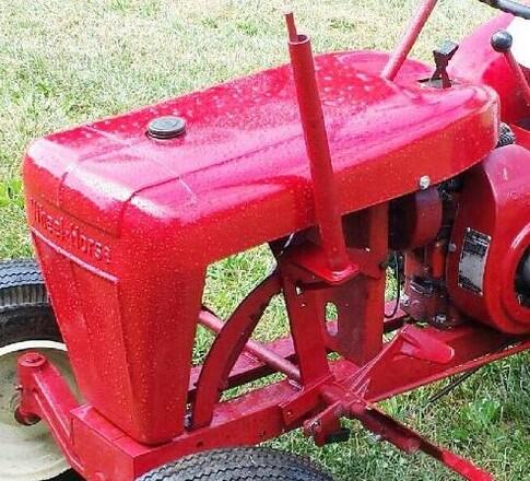

kpinnc 19,109 #2 Posted April 26, 2023 (edited) Looks more like an RJ than a Suburban. Rear fenders were an option on all of them. RJs ended in 1959. I thought all mid engine Suburbans (only made 1960 and 61) had drop axles and a different hood? Like the pic below? Feel free to correct me if I'm wrong. I've owned both a RJ-59 and a 551 Suburban, though both left a long time ago. That was the extent of my "burner" tractors. Edited April 26, 2023 by kpinnc 3 Share this post Link to post Share on other sites
ML3 2,571 #3 Posted April 26, 2023 I don't know. I'm going by what the guy selling it told me. I kinda thought it was a RJ. Share this post Link to post Share on other sites
wallfish 20,744 #4 Posted April 26, 2023 (edited) That's a RJ-58. Looks like it still has the Kohler K91. Typically not very difficult to get those running. Missing exhaust shield Belt guard Throttle control Gas tank Recoil starter Edited April 26, 2023 by wallfish 2 Share this post Link to post Share on other sites

ML3 2,571 #6 Posted April 26, 2023 5 minutes ago, wallfish said: That's a RJ-58. Looks like it still has the Kohler K91. Typically not very difficult to get those running. Missing exhaust shield Belt guard Throttle control Gas tank Recoil starter Kinda thought it was aRJ. It's also missing steering gear. He says he has it. 🤞 The items you mentioned it's missing are they relatively easy to obtain? Share this post Link to post Share on other sites
wallfish 20,744 #7 Posted April 26, 2023 There isn't a steering gear on the RJs. It's kinda direct drive and they steer FAST. 1/4 turn of the wheel lock to lock All of those parts can be had but they're also the most common parts missing. Someone was repopping heat shields and belt guards so they come up on epay every once in a while Maybe that's a suburban sitting right next to it too. Grab them all !!!!! 1 1 Share this post Link to post Share on other sites

ML3 2,571 #9 Posted April 26, 2023 Just now, wallfish said: Mine looks like a bomb went off too but I can typically find everything. Get whatever parts you can. Especially the belt guard if he has it. I know there's no belt guard unfortunately. Like I originally said I may just put a Predator in it for now if it can be done relatively easy & w/o hacking up body/frame etc. Maybe over next winter I'll get the Kohler all rebuilt. Needs a carb cause it's missing. Share this post Link to post Share on other sites
wallfish 20,744 #10 Posted April 26, 2023 You will need to make some belt "fingers" out of wire to simulate the belt guard no matter what engine it is so the gears don't grind. Once you get that far post some pics and we can help you make those fingers to guide the belt. It's fairly easy to do 1 Share this post Link to post Share on other sites
ML3 2,571 #11 Posted April 26, 2023 8 minutes ago, wallfish said: You will need to make some belt "fingers" out of wire to simulate the belt guard no matter what engine it is so the gears don't grind. Once you get that far post some pics and we can help you make those fingers to guide the belt. It's fairly easy to do Good info bout belt fingers. Assume that's to keep belt from jumping around causing gears to grind???? Idk how soon I'll get to working on it, if I get it. What's a fair offer? I was thinking $300? As much as I'd like to get the other one I don't have room or time for another project. Also I promised my girlfriend id finish her she shed that we had built in Nov. She told me that after her shed is finished I could buy as many tractors as I wanted. 1 Share this post Link to post Share on other sites
wallfish 20,744 #12 Posted April 26, 2023 1 minute ago, ML3 said: She told me that after her shed is finished I could buy as many tractors as I wanted. ALWAYS better to beg for forgiveness than to ask permission !!!!!! The wire fingers guide and support the belt around the engine pulley to allow it to slip and not spin the trans. If the trans pulley is spinning then the gears will grind when shifting 1 Share this post Link to post Share on other sites

kpinnc 19,109 #16 Posted April 26, 2023 1 hour ago, ML3 said: Needs a carb cause it's missing. They're still out there. K91s are as bulletproof as a K161/181. I gave 3 of them to the guy who bought my RJ, and the one on the tractor was running. Belt guard will be the hard part I would think. Share this post Link to post Share on other sites
953 nut 70,665 #17 Posted April 26, 2023 1 hour ago, ML3 said: definitely have to figure out the wire fingers. A good cheap source of material to make the fingers from can be found at any shop that installs or repairs chain link fence. It is the heavy wire they use tgo stiffen the bottom of the fence so dogs/kids can't push the fence in and get under it. Share this post Link to post Share on other sites

oliver2-44 11,850 #21 Posted April 27, 2023 (edited) The correct RJ gas tanks are also getting harder to find. When (not if) you go get it leave him your phone number in case he finds that box of parts Get both tractors to make one Edited April 27, 2023 by oliver2-44 Share this post Link to post Share on other sites
