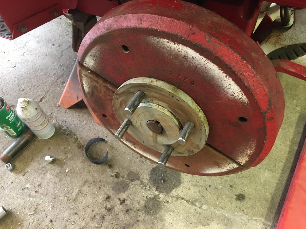

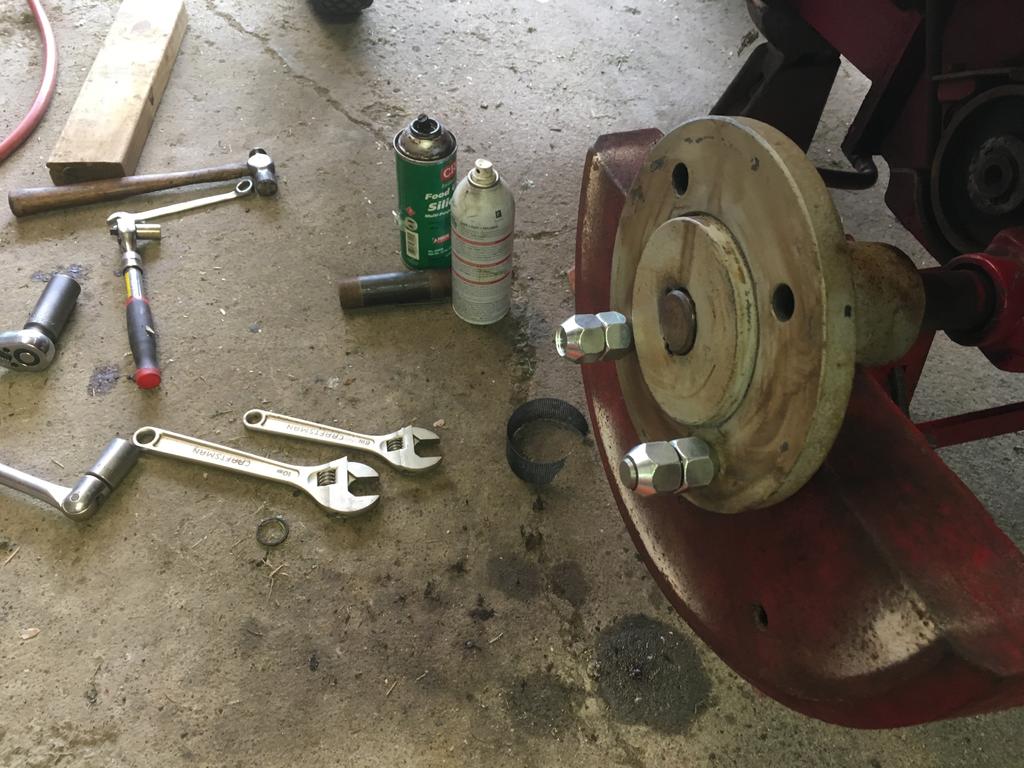

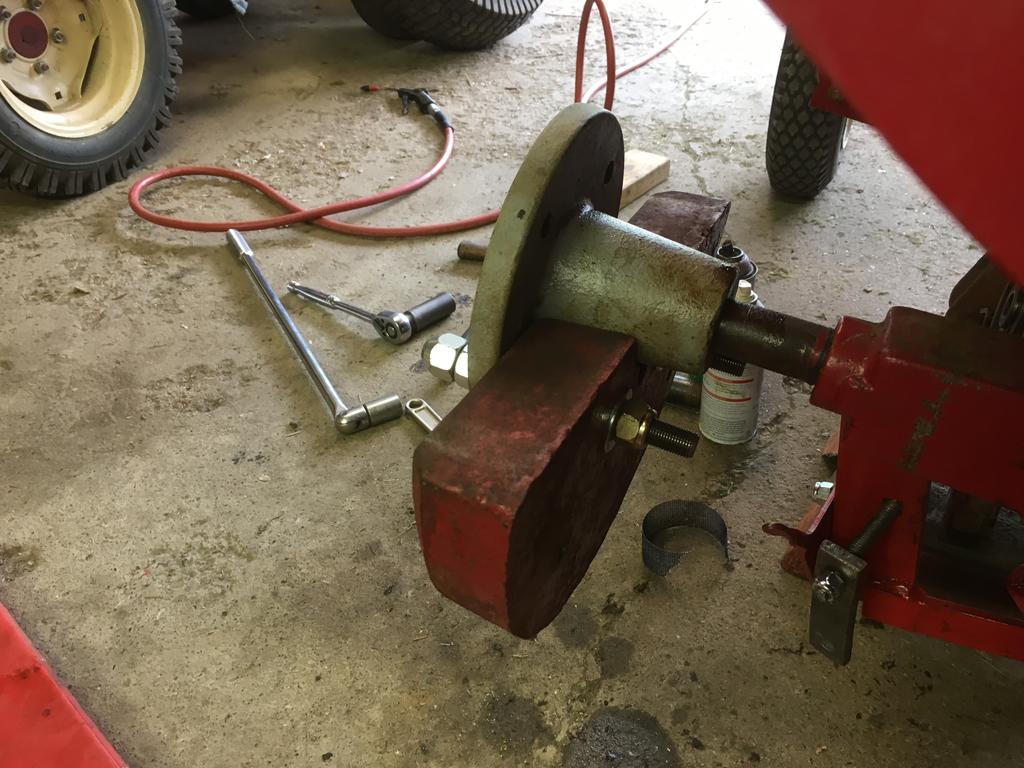

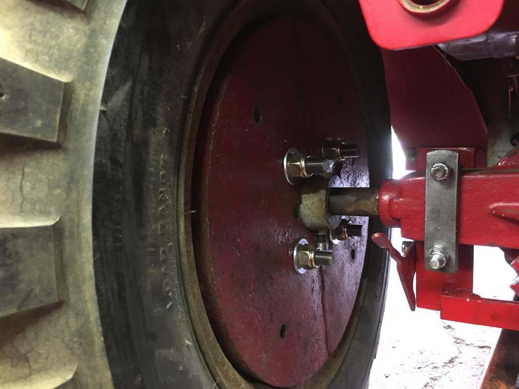

Pullstart 70,694 #2 Posted April 26, 2023 The weights you’re looking for are WW-93. Here is a link to a set I sold a while back. I’ve had two sets come through my stables, but I prefer doing a 5 lug hub swap and 12” wheels on my big wheel workers (and show machines alike). It allows me a 27x7.50 or 10 - 12 tire that I can fluid fill for even more weight. Share this post Link to post Share on other sites
Pullstart 70,694 #3 Posted April 26, 2023 Here is a link explaining how I mounted them, and with what materials.. https://www.wheelhorseforum.com/topic/86406-introducing-“rebel”-the-953/?page=4&tab=comments#comment-909689 Share this post Link to post Share on other sites
Dave 1953 70 #4 Posted April 26, 2023 Thank you so much for the pics and info. At least it gives me something to go on. Please contact me if you see another set. 2 Share this post Link to post Share on other sites

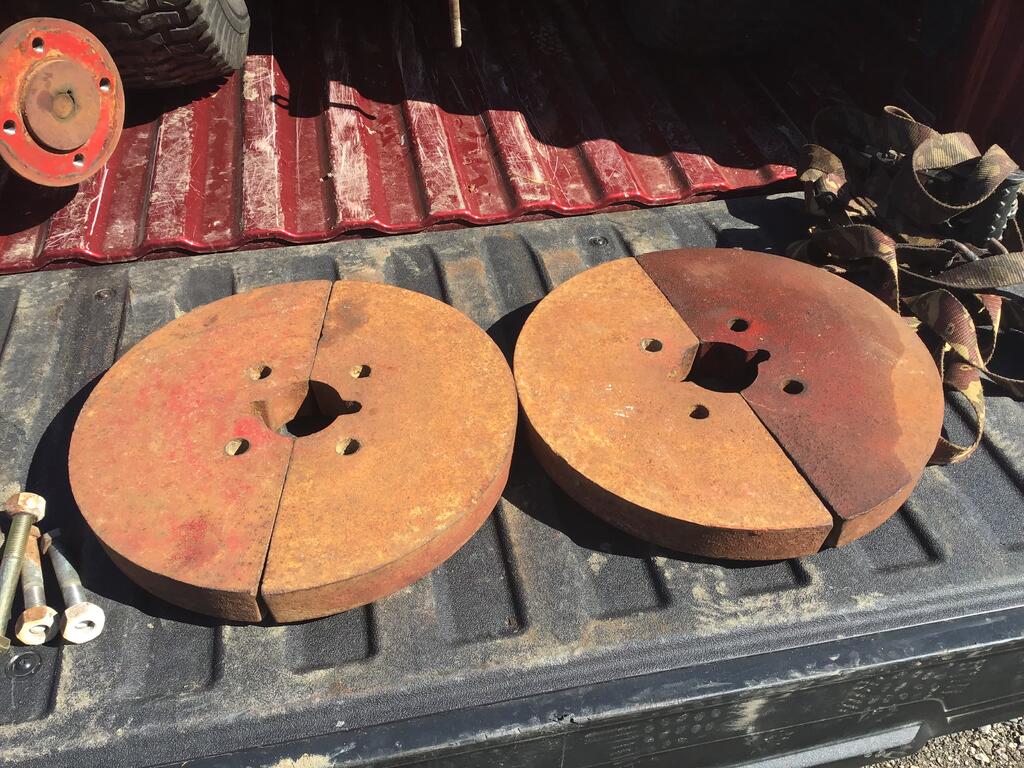

Pullstart 70,694 #5 Posted April 27, 2023 Another picture I found tonight… 3 Share this post Link to post Share on other sites
Dave 1953 70 #6 Posted April 27, 2023 1 hour ago, Pullstart said: Another picture I found tonight… Are these the inside or outside ones? Share this post Link to post Share on other sites
19richie66 17,930 #7 Posted April 27, 2023 6 hours ago, Dave 1953 said: Are these the inside or outside ones? Inside. Outside weights for these are like unicorns and pots of gold. They are one piece. Pictures of the outside weights are as rare as a clear picture of Bigfoot. 😁 1 1 Share this post Link to post Share on other sites

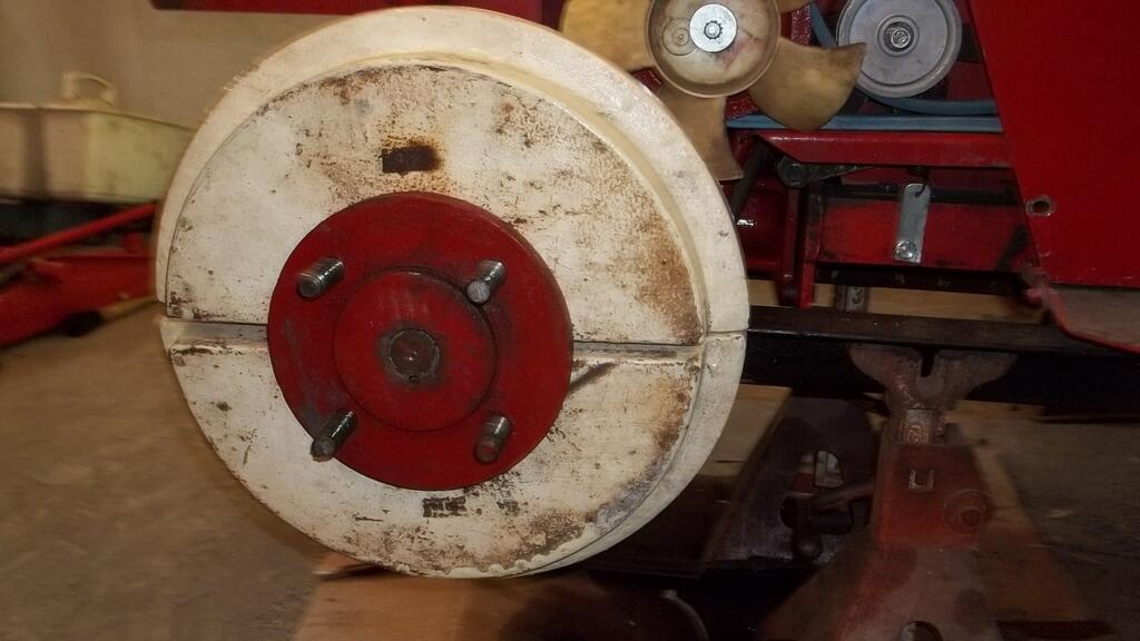

pfrederi 20,869 #13 Posted April 28, 2023 From the thread shown above Share this post Link to post Share on other sites
