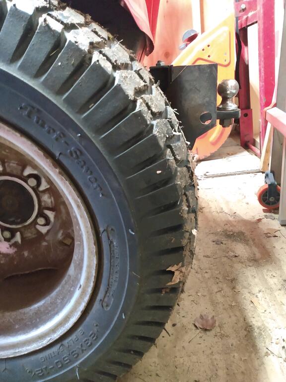

CCW 1,519 #4 Posted April 24, 2023 (edited) @tallen4392 I put these 23x9.5 12 tires on my 312-8 last year and they work fine with my 36 inch RD deck. Edited April 24, 2023 by CCW 1 Share this post Link to post Share on other sites
