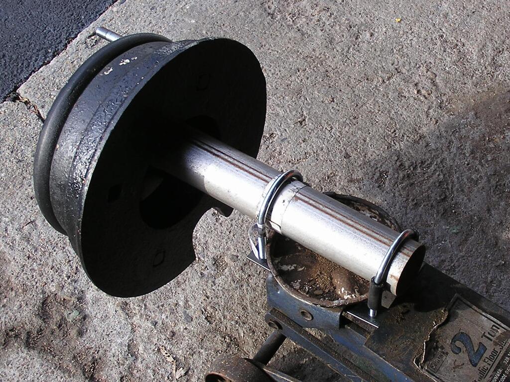

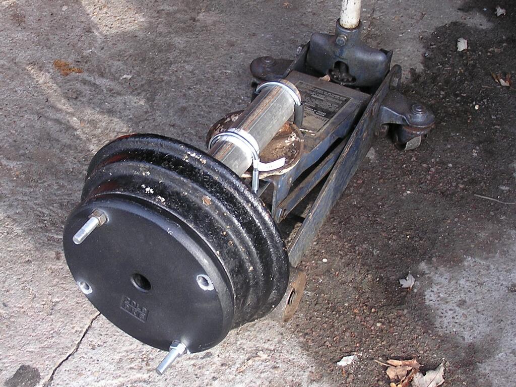

ri702bill 11,417 #3 Posted April 23, 2023 (edited) Be careful what you wish for. One plastic weight is somewhat of an overhung load - 2 stacked together is an excessive overhung load. can lead to axle bearing and hub problems. Two possible "better" solutions - Tube the tires and add winter windshield washer fluid - a 23x8.50x12 tire holds about 6 gallons - about 40 pounds INLINE with the rim. Use a thinner cast iron wheel weight on the inside of the rim and your plastic weight on the outside - adds about 30 pounds and helps negate the overhang of the plastic weight. Or, be a hero and do ALL THREE - fluid, inner weight, outer weight - The Traction Tri-fecta !! My winter setup on the C81 - washer fluid filled tires, 75 pound cast wheel weight with another 20 pound weight bolted inside - 95 pounds total. A bear to load alone - made this adapter for the floorjack to help. Bill Edited April 23, 2023 by ri702bill 1 Share this post Link to post Share on other sites
JCM 10,790 #4 Posted April 23, 2023 @ri702bill Looks like a Sears 2 ton floor jack from the late 70's. Still use mine on a regular basis. 2 Share this post Link to post Share on other sites
squonk 45,627 #5 Posted April 23, 2023 28 minutes ago, JCM said: @ri702bill Looks like a Sears 2 ton floor jack from the late 70's. Still use mine on a regular basis. I still have my Craftsman jack bought around '76. Still have yet to add fluid! 1 Share this post Link to post Share on other sites

ri702bill 11,417 #8 Posted April 23, 2023 It is!! Bought it in 1981 and it has the rebuildable pump (did that a few years back), unlike my later 3 ton Sears.... 1 Share this post Link to post Share on other sites
