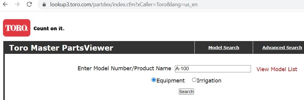

daveoman1966 3,884 #10 Posted April 22, 2023 I commend you on getting kids involved with hands-on mechanical stuff.... Good For You. This is the TORO Master Parts Viewer website. In the blank space, just type in A-100 and clik SEARCH. You will find virtually everything about that A-100 tractor (lawn mower). There is another model... A-90... which is very similar and many parts will swap over. Note: TORO bought out Wheelhorse in the mid 1980s. https://lookup3.toro.com/partdex/index.cfm?xCaller=Toro&lang=us_en 2 1 Share this post Link to post Share on other sites

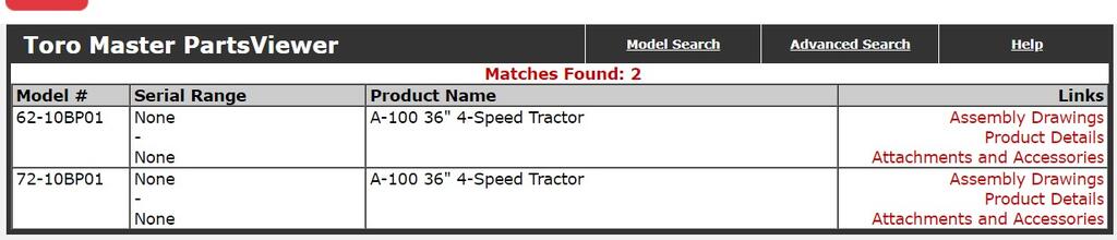

daveoman1966 3,884 #13 Posted April 22, 2023 4 hours ago, Lee1977 said: It's either a 1976 Model No.(62-10BP02) A-100 Briggs 251707-0601 Peerless 648. Or a 1977 Model No (72-10BP01) A-100 Briggs 251707-0106 Peerless 662. Use the Model No. when searching. I couldn't find anything using A-100. In the TORO MPV, type in the model as A-100. Then--- (don't hit the ENTER key) --- clik the word box SEARCH just under where you entered A-100... Here are the next 2 screens: 1 Share this post Link to post Share on other sites
