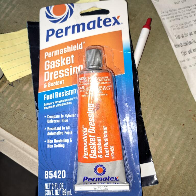

WHX?? 58,347 #13 Posted April 19, 2023 (edited) 58 minutes ago, rmaynard said: I put a Chinese carb on my B-100 (K241). It worked like a champ. Just like an OEM carburetor. purchased a Chinese replacement carb for the K161. It was delivered next day. Here is what was wrong with it: Same here seems like the luck of the draw. Ordered a carb for the cement saw and it was junk. Let the flea bayer know and promplty refunded me. Didn't even want it back... makes me think the seller knows it junk. Try this on that bowl nut gasket Bob. Also works for holding the bowl seal & baffle in when the carb is mounted on the motor & you can get the bowl on. Edited April 19, 2023 by WHX?? 3 2 Share this post Link to post Share on other sites

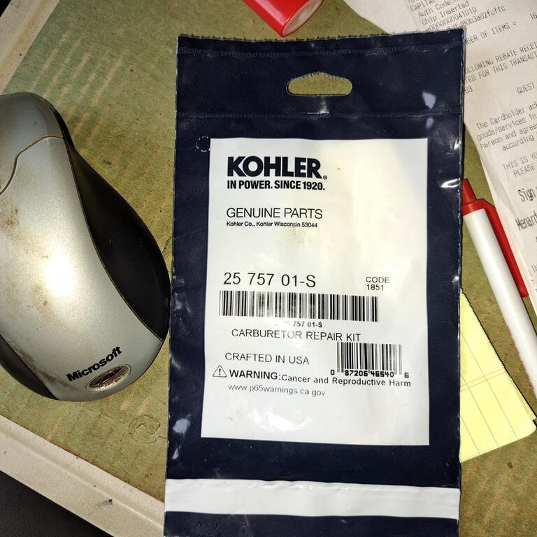

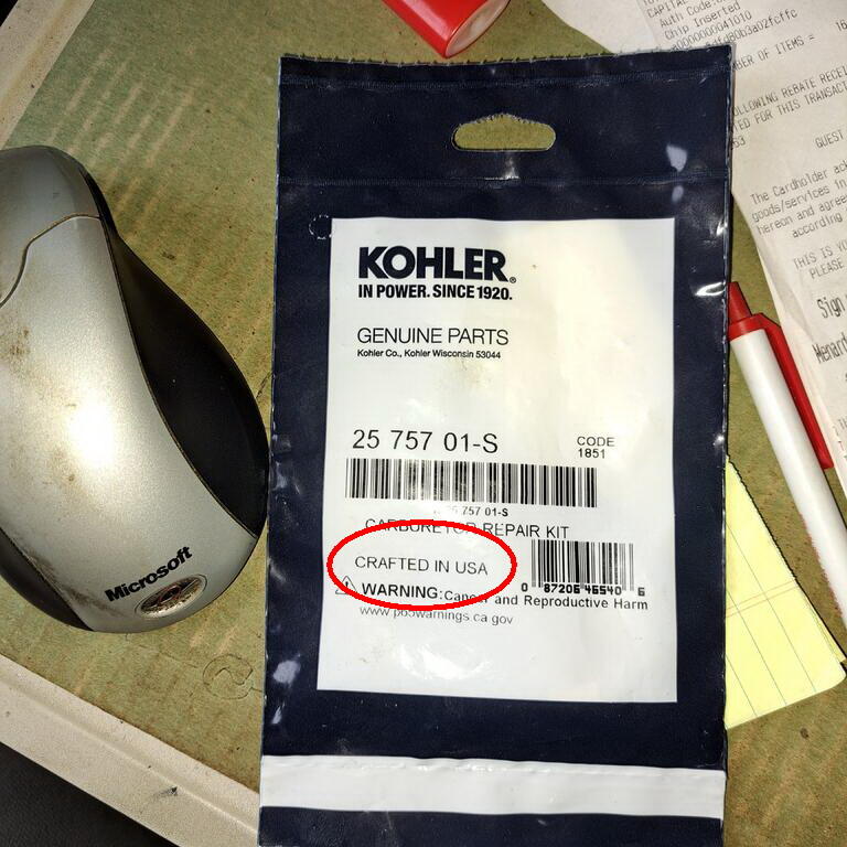

rmaynard 17,642 #16 Posted April 19, 2023 So far, the pipe thread sealant has been holding. Time will tell. Now, about this. What exactly does "crafted in USA" mean? I'm guessing that it doesn't mean MADE IN THE USA. 2 Share this post Link to post Share on other sites
SylvanLakeWH 32,823 #17 Posted April 19, 2023 16 minutes ago, rmaynard said: What exactly does "crafted in USA" mean? I'm guessing that it doesn't mean MADE IN THE USA. It most likely means "the packaging sticker on this bag, which contains part(s) made and assembled in a country other than the USA, was crafted and placed on this bag in the USA by part time workers with no benefits." 1 1 Share this post Link to post Share on other sites

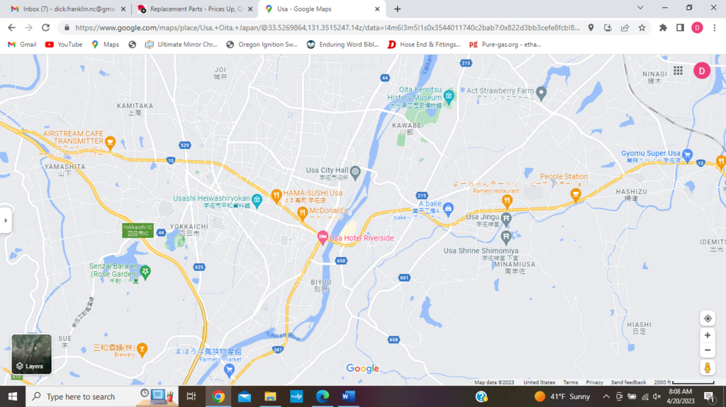

953 nut 70,325 #22 Posted April 20, 2023 Here is a little Blast from the Past. The Japanese City of Usa became a manufacturing hub in the late '70 and early '80 tim period and all of their products said "Made in USA" 1 7 Share this post Link to post Share on other sites

SylvanLakeWH 32,823 #25 Posted April 20, 2023 1 hour ago, 953 nut said: Here is a little Blast from the Past. The Japanese City of Usa became a manufacturing hub in the late '70 and early '80 time period and all of their products said "Made in USA" "Truth" in Advertising... Share this post Link to post Share on other sites
