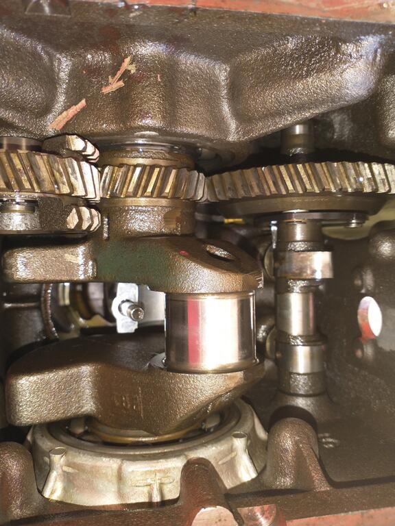

squonk 46,014 #4 Posted April 18, 2023 Rotella 30W all year. Made a very dirty engine look like this. 2 2 Share this post Link to post Share on other sites
hotajax 248 #5 Posted April 18, 2023 22 minutes ago, squonk said: Rotella 30W all year. Made a very dirty engine look like this. Pretty slick. What is your run time hours between changes? Share this post Link to post Share on other sites

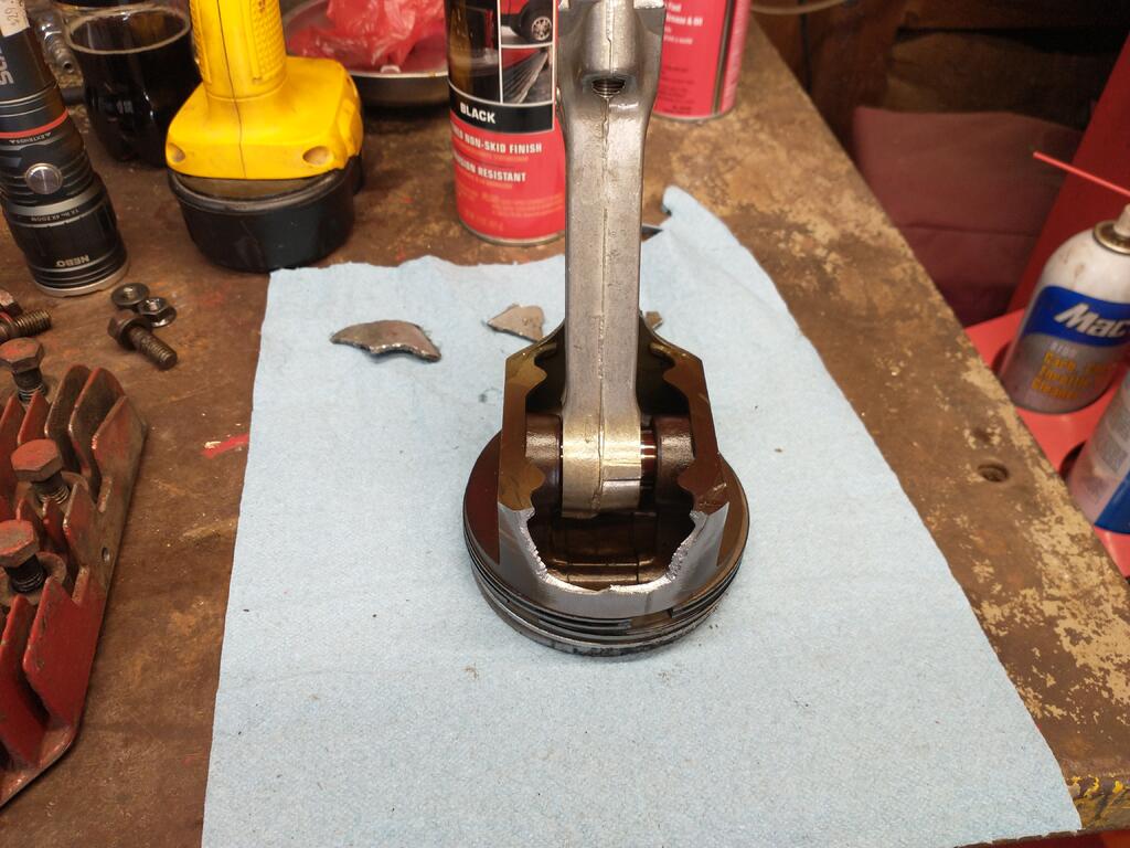

squonk 46,014 #6 Posted April 18, 2023 (edited) 4 minutes ago, hotajax said: Pretty slick. What is your run time hours between changes? About 20 hours. This engine had 995 hours on it when a piston cracked Edited April 18, 2023 by squonk 2 Share this post Link to post Share on other sites

squonk 46,014 #8 Posted April 18, 2023 I got my tractor with about 700 hours on it and it smoked like a chimney. Wasn't maintained at all. I noticed a noise in it at the 995 mark and swapped it out with another engine. I expected to find loose balance gears but when the pan came off the piston pieces were in it. I have no idea when the piston broke. Might have been broken when I got it! 3 2 Share this post Link to post Share on other sites
