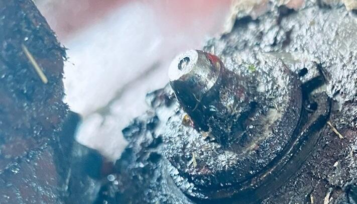

656_tractor 14 #1 Posted April 16, 2023 Hi all, Does anyone know the size of the zerk fittings that went here? Mine are gone since the mower deck repair... Share this post Link to post Share on other sites
ri702bill 12,169 #2 Posted April 16, 2023 Those should be 1/4-28 UNF thread...... Bill 1 Share this post Link to post Share on other sites
656_tractor 14 #3 Posted April 16, 2023 (edited) Thanks sir! Got them and they worked. You know.. I just had those thin bearings replaced end of season last year... And I am not sure the dude put any significant grease in those bec it took a whole 3 or 4 pumps.. I felt like my last mow there was a bit of vibration in the deck right at the end.. slight but you know - you can tell if you have an ear for it.. I shut it off before hopefully any damage.. Popped off the covers and there were no fittings (above was old pic) .. Now that I filled them with grease I sure hope they will be ok.. Edited April 16, 2023 by 656_tractor Share this post Link to post Share on other sites
squonk 46,657 #4 Posted April 17, 2023 Those cross bearings are staked into the stations. Make sure they didn't come loose Share this post Link to post Share on other sites
