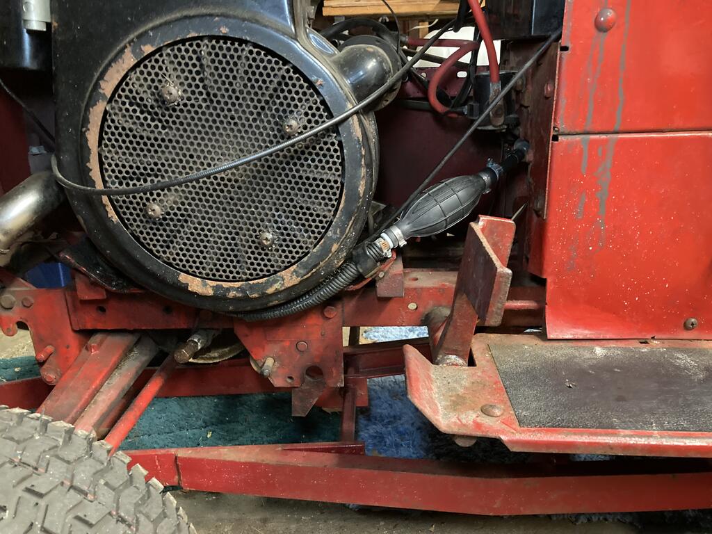

Ed Kennell 47,814 #2 Posted April 16, 2023 Install a marine primer bulb at a low spot in the fuel line for instant starts. 2 Share this post Link to post Share on other sites
SylvanLakeWH 32,823 #3 Posted April 16, 2023 Works like a charm... Here's mine. Share this post Link to post Share on other sites
