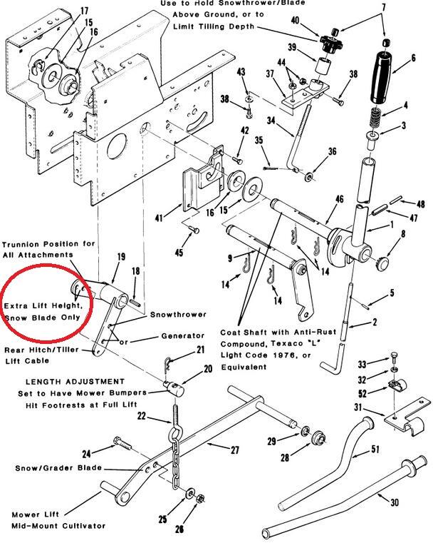

Geoff Cornwall 75 #1 Posted April 14, 2023 Hi all , i have managed to get hold of a c161 , it requires some work , but i have had it running and driving , i also have got a plough that i intend to attach to it . I will need to fit a rockshaft kit but i cant see any holes to fit one . Can anyone tell me where the holes should be ? I have sent an email to wheel horse parts and more regarding a new kit for it . And i am probably jumping the gun because it needs a rewire , some axle seals , fluid change , and im sure i will find a host of other things . I will try to take some pics and post up over the weekend , thanks for and info you can give . Geoff . 3 Share this post Link to post Share on other sites
953 nut 70,666 #2 Posted April 14, 2023 There should be a rock shaft attached to the lift arm if a manual lift or the hydraulic cylinder if it is a hydraulic lift. 1 Share this post Link to post Share on other sites
gwest_ca-(File Mod) 12,557 #3 Posted April 14, 2023 Perhaps the rock shaft under the seat? 1 Share this post Link to post Share on other sites

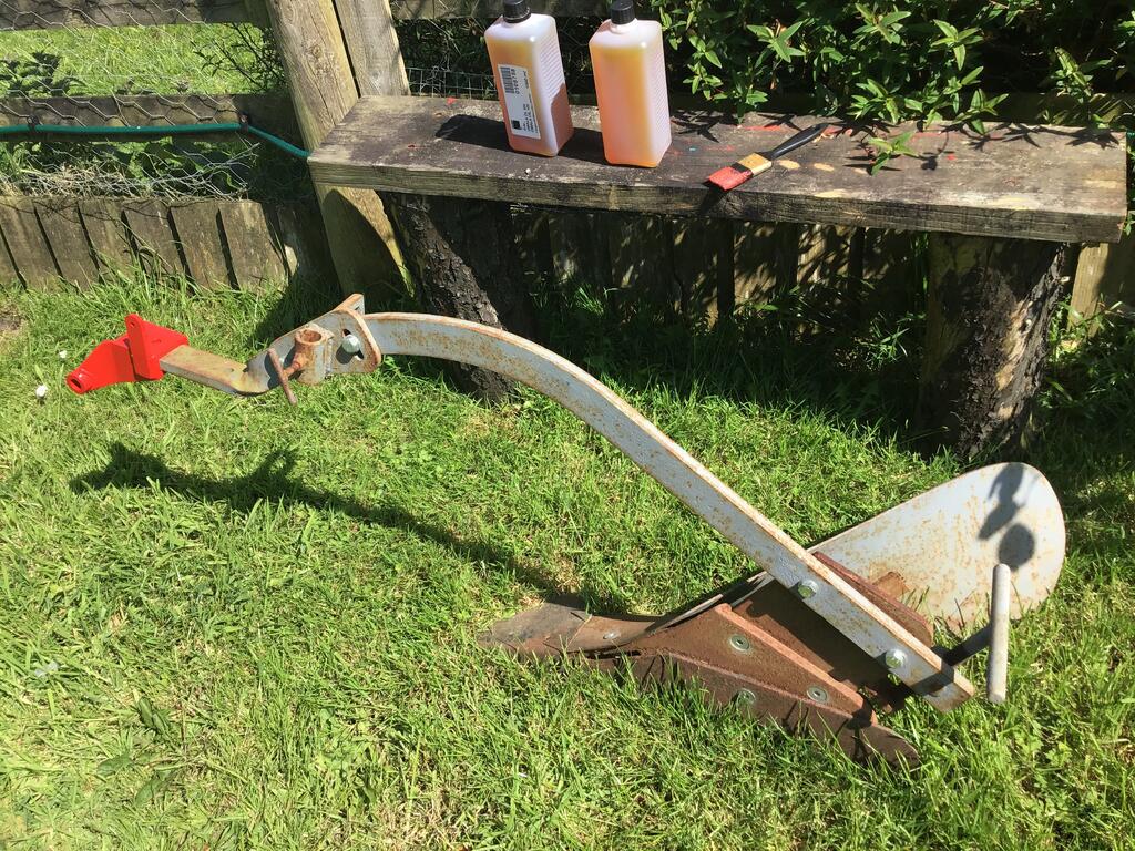

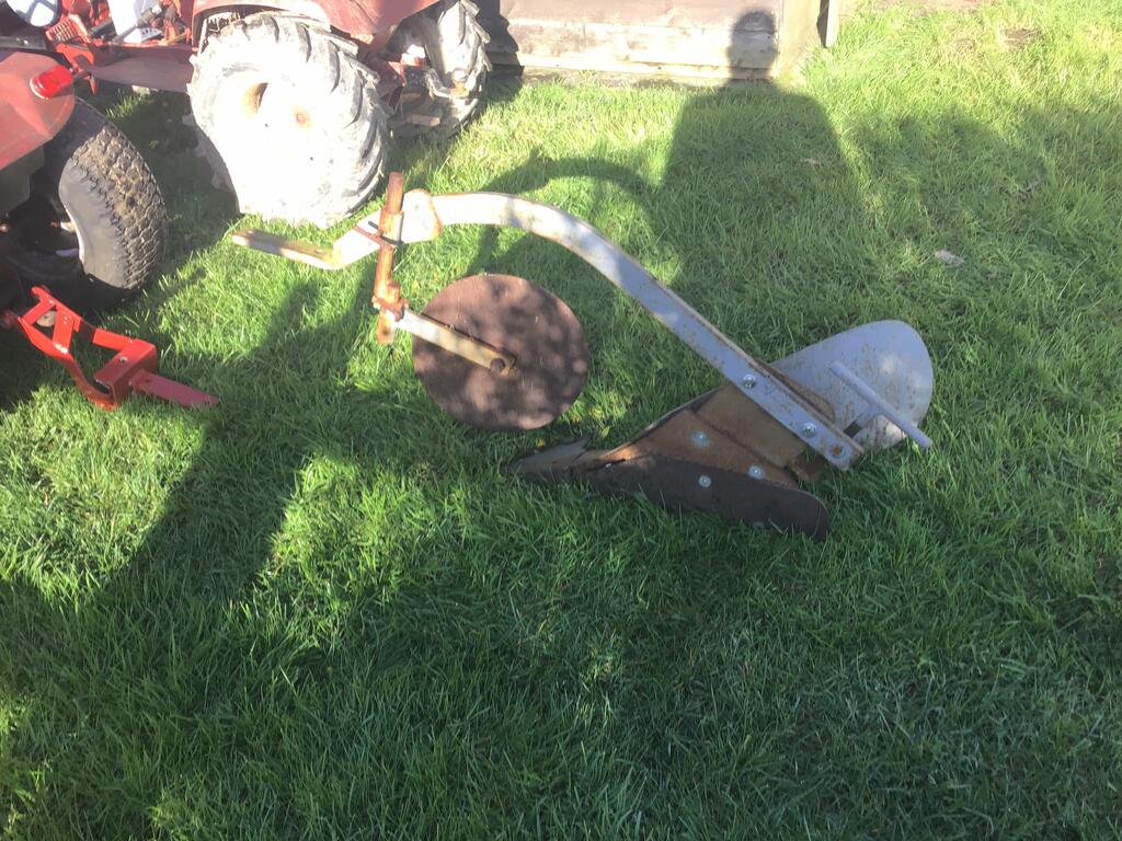

Stormin 9,988 #7 Posted April 15, 2023 to Geoff. Bit far off to be of much help, but that plough fits a slot hitch. Any idea what it's off? Share this post Link to post Share on other sites
Geoff Cornwall 75 #8 Posted April 15, 2023 Hi Stormin , I have no idea , there are no markings on it as far as i can see , its quite heavy . Those slot hitches are rare as hens teeth on this side of the pond , almost no chance in my budget ! My younger daughters partner made a brinly style hitch and an adaptor to bolt to it but ive no real idea about any of it really ! Share this post Link to post Share on other sites

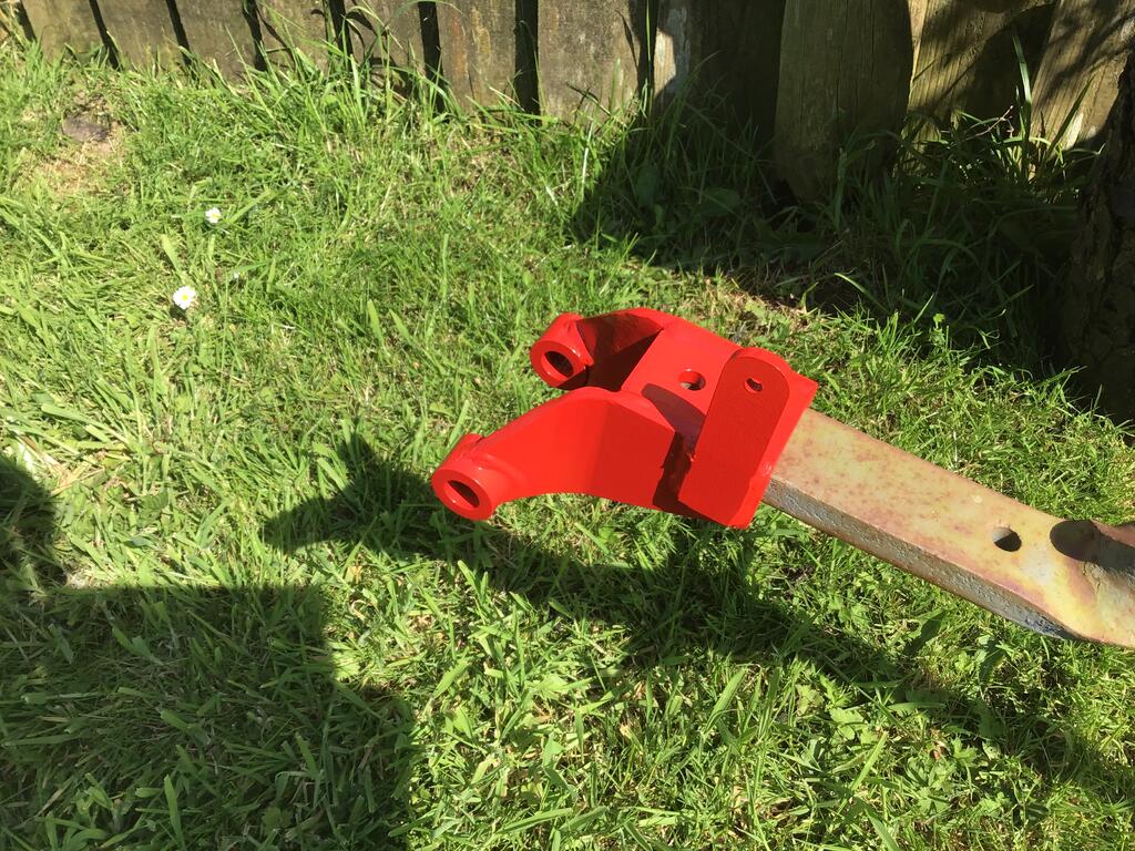

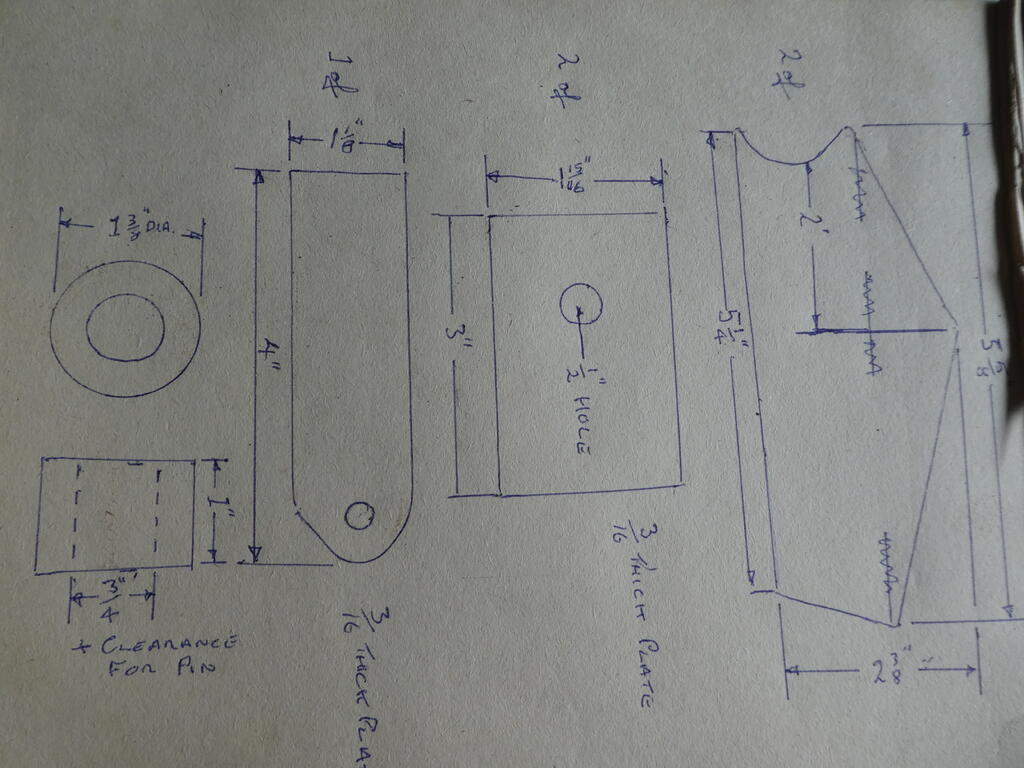

Stormin 9,988 #12 Posted April 16, 2023 Hi Geoff. I don't have any plans for the slot hitch. I copied one. I only made four. Two were sold. Two I've kept for myself. I'll take some measurements and do a drawing. Just give me a little time. 2 Share this post Link to post Share on other sites

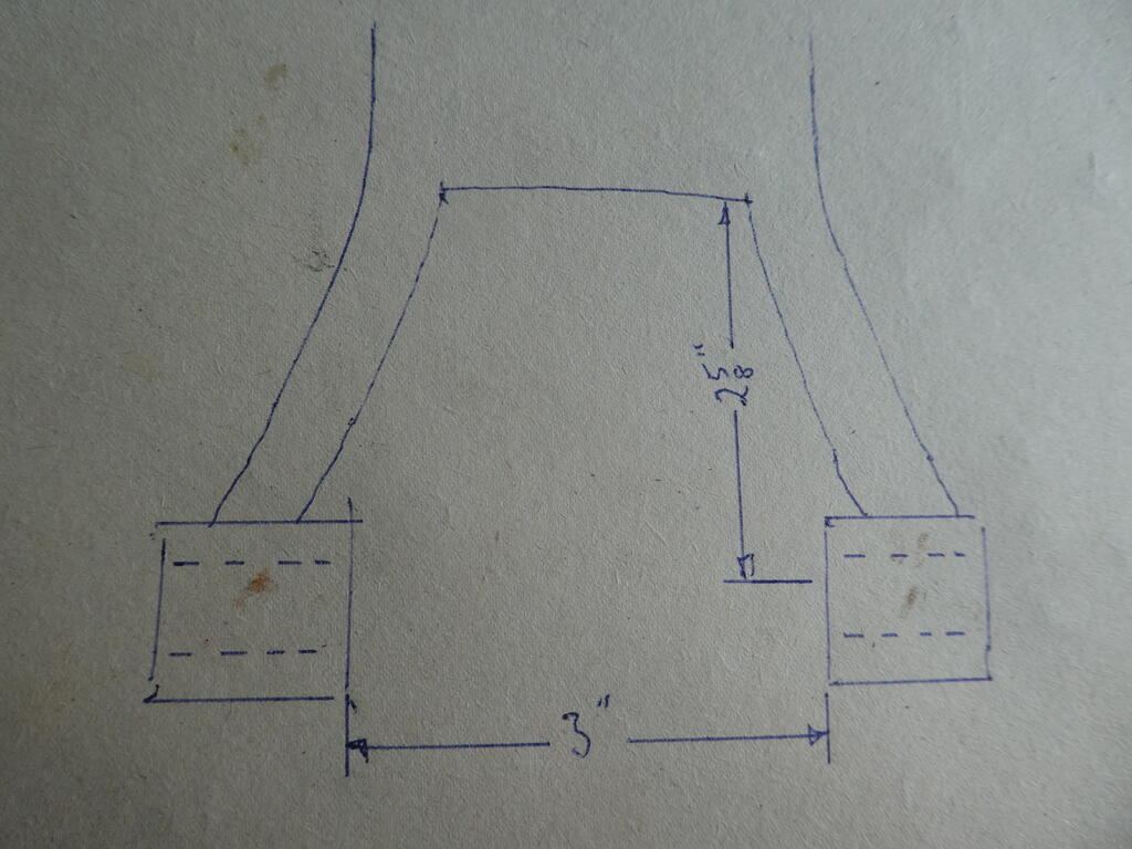

Stormin 9,988 #13 Posted April 17, 2023 Couple of rough drawings and I do mean rough. Hope they will be of help. Share this post Link to post Share on other sites
Geoff Cornwall 75 #14 Posted April 17, 2023 Stormin , thank you so much , absolutely spot on , i will give it a go and let you know how i get on . Share this post Link to post Share on other sites
Geoff Cornwall 75 #15 Posted May 18, 2023 Thought i would thank Stormin for the drawings for the slot hitch , i have had a go at making one . Next i have to find a rock shaft kit , thought id found one in the uk but it hasnt worked out this time . 3 Share this post Link to post Share on other sites
