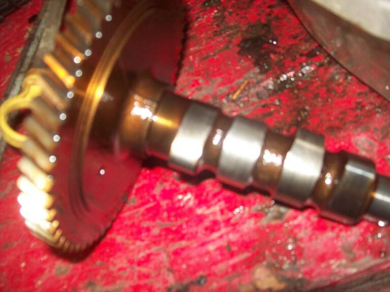

RED-Z06 2,720 #14 Posted April 12, 2023 31 minutes ago, toma said: It doesn't have the full motion as the others. That sounds like a wiped out cam lobe. This causes the running compression in that side to spike, it has to go somewhere when it doesn't all get out of the exhaust valve..so when the intake valve opens..it goes out the intake Share this post Link to post Share on other sites

RED-Z06 2,720 #23 Posted April 14, 2023 Just now, toma said: Im pretty sure it is..I looked down in and it appears ok. I could check again tomorrow. Alright. If its on the lifter cup and not moving at all..the cam lobe is gone Share this post Link to post Share on other sites

RED-Z06 2,720 #25 Posted April 14, 2023 This is what a wiped command cam looks like,2nd lobe is the exhaust on cyl 2, and its perfectly round Share this post Link to post Share on other sites
