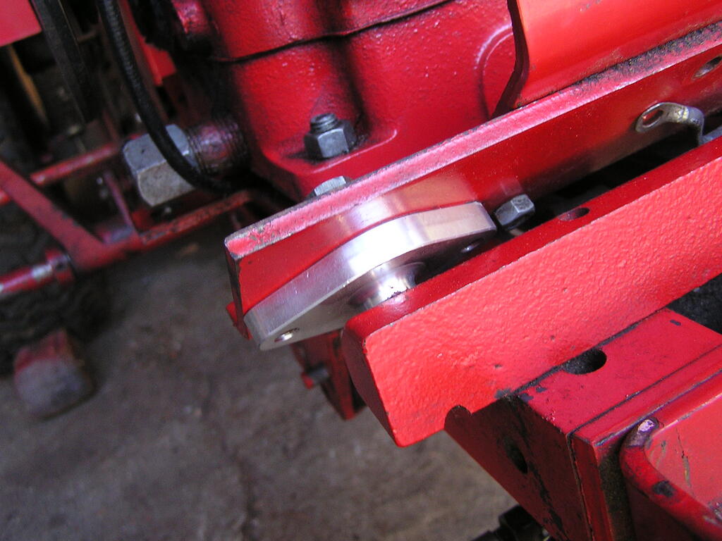

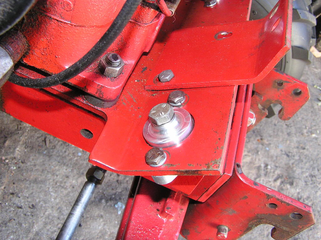

ri702bill 12,171 #2 Posted April 10, 2023 Anthony - 2 things. If you eliminate the shaker plate, the engine height is too low - and that is if there are holes (I do not thinks so) to mount it. Some folks here have made their own solid spacers to eliminate the vibration mounts and keep the shaker plate. I bought a used set of CNC'd solid aluminum ones - they are on fleabay and work great - bolt right in place. They also eliminate the twist of the engine shaft towards the rear when you engage the PTO... 1 2 1 Share this post Link to post Share on other sites

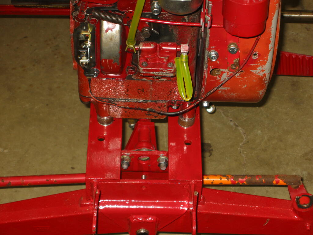

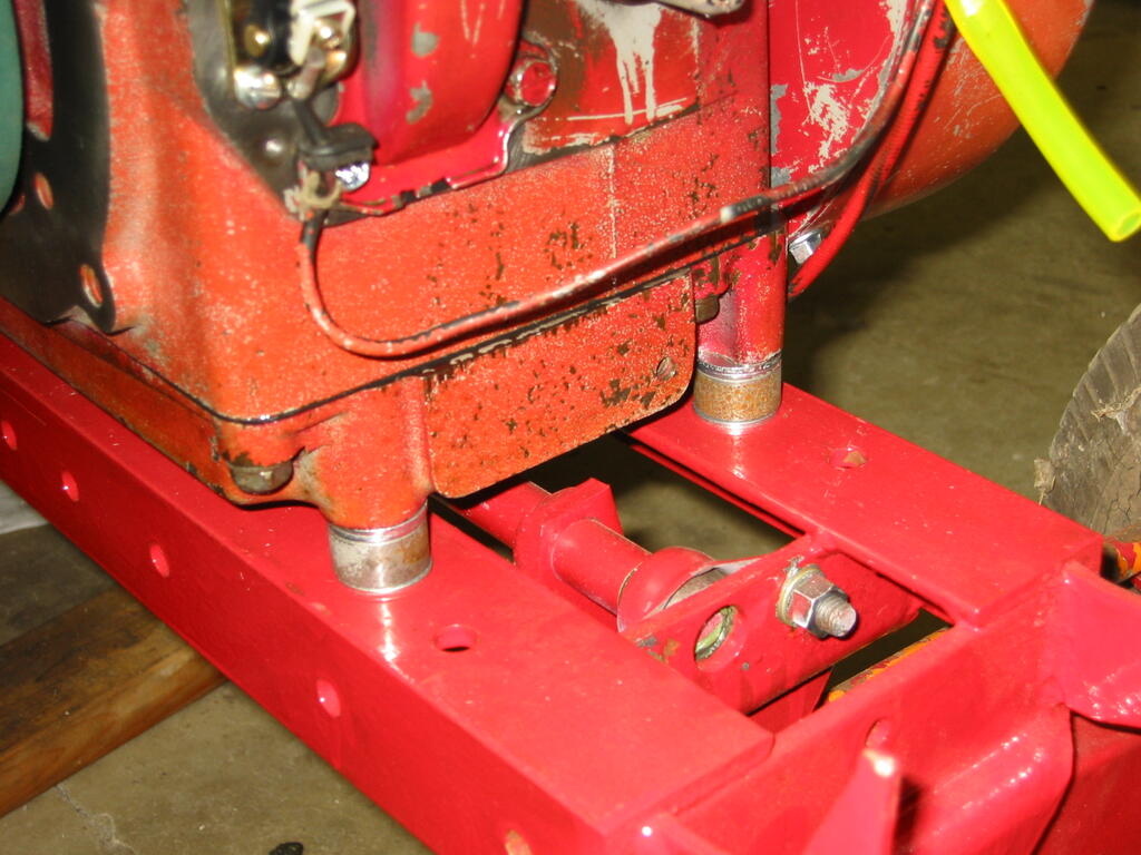

pfrederi 20,613 #4 Posted April 10, 2023 A cheaper alternative 4 spacers and some washers. you may have to drill two holes in the frame. I didn't have to. 3 1 1 Share this post Link to post Share on other sites

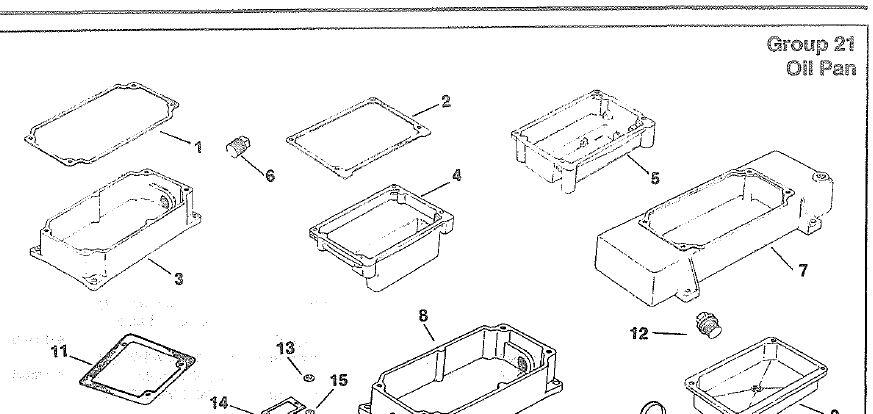

Ed Kennell 46,135 #5 Posted April 10, 2023 4 minutes ago, pfrederi said: A cheaper alternative 4 spacers and some washers. I don't have picures, but I left the shaker plate on one and made solid mounts from 1/2 X 2 steel bar stock and washers. Also worked fine. Paul, is that a special oil pan with the 4 tapped holes and no flanges for thru bolts? Share this post Link to post Share on other sites
pfrederi 20,613 #6 Posted April 10, 2023 It is number 5 part number 4719908 used on WH shaker mounts. You can see the bolts that hold the pan to the block just to the left of the mounting bolts. 1 1 Share this post Link to post Share on other sites

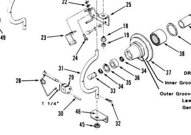

ri702bill 12,171 #7 Posted April 10, 2023 Paul - that works OK if you are NOT going to use the PTO - thw hoop pivots in a hole in the shaker plate under the engine..... 1 1 Share this post Link to post Share on other sites
pfrederi 20,613 #8 Posted April 10, 2023 8 minutes ago, ri702bill said: Paul - that works OK if you are NOT going to use the PTO - thw hoop pivots in a hole in the shaker plate under the engine..... Not a problem A piece of angle iron and a couple holes....or WH part #102870 (Which is a piece of angle iron with 3 holes) provides the support you need 1 Share this post Link to post Share on other sites

ineedanother 2,422 #17 Posted April 10, 2023 Hey Anthony @ANTPER you might also want to check to make sure the engine mounting blocks haven't come loose on the frame. My c-165 was shaking pretty badly so I installed a set of solid mounts from Zach Kerber but when I installed them I found the entire rear mount was loose and likely the main reason it was shaking so badly. 1 Share this post Link to post Share on other sites
