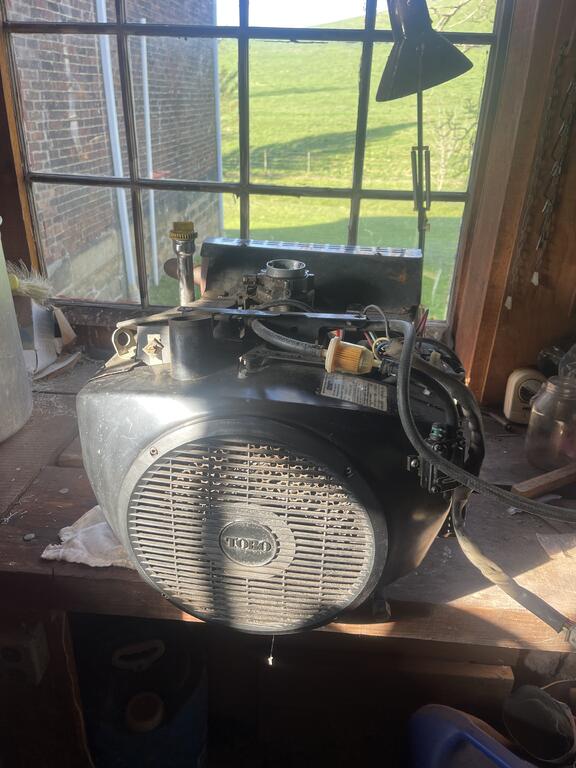

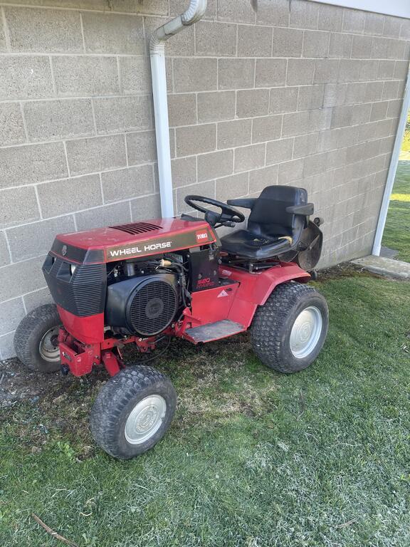

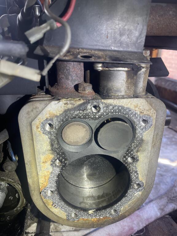

Desko 687 #1 Posted April 9, 2023 Well I picked up a 520 with 640hrs as a non runner and upon putting a battery in it and cranking it it was obvious it didn't have compression on one cylinder. So I went straight to thinking a typical valve seat.... WRONG rear cylinder had compression so I checked the front cylinder and found that it was at fault. No movement from the piston at all so follow along for the rebuild. Unfortunately Cummins/onan has discontinued the connecting rods for the 18-20hp onans but still produce the 16hp rods which is beyond me why but probably not enough market anymore for them. But first let's get this boat anchor out! 3 Share this post Link to post Share on other sites

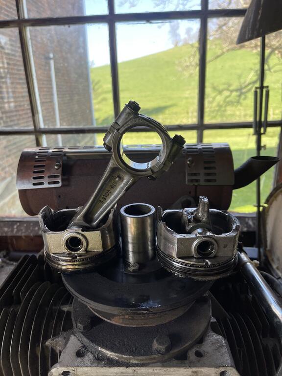

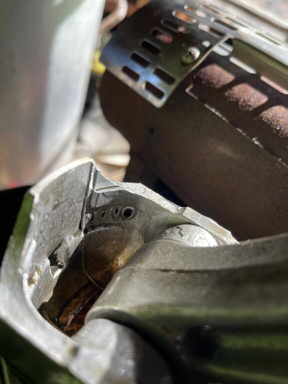

Desko 687 #2 Posted April 9, 2023 Well it's out and on the bench. The rear cylinder looks okay for the most part but depending on how the bottom end looks it is going to need punched over not much cross hatching left. Share this post Link to post Share on other sites

lynnmor 9,073 #4 Posted April 9, 2023 Cross hatching goes away over time, all that matters is an accurate measurement. Opening the bottom will reveal the extent of the damage. 2 Share this post Link to post Share on other sites

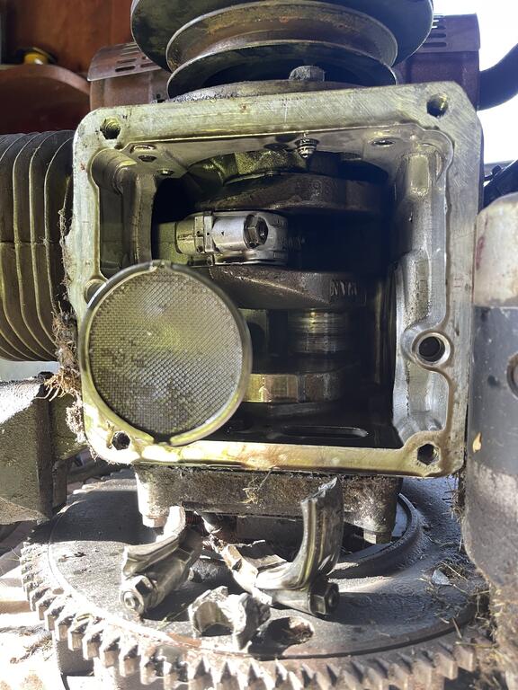

Desko 687 #5 Posted April 9, 2023 Thats true and I will check it before deciding. Surprisingly enough it's not all scored up so a hone and new rings might just do it. But bottom end is opened up and there's not much rod left not really any chunks aside from the crank journal end just mostly flakes and shards. The crank looks a little worse for wear but I'll clean it up and check it if not I have a good in spec on on the shelf. No major damage to the block itself other then a gouge in no mans land when the rod bolt hit it and it also took out the oil feed line which is still available so no big deal. If worse comes to worse I do have a spare block though for just such an occasion. 1 Share this post Link to post Share on other sites

Desko 687 #12 Posted April 10, 2023 1 hour ago, Bill D said: Contact Zach Kerber Machine about making some rods for you. Billet aluminum would be much stronger. Fortunately I found a good set of used rods and matching crank on ebay but I will look into it! Maybe we could at least get a supply on the market because I'm sure this won't be the last onan to spit a rod. There's more pictures to come but I think I figured out why this particular one decided to take itself out. Share this post Link to post Share on other sites

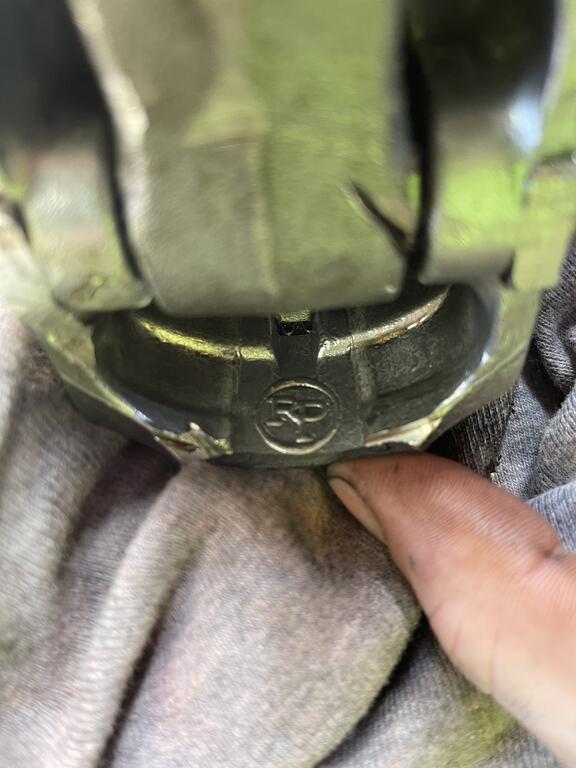

Desko 687 #13 Posted April 10, 2023 Onto the mystery this engine had two miss matched pistons one oe and one aftermarket. Being this engine wasn't low on oil my theory is due to the noticeable weight differences between the two it just ripped the one rod apart because of the imbalance or they assembled the rod wrong. The next question is even though there'll never be a true answer is why did they decide to change a piston in it. Share this post Link to post Share on other sites

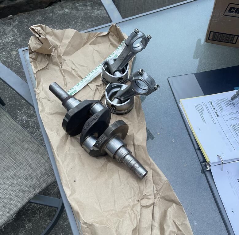

Desko 687 #16 Posted April 15, 2023 Well got home today to some goodies my new crank and rod set showed up. It had some light surface rust that I just cleaned off but might chuck it in the lathe and polish it up better. While my mic set is at work I figured I'd check it with some plasti gauge to get a rough idea where it's at and it comes it right at .002 which is subject to small variations. The book calls for .002 min and .0033 max so it's looking like it should be fine. I decided to go with my spare block for a couple reasons but it will need punched .020 over due to previous water damage and thanks to onanparts I got a new set of pistons for less then aftermarket! Eager to hear this 520 sing with the 60"! Share this post Link to post Share on other sites

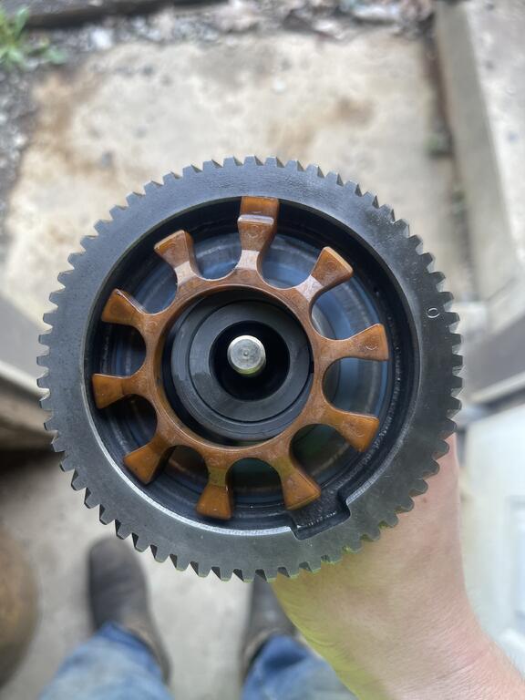

Desko 687 #17 Posted May 9, 2023 We're back onto the onan! Engine is back from the machine shop with fresh .020 bores so it's ready for some reassembly! I got to checking out parts and had this feeling to check out the fly ball spacer and low and behold it was loose from the adhesive breaking down. No worries though I cleaned it up all good and got out the sleeve retainer and reinstalled with the key back in the center of the notch worth a shot at least vs spending $120 for the metal one and doing essentially the same thing. Share this post Link to post Share on other sites
RED-Z06 2,720 #18 Posted May 9, 2023 14 minutes ago, Desko said: We're back onto the onan! Engine is back from the machine shop with fresh .020 bores so it's ready for some reassembly! I got to checking out parts and had this feeling to check out the fly ball spacer and low and behold it was loose from the adhesive breaking down. No worries though I cleaned it up all good and got out the sleeve retainer and reinstalled with the key back in the center of the notch worth a shot at least vs spending $120 for the metal one and doing essentially the same thing. I think ive been paying around 75 shipped for my steel ones Share this post Link to post Share on other sites
Desko 687 #19 Posted May 9, 2023 10 hours ago, RED-Z06 said: I think ive been paying around 75 shipped for my steel ones That wouldn't be bad. I did a quick google search on them and the first couple that came up were about $120 along with the steel ones from the B series for $100 or less. Share this post Link to post Share on other sites
Desko 687 #20 Posted May 13, 2023 Not much to report aside from its all back together. Gotta say it's definitely worth it ol girl runs like a champ and the 60" is a beast! I might have to do a carb clean and such though thought I could get away with not but it has a slight hunt down low but all in all couldn't be happier! Share this post Link to post Share on other sites
