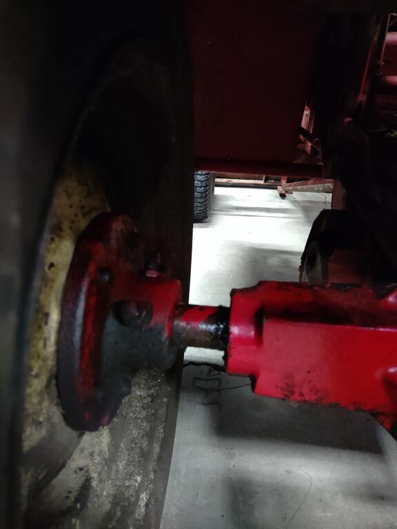

ML3 2,510 #1 Posted April 8, 2023 Been putting off doing axle seals on 1984 C105. I'll change trans fluid as well. Time for maint anyway. Not looking forward to doing it today but winter is over. Any suggestions, tricks, etc?? Share this post Link to post Share on other sites

ML3 2,510 #7 Posted April 10, 2023 Thanks to all for info. Got it done. I ended up replacing bearings anyway. The one side was ever so slightly loose but I just replaced both sides. Luckily, I was able to match up bearing at local parts store. When I got tractor I addressed shift boot/moisture issue in trans so that's all good now. Had a puller that worked to remove wheel hub- it was a bit stubborn. 1 2 Share this post Link to post Share on other sites
