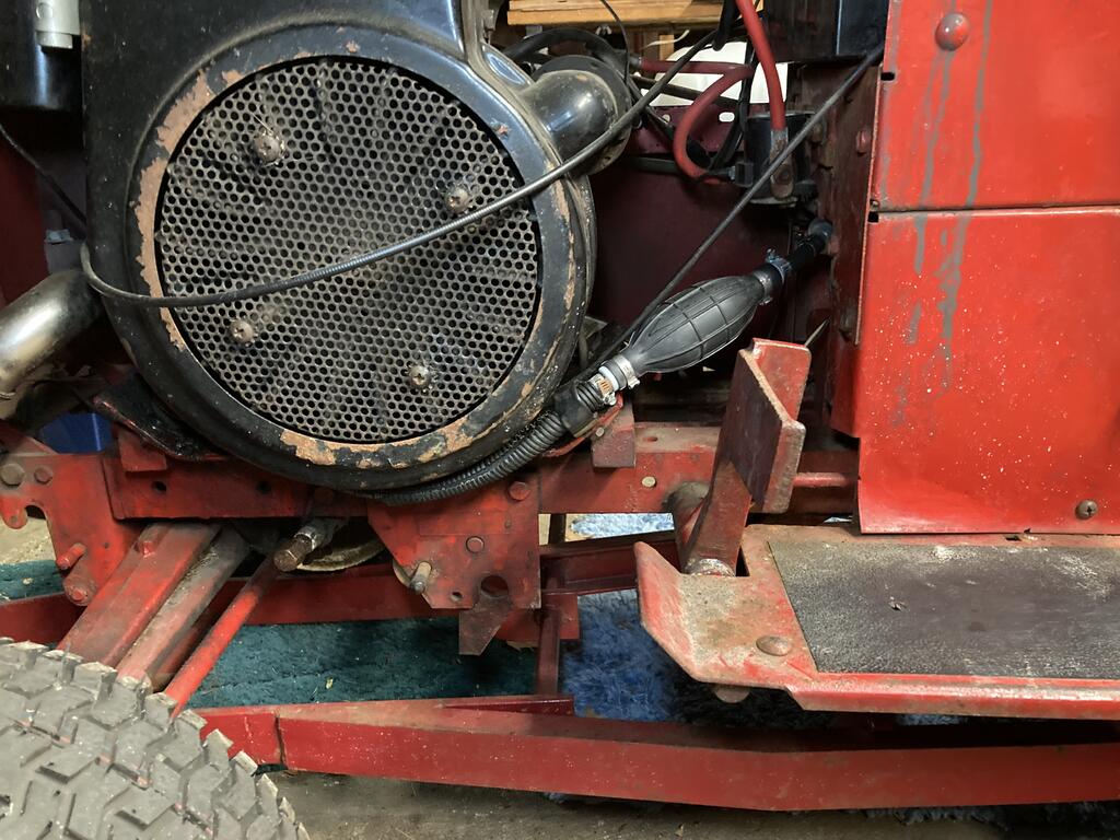

SylvanLakeWH 28,304 #2 Posted April 7, 2023 I use an in-line marine bubble to pressurize the line... couple squeezes works like a charm - very quick starts. 4 1 Share this post Link to post Share on other sites

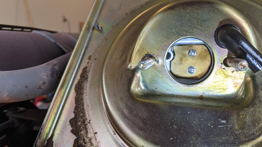

RED-Z06 2,567 #6 Posted April 7, 2023 The carb should remain full for weeks between uses, so drainback would only affect a dry start such as running it out of fuel. Make sure your choke is shutting tightly against the carb body...its crucial to cold starting. Share this post Link to post Share on other sites
oldlineman 1,517 #7 Posted April 7, 2023 In regards to my electric gas pump, I have since made an improvement to the fuse holder and replaced with a weatherproof one as suggested buy some here, thank you. Bob Share this post Link to post Share on other sites
csvt99 173 #8 Posted April 7, 2023 2 hours ago, RED-Z06 said: The carb should remain full for weeks between uses, so drainback would only affect a dry start such as running it out of fuel. Make sure your choke is shutting tightly against the carb body...its crucial to cold starting. Here is what it looks like with the choke engaged. It looks closed to me? I may have another issue with the carb leaking gas but I will start another thread for that. 1 Share this post Link to post Share on other sites
RED-Z06 2,567 #9 Posted April 7, 2023 So this is a 314-8 with a Command single cylinder? That choke plate fitment looks pretty loose, how does it compare to the original? Share this post Link to post Share on other sites
csvt99 173 #10 Posted April 8, 2023 14 hours ago, RED-Z06 said: So this is a 314-8 with a Command single cylinder? That choke plate fitment looks pretty loose, how does it compare to the original? Yes it is the command single. What do you mean by the original? This is the original carb. I guess I should clarify that I did NOT replace the carb. I just cleaned as much as I could without taking it apart Share this post Link to post Share on other sites
hotajax 226 #11 Posted April 11, 2023 On 4/6/2023 at 9:34 PM, SylvanLakeWH said: I use an in-line marine bubble to pressurize the line... couple squeezes works like a charm - very quick starts. So, if you need a part number from Sierra, let me know. Sierra makes decent quality marine parts, and this solution is ideal, and also my go-to option. Don't buy garbage, you don't want to start a fire. 1 1 Share this post Link to post Share on other sites
John c 89 #12 Posted April 11, 2023 I had the same problem recently and went with the primer bulb, huge difference, and was easy to install 1 Share this post Link to post Share on other sites
