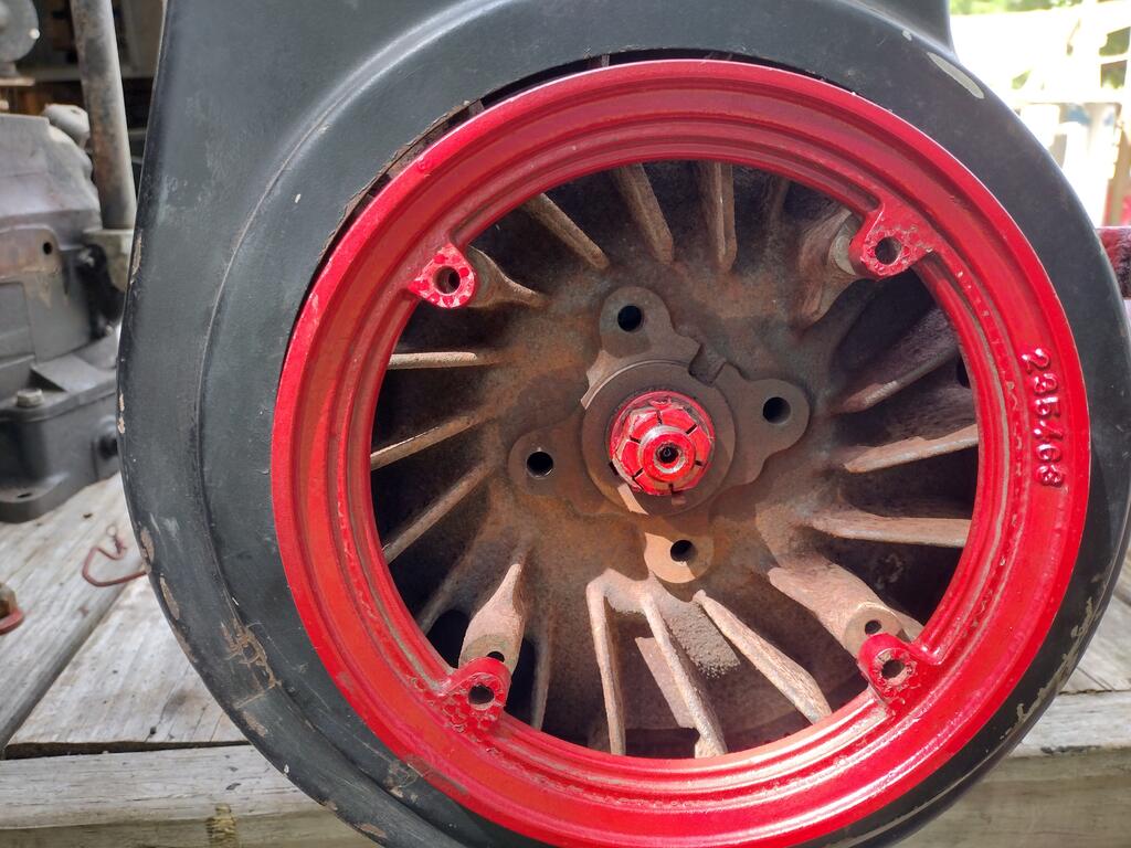

rdmanone 29 #1 Posted April 6, 2023 I need a flywheel starter pulley for my K301. I've got one from my K241 and thought it would work but the bolt pattern is smaller on the K301. I figured it would be the other way around. I guess it's off to fleabay for a pulley from a K301. 1 Share this post Link to post Share on other sites

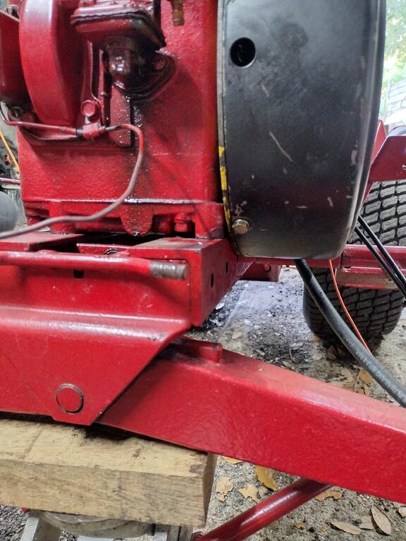

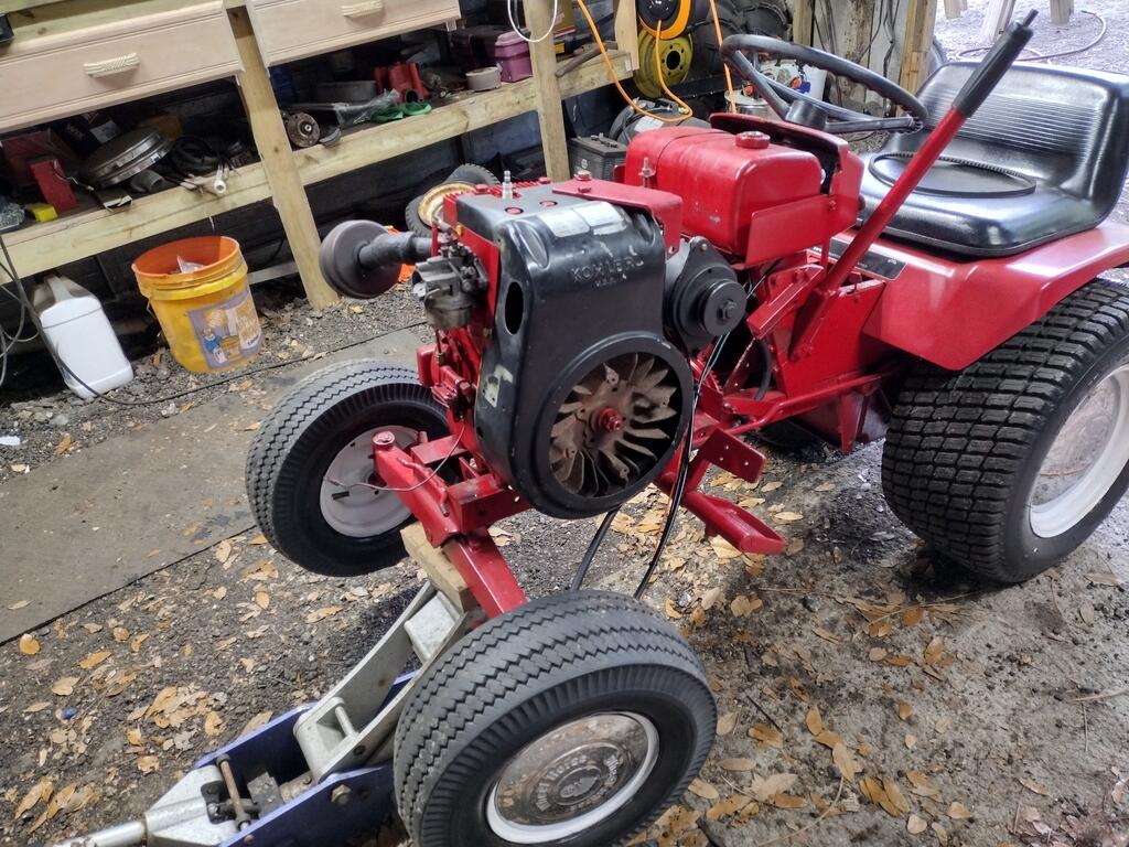

rdmanone 29 #3 Posted April 6, 2023 Let me explain a little what I'm doing. My WH 1055 with 10hp is not charging. The starter generator is not putting out enough voltage to work. I have a spare k301 with the larger flywheel with ring gear. This engine has a stator charging system so using what I have to make it work. So far I have swapped out bearing plates got the engine back together and mounted on the frame. Had to move it over 3/8 inch the bearing plate is now bigger and hangs over the frame no biggie. Now I just need the correct flywheel pulley to start the beast. Share this post Link to post Share on other sites
squonk 48,324 #4 Posted April 6, 2023 You need a #235207 pulley 3 Share this post Link to post Share on other sites

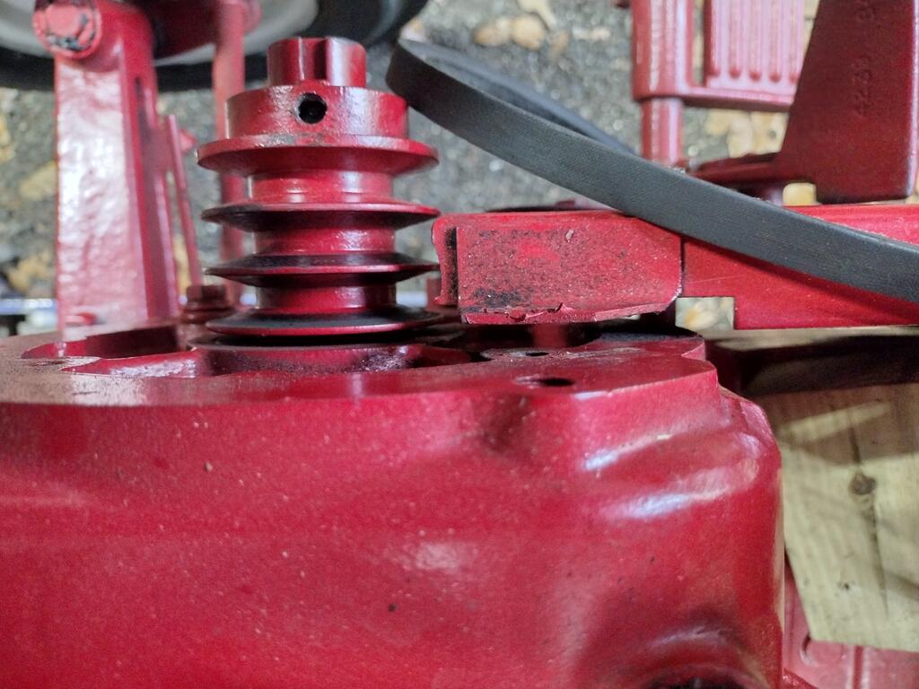

rdmanone 29 #5 Posted April 6, 2023 Gonna have to bring the drive pulley out just a snicket. Share this post Link to post Share on other sites
WHX?? 58,347 #6 Posted April 6, 2023 Ahhh a Franken motor... wouldn't it been easier to just get the SG working as should? 1 Share this post Link to post Share on other sites
rdmanone 29 #7 Posted April 6, 2023 Yes it would but it's just out of my price range. 1 Share this post Link to post Share on other sites
953 nut 70,325 #8 Posted April 7, 2023 12 hours ago, squonk said: You need a #235207 pulley There are three of them on right now. That would be from a 12 HP Kohler engine from '66, '67 or some '68. Later models all had the ring gear starter. 1 Share this post Link to post Share on other sites
