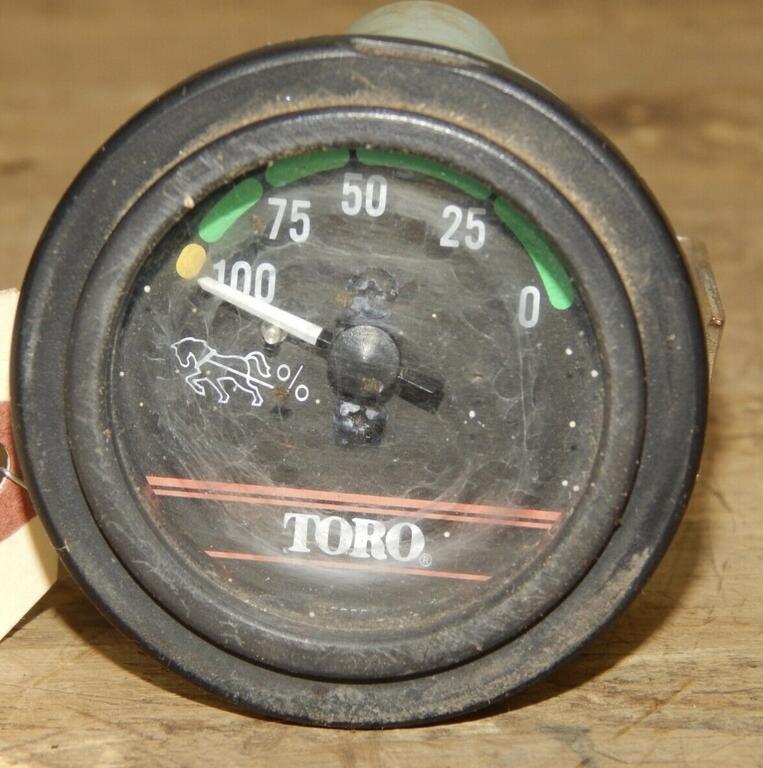

WheelHorseVH 109 #1 Posted April 6, 2023 Has anyone tried to repair their horsepower vacuum gauge on a 520H? Mine has the needle stuck below the lowest part (not sure how it got there) and does not move when running even those the line looks connected. I don't even know if its possible to open it up and even if I did I truly don't know what I would find inside of it. Any advice? I know most people think its sort of a nonsense gauge to begin with but there's just something about a non-working gauge that drives me a little buggy every time I see it. Share this post Link to post Share on other sites
WHX?? 52,171 #2 Posted April 7, 2023 (edited) 6 hours ago, WheelHorseVH said: there's just something about a non-working gauge that drives me a little buggy every time I see it. I'm kinda the same way so there for ya. Check the nipple on the back they frequently break off. Hose ok going to the manifold? It's pretty much just a vacuum gauge. You really can't take them apart but if it's broke yer not gonna hurt it in trying. Maybe needle just stuck? Try shaking it around to unstick it? Might be a diaphragm in it that's shot too. As many as 520s getting parted out these days maybe a good used one on fleabay or a member has one? Just thinking out loud here. Edited April 7, 2023 by WHX?? 2 Share this post Link to post Share on other sites

WheelHorseVH 109 #6 Posted April 8, 2023 Not a terrible idea @cleat @WHX?? ok well heres how bad my OCD is…I could only ever buy another vac gauge if it was from the correct year. Mine looks like the one attached. Maybe I should post this in the wanteds. Share this post Link to post Share on other sites
