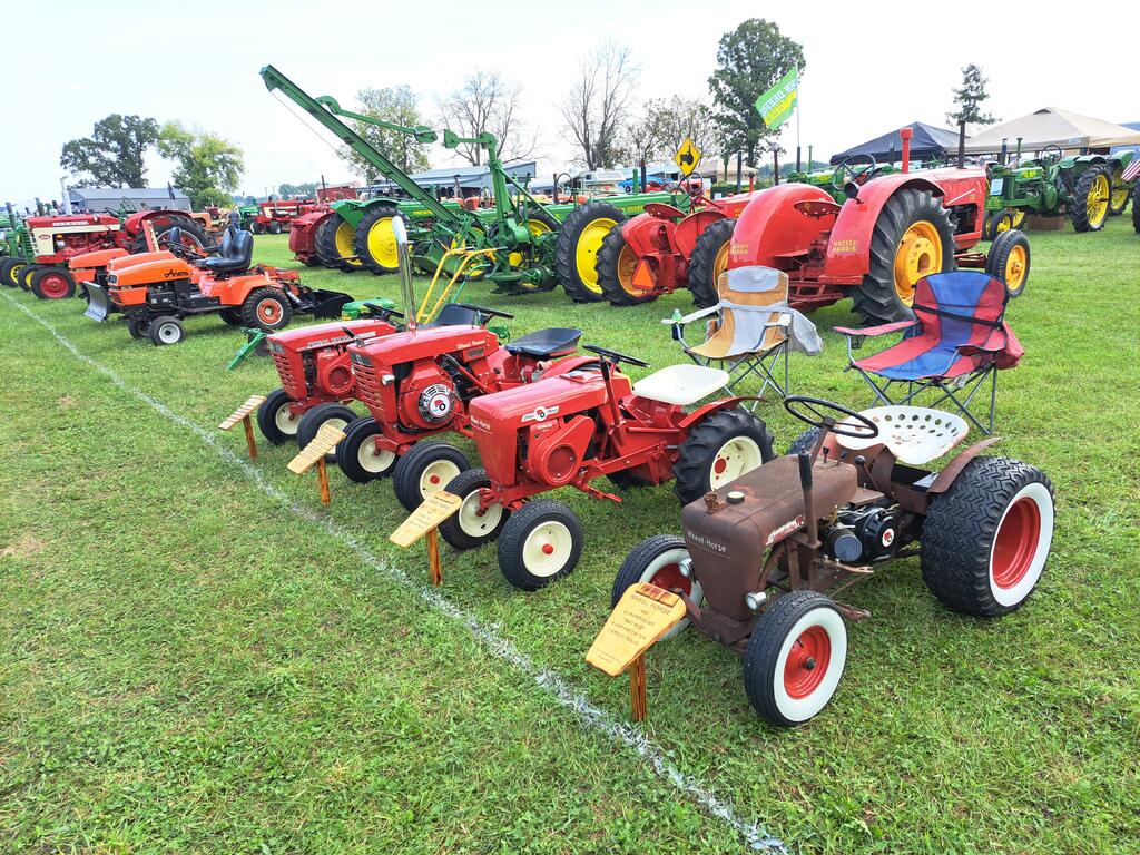

WHX?? 57,904 #15 Posted April 6, 2023 Sorry Bob I gotta side with 'Fish on this one. Case in point @Achto's rat. 3 Share this post Link to post Share on other sites
Achto 32,473 #16 Posted April 6, 2023 (edited) 1 hour ago, rmaynard said: Rust is rust. Rust is not patina. On the scientific / technical terms I gotta side with Bob on this. Patina is actually a protective coating that forms/grows on non-ferrous metals such as copper, bronze, or brass. This coating actually helps to protect the underlying metal. Rust is the oxidization of ferrous metals that happens as they start to break down. I appreciate the rust look on some tractors as well as I appreciate pretty paint. NOW - back on subject. Paint together or apart in my mind depends on the purpose of the tractor. I would have no problem painting a worker while it is mostly assembled. On a resto I want to clean, inspect, and paint each piece individually. As we know most resto's end up having a better paint job than the factory ever dreamed of. Edited April 6, 2023 by Achto 5 Share this post Link to post Share on other sites

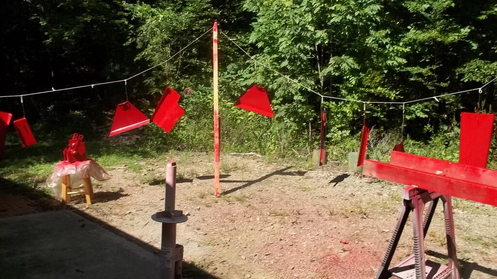

953 nut 68,796 #17 Posted April 7, 2023 8 hours ago, rmaynard said: always painted individual parts and assemblies, then assembled. Got to hang the red laundry out to dry. 2 2 Share this post Link to post Share on other sites
WHX?? 57,904 #18 Posted April 7, 2023 (edited) 26 minutes ago, 953 nut said: Got to hang the red laundry out to dry. Lol Richard... what was that about rust not being a patina? Question is here Bob what's the easiest thing, or right thing, to do to coach your boy on? Talk to him on it. His 701 give him the reins. Is he willing (or you) to do the parts separately? Does he want a show room piece or just something to have fun on? Rattle can or gun? We know you have some HF cheapys which would be fine. You want to teach him the unfiner points of a gun go for it with a partial tractor. Short story get him involved. Edited April 7, 2023 by WHX?? 2 1 Share this post Link to post Share on other sites
