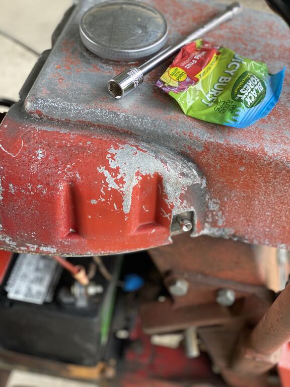

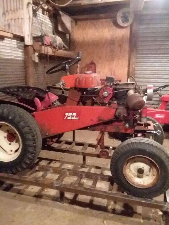

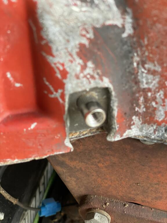

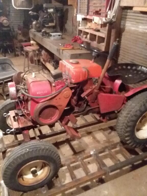

Chrishar 1,074 #1 Posted March 31, 2023 I trade a 633 for this 753 needs some loving care but it does run good and third gear is out and the gas tank one of the bolt holes is broken out 5 3 Share this post Link to post Share on other sites

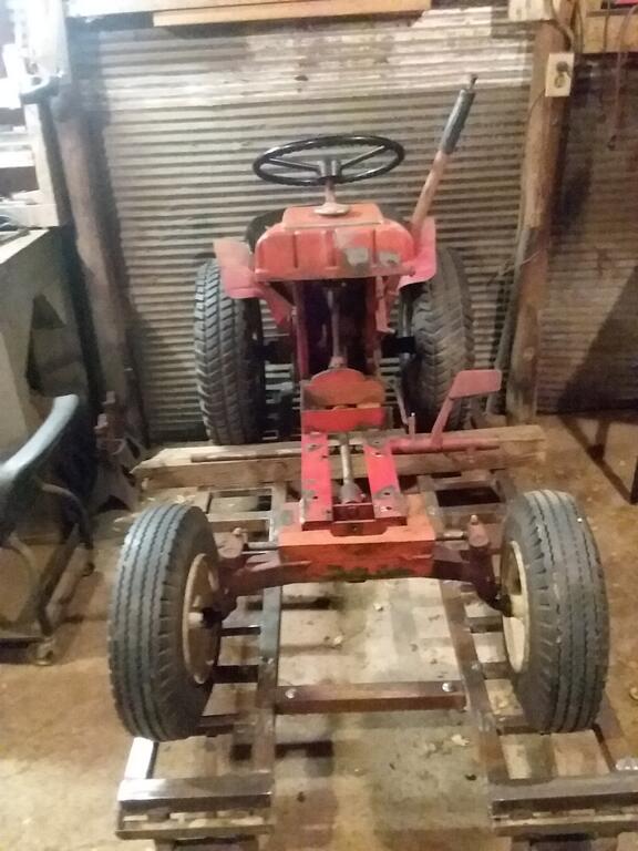

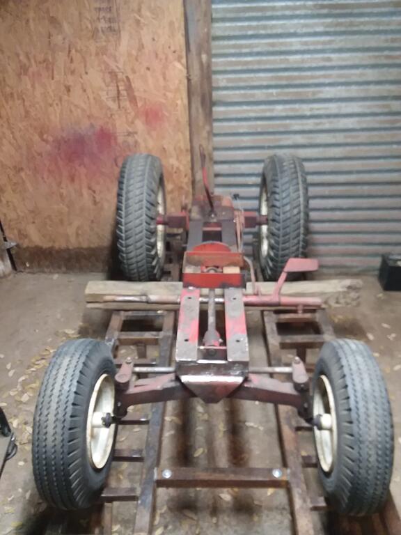

Chrishar 1,074 #2 Posted March 31, 2023 Started taking it apart one pices at a time 4 3 Share this post Link to post Share on other sites

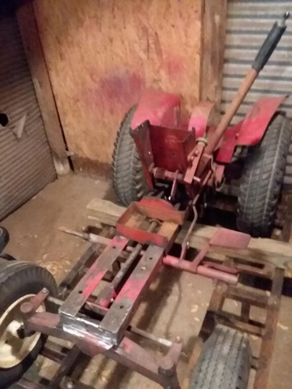

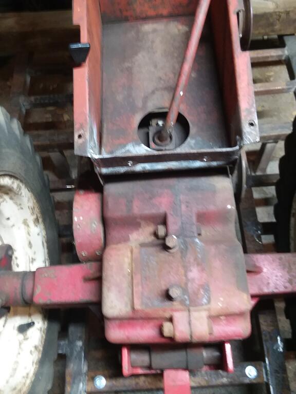

Chrishar 1,074 #3 Posted March 31, 2023 Got the motor and the wiring off start working on getting off the front pices that someone put on it and look at the steering system 4 1 Share this post Link to post Share on other sites

ri702bill 13,398 #5 Posted March 31, 2023 (edited) Broken bolt hole - for the hood?? Fairly easy fix - you do need to remove the tank - may be able to leave the upper steering unless the tank bushing is shot. Use a square 1/4 nut imbedded in JB Weld and a lightly greased 1/4 screw to pinch it in place. Fixed the 2 piece tank on the 502 that way.. Lowell sells the new 3rd gear - openit up first - may need more than seals & a boot... Bill Edited March 31, 2023 by ri702bill 3 Share this post Link to post Share on other sites

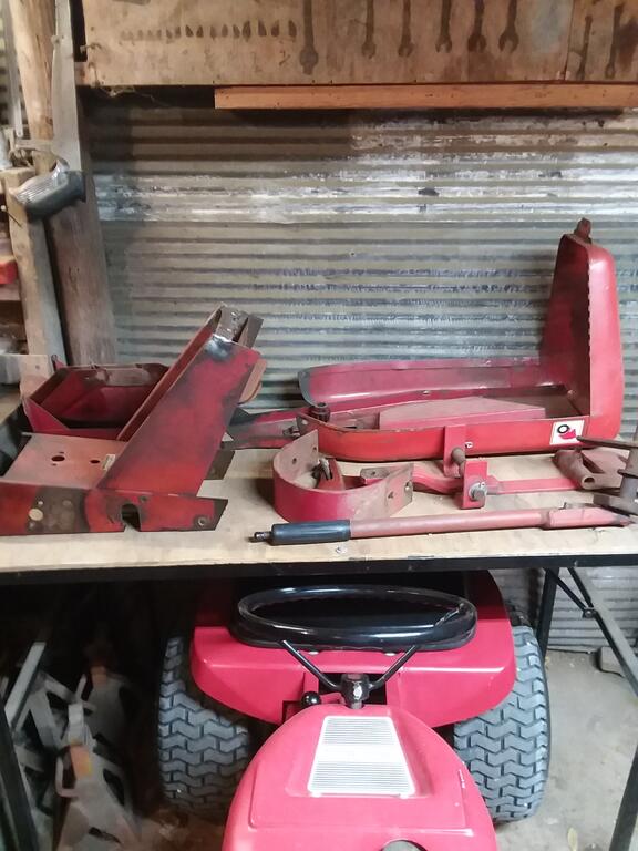

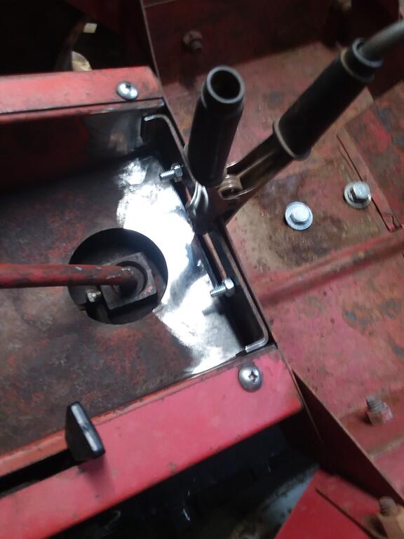

Chrishar 1,074 #7 Posted April 1, 2023 Got a little done last night got that front pices off and weld some holes up that someone put in on the front 6 Share this post Link to post Share on other sites
Chrishar 1,074 #8 Posted April 4, 2023 Work on it little tonight made a bracket and weld it in because it was gone 2 5 Share this post Link to post Share on other sites

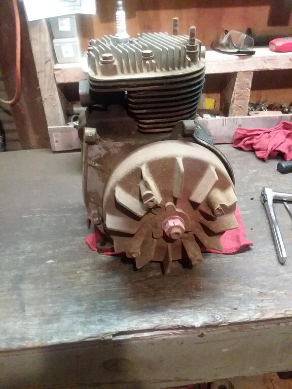

Chrishar 1,074 #9 Posted April 7, 2023 (edited) stop Working on taking the tractor apart four a week or two Working on taking the motor a part found that the head is crack so now I will look for one Edited April 7, 2023 by Chrishar 3 1 Share this post Link to post Share on other sites
AMC RULES 37,261 #10 Posted April 7, 2023 753 1963 Lawn & Garden Tractor 753 4-Speed Kohler K161S-28626E 7 Wheel Horse 5025 Seeing a couple K161 heads listed up on Ebay now. 2 Share this post Link to post Share on other sites

Chrishar 1,074 #12 Posted April 10, 2023 If anybody can give me some idea's on how to fix the piece that is broken out on the gas tank were the hood bolts too help thanks 3 Share this post Link to post Share on other sites
WHX?? 58,388 #13 Posted April 10, 2023 I read somewhere a guy JB welded a nut in ther. 2 1 Share this post Link to post Share on other sites
Achto 32,964 #14 Posted April 10, 2023 9 hours ago, Chrishar said: If anybody can give me some idea's on how to fix the piece that is broken out on the gas tank were the hood bolts too help thanks I was going to remove the bottom from the tank, clean the area up and use low temp aluminum weld rod to fill the area in. https://www.harborfreight.com/search?q=low temperature aluminum welding rods After the area was filled then the plan was to drill & tap a new hole. Then reassemble the tank with a new gasket. One suggestion, but I'm sure guys will be along with a few more. 1 1 Share this post Link to post Share on other sites
WHX?? 58,388 #15 Posted April 10, 2023 I used that kind of product to fill in PO holes from a throttle mount in the 701 tank. Worked very well. 1 Share this post Link to post Share on other sites
Chrishar 1,074 #16 Posted April 10, 2023 What kind of jb weld to used 2 Share this post Link to post Share on other sites
Chrishar 1,074 #17 Posted April 15, 2023 Work on it last night try to fix the fuel tank with jb weld but no luck with it looking for a welding shop or a another tank or if y'all had any ideas 4 Share this post Link to post Share on other sites
WHX?? 58,388 #18 Posted April 15, 2023 Why didn't the JB weld work? Only thing I can think of is fill it with aluminum weld then drill & tap. 2 Share this post Link to post Share on other sites

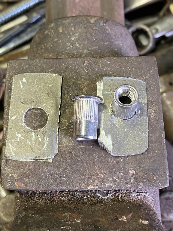

Lane Ranger 12,167 #19 Posted April 16, 2023 I did a gas tank rebuild on one missing the two side nuts to accept the thumb screws when the hood was on. I thought I posted the pics on Red Square three or four years ago but could not find them. What. I did is bout some 1/4 X 20. Special nuts with a flange. These are deeper nut that have various names depending on who makes them. These are Tacoma Screws but there are others with similar design. What I did is fabricate a small metal plate and drilled a hole in the plate to accept the Tacoma Nut but JB Weld to the flange and back of the plate to the tank. Now the tenanted of the old famed pieces need to be removed (or revised to accept you new plate and Tacoma Nut! Sorry I don’t have a lot of pics but this works better than using a traditional nut or traditional flanged nut as the extra length on the Tacoma Nut strengthens the fix. https://www.tacomascrew.com/Product/055-010 3 Share this post Link to post Share on other sites
Chrishar 1,074 #20 Posted April 16, 2023 Do you have any picture of the fix 2 Share this post Link to post Share on other sites
Lane Ranger 12,167 #21 Posted April 17, 2023 Well I found the old pics from a trip to Florida several years ago where I redid my friend Rodney Burger’s 753 gas tank thumbscrew sets. These three pics show all but the removal of the old metal sets in the tank that accept the thumbscrews. JB Weld on sides and behind accepted everything fine. I taped in temporarily and tested hood with thumbscrews to make sure alignment was good. This works great in my opinion. 3 Share this post Link to post Share on other sites
Chrishar 1,074 #22 Posted April 17, 2023 Thanks for the good idea I'll try that see how that works 3 Share this post Link to post Share on other sites

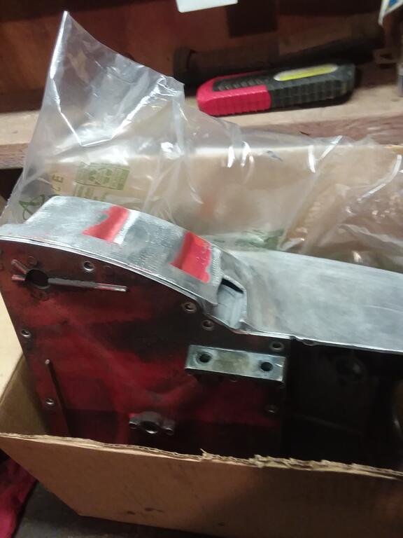

Chrishar 1,074 #23 Posted April 20, 2023 Found a good cly head and a gas tank just waiting for them to come in planned on next week start working on the old 753 by taking it a part fix the steering system and rebuilt the transmission and go though the motor doing a little body work and a good red paint job and have it all done by the temple show I hope will put pictures has I go along with this project 2 1 Share this post Link to post Share on other sites
