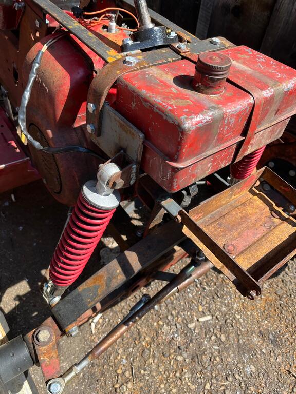

wallfish 20,724 #42 Posted April 21, 2023 Found some places for the gas tank, battery and a bearing then made some mounting for them. Should be able to have the filler neck for the tank protrude up through the hood for easy quick filling. Unfortunately this stuff adds even more weight to the front but they gotta go somewhere. Added another steering shaft bearing on top to keep that shaft stiff and straight. 5 6 Share this post Link to post Share on other sites

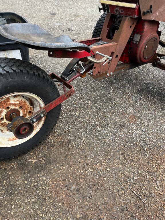

wallfish 20,724 #43 Posted April 22, 2023 Anyone ever try to shorten those slide type seat adjusters? Certainly not a common thing to do. Found an old set in the parts pile and spent 4-5 hours $%^&ing around with that thing today and still didn't get even 1 of the 2 slides done. 12-14 inches is just way too long for that style seat so I figured just change the stop locations for those rollers and bearings, cut the ends and Whola, a shorter slide. Not so much! Sure wish that time was spent on something more important or productive. 3 2 Share this post Link to post Share on other sites

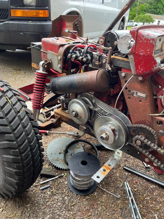

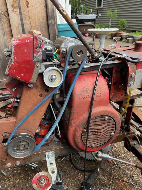

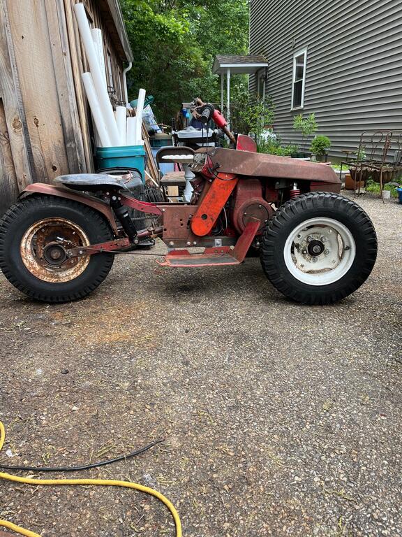

wallfish 20,724 #45 Posted June 5, 2023 Been making some progress. Went with a M18 starter that I didn't remember was on the shelf for the reverse. Floor boards will make it difficult to Flintstone it in reverse. The floor boards help to lower the look of it. Got the hood fab stuff mostly done but still need to build a front mount. Wiring all set. Engine runs nice and did take it for a test ride. It's getting pretty busy under the hood so probably gonna a pain to work on. Stuff is gonna need to be removed to work on other stuff. Still have lots of bracing to do and get the pedals figured out. 1 for brakes and 1 for the reverse belt. The handle bars will probably drop an inch or few 7 7 3 Share this post Link to post Share on other sites

wallfish 20,724 #47 Posted June 5, 2023 6 hours ago, Handy Don said: Looks like it’ll go like crazy. 😁 Not so much by plan. It's "geared" so it should be maybe top out at about 10 MPH currently. Enough to be faster than your average tractor simply because it would be embarrassing to get passed by a B-80. When it's geared down like it is the torque converter doesn't get up to enough speed to change those variable pulleys very much. That's not to say it won't be geared different in the future because it probably will. Better to find any weak points and work out some of the kinks at 10 MPH than it is at 30 MPH. The setup with a jack shaft allows for plenty of adjustment by changing sprocket sizes. 4 3 Share this post Link to post Share on other sites
