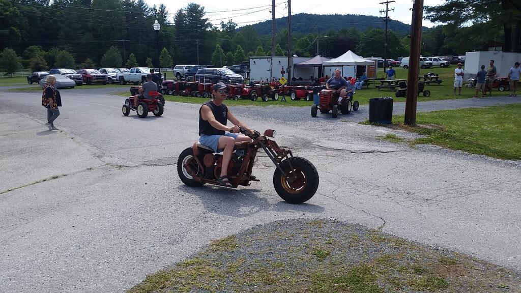

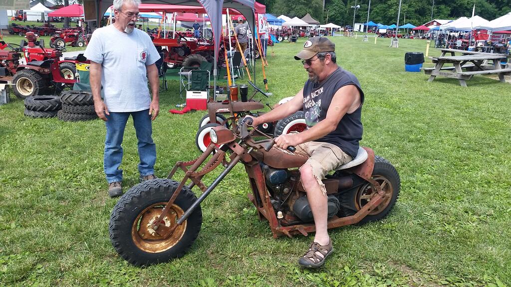

wallfish 20,724 #1 Posted March 30, 2023 So this started as a different project but as happens often it turned into something else. It will be made from as many WH parts as possible so finding the right parts for a purpose kinda slows things a little. It's still in the building stages but there's enough there to roll and mock up for pics to give an idea what going on. It's getting tougher and tougher to come up with something new that hasn't already been done. Same torque converter drive as the other bike but this one will be chain driven instead of a belt. Split suburban axles for the front suspension with suburban lift handles for rear swing arm suspension, so it should ride a bit smoother than the rigid bike does. Hoping to have done for a local show or 2 before the big show to work out any kinks 10 11 7 Share this post Link to post Share on other sites

Pullstart 71,482 #10 Posted March 31, 2023 Awesome stuff John! I’m officially dropping “ride the 2 wheel “ ticket in my bucket of to do’s! Once that one gets pulled out, I’ll toss the ride the can am in! It seems like you’ve mentioned this front suspension more than once in the past. I’m liking the idea come to reality! 1 Share this post Link to post Share on other sites
wallfish 20,724 #11 Posted March 31, 2023 9 hours ago, SylvanLakeWH said: Love the Hood!!! It's difficult to make one of those black hoods look good But I always liked the lines of that top section 3 minutes ago, Pullstart said: Awesome stuff John! I’m officially dropping “ride the 2 wheel “ ticket in my bucket of to do’s! Once that one gets pulled out, I’ll toss the ride the can am in! It seems like you’ve mentioned this front suspension more than once in the past. I’m liking the idea come to reality! You gotta ride'm both 2 1 Share this post Link to post Share on other sites
