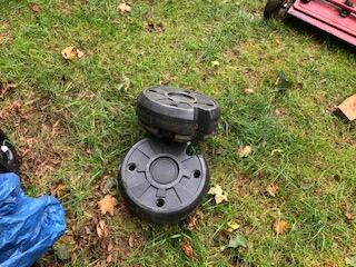

WheelHorseVH 110 #1 Posted March 28, 2023 Hi All, I have the rear wheel weights pictured below and a 1996 520-H, original wheels. Can anyone please tell me what the exact bolts are that I need and where to order? Thank you. Share this post Link to post Share on other sites
ri702bill 13,189 #2 Posted March 28, 2023 (edited) Depends on the offset of your wheels AND if you are using 1/2-13 carriage bolts or hex screws and nuts. You need to figure the length... Easiest way is to use the carriage bolts from the INSIDE - there are 4 square holes for them - but - you end up with threads that stick out beyond the weight, ready to snag anything nearby. I prefer to put 2 flats on the heads, use a pair of needlenose locking pliers to hold them, washers and Nylock nuts in the inside. Nothing to snag on... Got them from Lowes - in stock.... Edited March 28, 2023 by ri702bill 4 Share this post Link to post Share on other sites
WheelHorseVH 110 #3 Posted March 28, 2023 I am thinking of going the factory route, did they ship with the 1/2 13" carriage bolts when new? I am not sure what the offset on this wheel is, it is the original wheel so perhaps I can look it up somewhere? Share this post Link to post Share on other sites

Achto 32,842 #7 Posted March 28, 2023 Slide the weight into the rim, use a tape measure to measure through the bolt hole to the rim, ad 1 to 1 1/2 inches for the nuts & washer. This is how I figures out how long of 1/2-13 carriage bolts to get when I mounted my wheel weights. 1 Share this post Link to post Share on other sites
ri702bill 13,189 #8 Posted March 28, 2023 (edited) 31 minutes ago, WheelHorseVH said: did they ship with the 1/2 13" carriage bolts when new? I do not believe they came with fasteners - they had no way of knowing the width of your rims. The 854 has narrow rims - bolts about 5-1/2" long. The C series has wider rims - perhaps 8 ??? inches or so..... Reminds me of the old joke - Guy goes to the lumber Aisle looking for 2x4's. Clerk asks "How long do you need them??" He replies "I'm building a house, I'll need them for a long time......" Edited March 28, 2023 by ri702bill 4 Share this post Link to post Share on other sites

WheelHorseVH 110 #11 Posted October 20, 2023 Thanks for all the help guys. Today I finally got around to going to my local specialty fastener store and got the carriage bolts. In case anyone else ever needs to know: for the weights pictured in my original post, along with factory 520H wide rims, the size of the carriage bolts you need are 1/2-13 x 11". This leaves you about an inch sticking out past the weight which is enough to get the washer and nut on without having them stick out so far that its a liability. 1 1 Share this post Link to post Share on other sites
