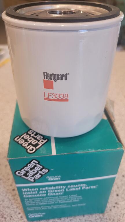

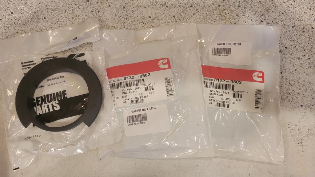

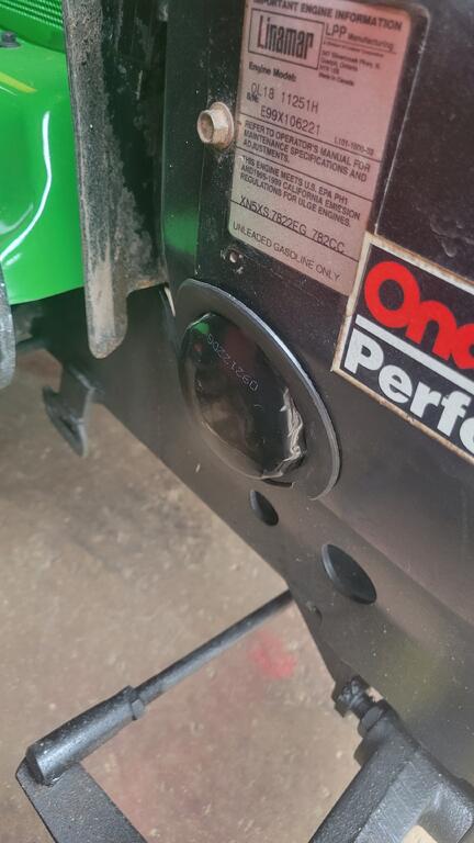

RED-Z06 2,720 #1 Posted March 27, 2023 Finally got mine in and put on...3 onans and none had them. 1 2 Share this post Link to post Share on other sites
oldlineman 1,820 #2 Posted March 27, 2023 I like the seal not so much the filter. Share this post Link to post Share on other sites
kpinnc 19,060 #3 Posted March 27, 2023 46 minutes ago, oldlineman said: I like the seal not so much the filter. It's sometimes a bit iffy finding the longer filters. I've had to go with shorter ones before myself. But always good to see the seals in use! 1 Share this post Link to post Share on other sites
RED-Z06 2,720 #4 Posted March 27, 2023 What dont you like about the filter, and what brand would you say it is? Share this post Link to post Share on other sites
Handy Don 17,675 #5 Posted March 27, 2023 Don’t know if you bothered to test, but without the seals an amazing amount of air comes whooshing out of the shroud-to-filter gap! Share this post Link to post Share on other sites
RED-Z06 2,720 #6 Posted March 27, 2023 7 minutes ago, Handy Don said: Don’t know if you bothered to test, but without the seals an amazing amount of air comes whooshing out of the shroud-to-filter gap! Its quite a bit of leakage...and the rear/right cylinder is always the one that pukes a seat Share this post Link to post Share on other sites

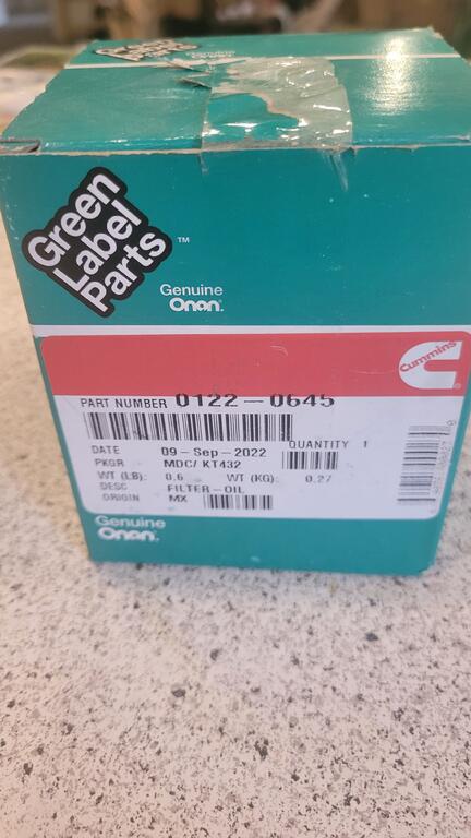

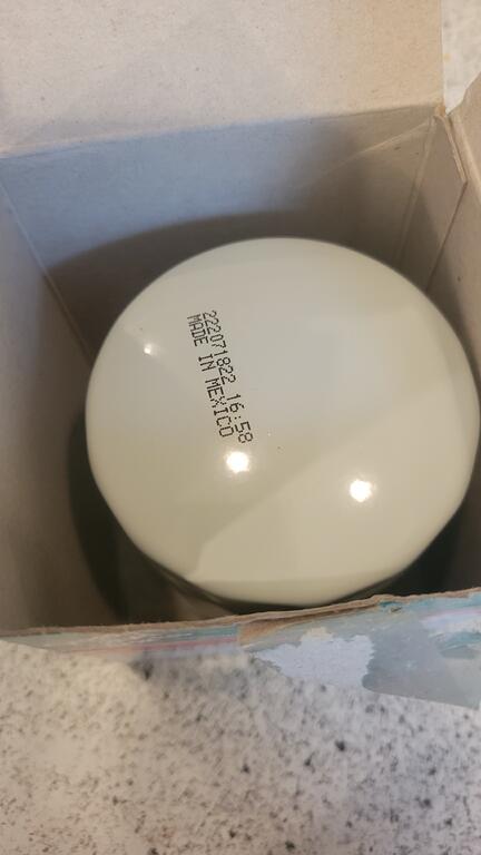

RED-Z06 2,720 #7 Posted March 27, 2023 Fwiw...that filter.. Share this post Link to post Share on other sites
oldlineman 1,820 #8 Posted March 28, 2023 Sorry RED-Z06 The filter is ok, was referring to the place of manufacture. Bob Share this post Link to post Share on other sites

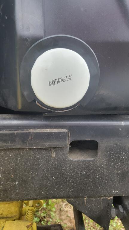

RED-Z06 2,720 #9 Posted March 28, 2023 This filter is right at 3.48" tall, any taller and it would be difficult to get on the WH and it would hit the side panels on the Deeres..it sticks out about 1/2". This is a Wix XP filter on a P218G, it sticks out slightly less. 2 Share this post Link to post Share on other sites
ri702bill 13,316 #10 Posted March 28, 2023 (edited) 15 hours ago, oldlineman said: Sorry RED-Z06 The filter is ok, was referring to the place of manufacture. Bob Oh, yeah. It's still a North American product, not from offshore !! Worked at a Tier 1 Automotive OEM for 14 years, most of our product lines got sent to our Juarez "Low Cost North American Provider" facility, as Corporate would refer to it, from up here over the years .. many road trips there... Back before NAFTA, there was a tactical "fib" used by a lot of manufactures that had their products made in Mexico - those that had manufacturing plants in Juarez, and a sister "Packing and Distibution" facility 2 miles away in El Paso Texas. Parts would arrive in bulk from Mexico and go to El Paso for packaging and shipping. Back then, the packaging read "Printed and Packaged in USA"... with NO mention of the Country of Origin of the contents inside....... Edited March 28, 2023 by ri702bill 1 Share this post Link to post Share on other sites
