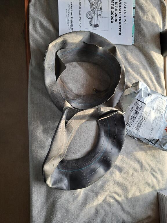

pacer 3,180 #1 Posted March 27, 2023 So I have a 6" tubeless tire that like they do all to often do - not hold air. As I'm sure many of you, like me simply put a tube in one and - problem solved.... right?? So I run down to the TSC store just couple miles and pick up a 15$ tube, put it in the tire and start to air it up and ... nothing??? Open back up and ... whoa! the tube had split all around the seam! Take it back, get manager and show him and ask has he had any other fails. He says no, but we will replace it, no prob - no thanks, I dont want to get another and have the same thing happen. Come back home and pull up the jungle site and find about a gazillion tubes, pick a pair out at random (they all had the same logo on them) and they get here in 2 days and I install one right away and tire airs up, put 15psi in and prepare to mount it ----- its flat!! Say What??? Open it back up and same thing tube torn like cut with a razor. Take its mate and with it just laying on the bench it barely inflates and 'pop' and literally comes apart in pieces! Three tubes and this is the result - see pic. Obviously I'm sending them back to Amazon this morn - they're great at taking returns. So .... where and how am I gonna be able to get a tube that wont come apart!! Any you guys had a problem like this?? Guess I will hit a couple parts houses when I take the returns in. Taking a 6" tire off isnt as bad as one of the bigger ones, but still, aint much fun! 6 Share this post Link to post Share on other sites

ri702bill 12,474 #9 Posted March 27, 2023 (edited) And that is why I inflate the tube to 6 psi, right out of the box. Let it sit for a few days - see if it holds air....... if good, deflate & install. Use LOTS of talcum powder in the tire & on the tube - lets it wiggle into position as you slowly inflate it.....rather than pinch and fail. Six inch rim - a true PITA to dismount and mount....12 inchers are a lot easier. Edited March 27, 2023 by ri702bill 3 1 Share this post Link to post Share on other sites

RED-Z06 2,718 #17 Posted March 27, 2023 Haven't seen this yet, i do about 4 tubes a month...reluctantly. since i started using Flat Out sealant i havent had to deal with any flats on my stuff. Firestone tubes are primo..but almost as much as a tire. My 15x6.00x6.00 Vredsteins on old rusty wheels have been untouched since 2021 after i split a bottle of Flat Out between them 1 Share this post Link to post Share on other sites

SylvanLakeWH 31,710 #19 Posted March 27, 2023 2 minutes ago, RED-Z06 said: Haven't seen this yet, i do about 4 tubes a month...reluctantly. since i started using Flat Out sealant i havent had to deal with any flats on my stuff. Firestone tubes are primo..but almost as much as a tire. My 15x6.00x6.00 Vredsteins on old rusty wheels have been untouched since 2021 after i split a bottle of Flat Out between them Curious, what does that stuff do to the rims? or do you just use in tubes? Wondering if it would benefit rim leaks on rusty rims...? Share this post Link to post Share on other sites
RED-Z06 2,718 #20 Posted March 27, 2023 13 minutes ago, SylvanLakeWH said: Curious, what does that stuff do to the rims? or do you just use in tubes? Wondering if it would benefit rim leaks on rusty rims...? My rims were so rusted that the air was leaking an the inner portion of the wheel, pin holes in the steel..as well as the beads. A tube wouldn't work because of the edges. It sealed it up. It stays liquid, ive demounted tires its been in for many years and its still just as thin ans loose as the day i put it in. 1 1 Share this post Link to post Share on other sites

RED-Z06 2,718 #24 Posted March 27, 2023 12 minutes ago, WHX?? said: What is flat out Red? Never heard of it. Same thing as slime or similar product ? Similar, except it doesn't thicken like slime nor use shredded rubber bits like slime...honestly ive never seen slime actually work. It uses Kevlar and similar threads that plug a hole or leak..and plugs future leaks as they occur. https://www.flatouttire.com/ 1 Share this post Link to post Share on other sites
