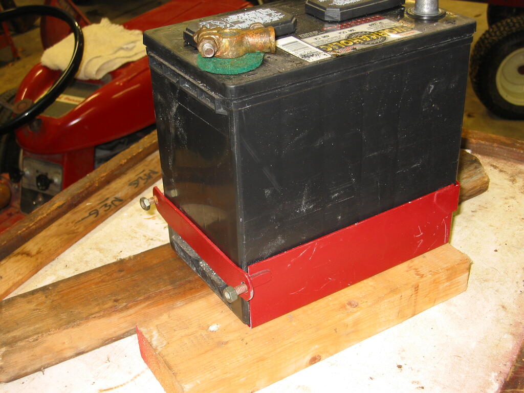

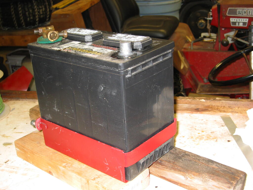

pfrederi 21,346 #6 Posted March 31, 2023 (edited) 1960s/early 70s used regular top round clamping type terminals Grp 22NF as Eric points out Grp 51 work also. This is a 22 NF in and older big battery tray Edited March 31, 2023 by pfrederi 1 Share this post Link to post Share on other sites
