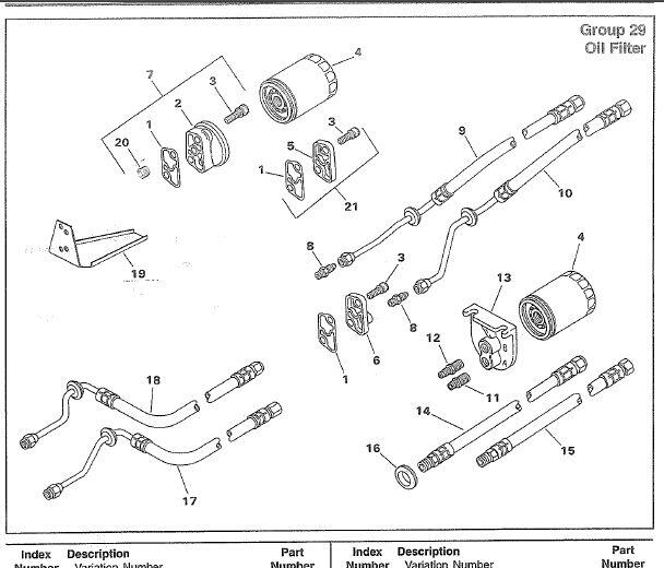

cod 136 #1 Posted March 24, 2023 Rumor has it that Kohler made a remote mounted oil filter kit for the M-18 (and perhaps other). Any chance the they are still available? Or are there other kits that one could use instead? The part number appears to be: #52 702 01. I've seen similar kits online but as the part number is different, I'm leery of picking one up unless it's a match for the original Kohler kit. Any info would be great!!! Thanks Share this post Link to post Share on other sites

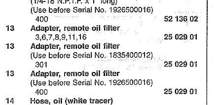

pfrederi 21,303 #2 Posted March 24, 2023 (edited) I didn't see that part number. As you can see there are different parts for different spec# variations and serial number breaks... Edited March 24, 2023 by pfrederi 1 Share this post Link to post Share on other sites

Wild Bill 633 943 #4 Posted March 24, 2023 Kohler remote oil filter kits: P/N 24 702 02-S w/ 23" length hoses and 12 050 01-S standard oil filter and P/N 32 702 01-S w/ 12" length hoses and 52 050 02-S 3.11" oil filter. 1 Share this post Link to post Share on other sites
