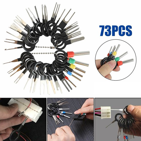

squonk 48,429 #3 Posted March 24, 2023 (edited) Search bullet terminal removal tool. There are many variations but it's mostly a stiff metal tube that slips over the terminal and pushes the retaining ears down so they slide out. This is a universal one. Another style: Edited March 24, 2023 by squonk 1 1 1 Share this post Link to post Share on other sites
