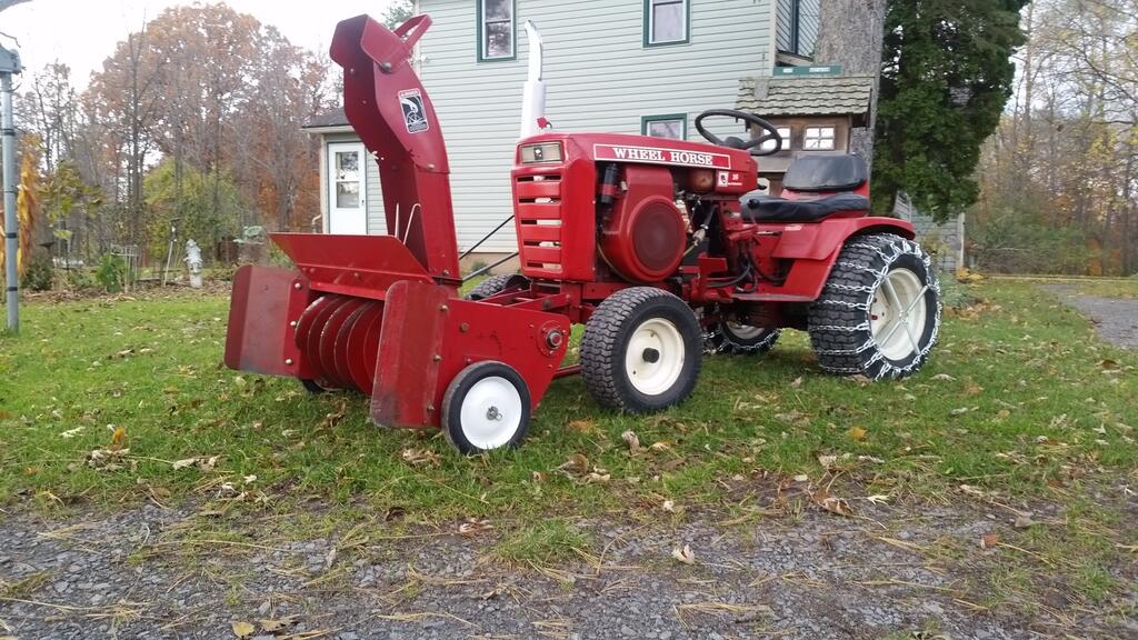

rjg854 13,404 #11 Posted March 20, 2023 Take the skids off and use the mounting pattern of them to make new skids that have wheels on them. 2 Share this post Link to post Share on other sites
WHX?? 58,302 #12 Posted March 20, 2023 17 hours ago, Larry Fostano said: Its not going to be fun raking this all out. I hear ya there Larry ... same thing here before I black topped. one of the reasons I quit plowing it and went to blowing. Plowing was worse @Red-Bovine actually had gravel piles on the lawn! I have two sno blowing machines now... one set up for scraping the blacktop and one set up high for "off road" to get out to the wood lot and dealing with gravel crowns and unevenness. Someday I am going to go Randy's route with wheels but want to figure out I can make them tool less adjustable. The thing I don't like about bumping it up is all that weight bouncing on the front and more sway. Alright I guess as long as you go slow. Share this post Link to post Share on other sites
JCM 11,419 #13 Posted March 20, 2023 18 minutes ago, WHX?? said: Someday I am going to go Randy's route with wheels but want to figure out I can make them tool less adjustable. The thing I don't like about bumping it up is all that weight bouncing on the front and more sway. 15 minutes ago, WHX?? said: Someday I am going to go Randy's route with wheels but want to figure out I can make them tool less adjustable. The thing I don't like about bumping it up is all that weight bouncing on the front and more sway. Share this post Link to post Share on other sites
Red-Bovine 337 #14 Posted March 21, 2023 Those wheels look AWESOME. Great idea. Share this post Link to post Share on other sites
