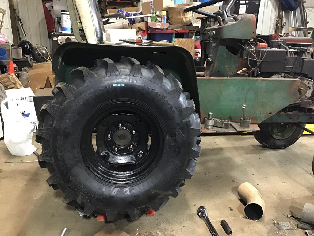

Pullstart 71,098 #6 Posted March 19, 2023 (edited) 1 minute ago, Monstrosity said: Found adaptors from 5 lug to 4 lug thank you guys!! What are your plans here? I have a couple of the 953/1054 tractors here set up with 5 lug hubs from other 1-1/8” axle Horses. It allowed 12” wheels on them. The 4 lug hubs are absolute monsters! Edited March 19, 2023 by Pullstart Share this post Link to post Share on other sites
