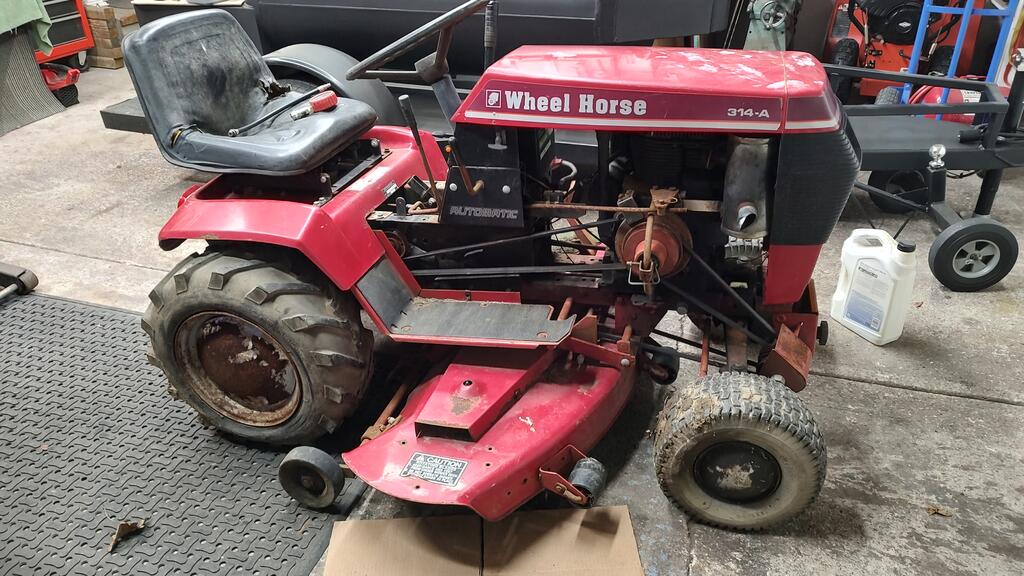

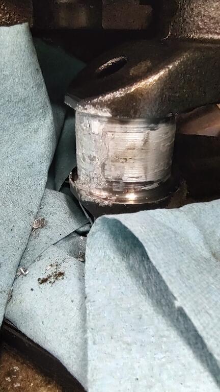

RedWheelz 149 #1 Posted March 17, 2023 Just picked up a 314-A with 48" deck and plow for $300 and the engine had a broken rod. I've never replaced rods or pistons and was wondering if this crank can be cleaned up and saved without removing it from the engine. I watched some guys on YouTube clean them up and they always had them removed. I really don't want to remove it.... Just not familiar with this stuff and was hoping to save crank 1 1 Share this post Link to post Share on other sites
OutdoorEnvy 1,807 #2 Posted March 17, 2023 I think you’ll have to remove the crankshaft to do it right and measure it for spec verification and inspect for damage. I had a similar buy with a 10hp kohler and the connecting rod blew and melted on the crank. I used muriatic acid to melt off the aluminium. It worked great. But this can be dangerous to do. So some research on it would be in order. Nice grab on the tractor though! Definitely worth saving and a plenty capable rig for most any chore. Looks like a K series Kohler too. That should put it at 85 or 86 year! 1 1 Share this post Link to post Share on other sites
kpinnc 17,152 #3 Posted March 17, 2023 You're gonna have to source a rod anyway, might as well be a 0.010 undersize and have the crank correctly ground to match. Find an engine shop and have the bore checked as well. When you reassemble everything, you've got 20-30 years of durability on your hands with proper servicing. Check isavetractors. They carry full rebuild kits. Take the block and crank to an engine shop, and order the corresponding kit. Don't be afraid of it. Using the Kohler service manual, and following it to the letter- you almost can't fail. These engines aren't complicated, but you have to stay within the tolerances specified. 5 Share this post Link to post Share on other sites

ri702bill 11,256 #5 Posted March 17, 2023 (edited) It is a very violent event when the rod stops turning and grabs hold of the journal. The rod breaks - at speed - and the rest of the rod pieces go flying off inside the block. Bought a C81 parts tractor that way - it broke the camshaft, ripped off the piston skirt and the bottom of the bore in the block - and punched a fist sized hole thru the back of the block under the coil mount. The short version - take the engine completely apart and inspect all components for signs of damage. Locate all the pieces of the connecting rod puzzle.Move onto measuring the journal diameter once the aluminum is removed to see if it has been cut before. Measure the block bore, top & bottom, for diameter, taper, and out-of-roundness. IF salvagable - have the block and crank and camshaft professionally "inspected" for cracks. (Magnaflux). THEN decide if is is trash or treasure..... I think fellow Forum Member @richmondred01 would agree - you have to be through and positive that it is repairable. Edited March 17, 2023 by ri702bill 5 1 Share this post Link to post Share on other sites

squonk 45,520 #8 Posted March 17, 2023 Crank will need to be measured with a micrometer not a dial caliper. It will also need to be measured at several points fore and aft on the journal. There are probably a hundred stories on FB and YT said "I cleaned up the crank and its fine!" As well as the ones that have a chipped cylinder from the rod hitting it and "it will last forever" Fix it right and it will last for years Or slap it together and have a time bomb. 3 1 Share this post Link to post Share on other sites

richmondred01 2,333 #10 Posted March 17, 2023 It needs to be torn down to the bare block. The crank isn’t an issue. It will need to be ground. The cylinder apron will need to be inspected for chips and cracks, if required, sleeved. Cleaned in a hot tank. The bearings most likely will need to be replaced because of aluminum chips. anything less then a complete rebuild is a waste of time and money. I rebuild engines like this weekly. If you want the engine rebuild properly drop it off. I’ll get it back to you in 8-10 days. 1 3 Share this post Link to post Share on other sites

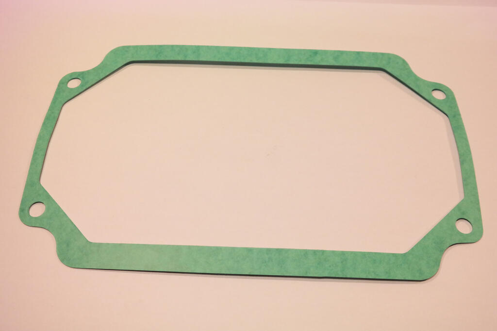

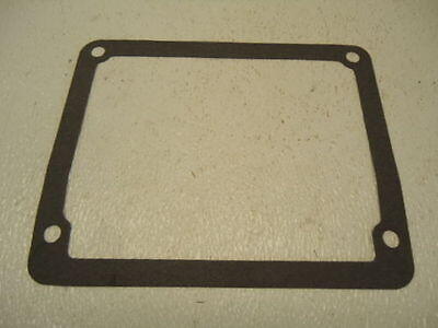

kpinnc 17,152 #17 Posted March 19, 2023 6 hours ago, oliver2-44 said: I’ve heard of oil pans and crank ends being different, but not the blocks? The engine in the ad has the "narrow" type base, and Wheel Horse used the "wide" base. The blocks are not the same, and can't be interchanged. The two pics below show the difference in gaskets for narrow and wide (green one). 1 Share this post Link to post Share on other sites
