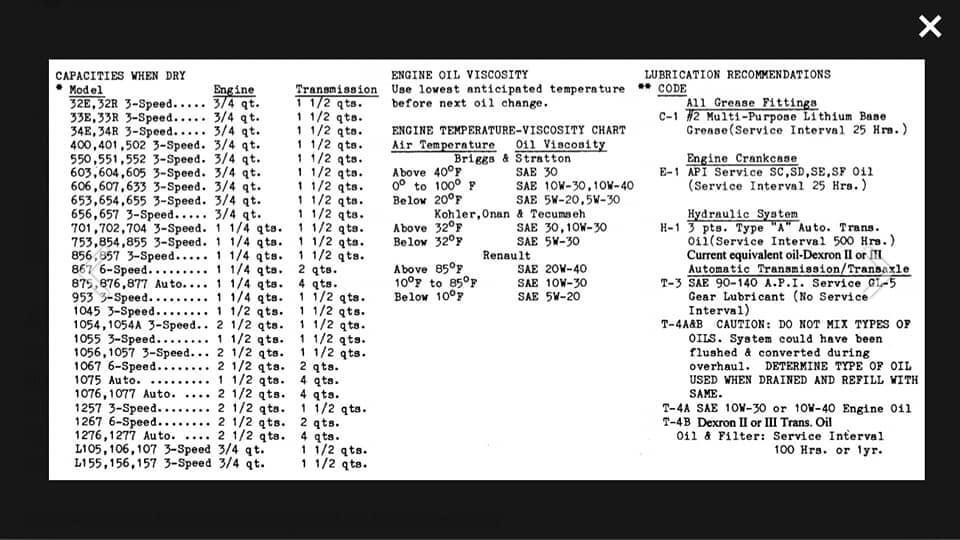

Lane Ranger 12,161 #4 Posted March 16, 2023 8 hours ago, Keith Plett said: I purchased my first Wheel Horse last fall and did not get a chance to do anything with it due to being in a cast from a couple of leg and foot surgeries. Today I put a new battery in it and it popped right off. I have some 30 wt oil for an oil change for it but do not know how much it will need. Sorry if these questions come off as stupid but as I said, this is my first Wheel Horse and I have very little to no knowledge about these fine little machines. I also would like to know about any other lubrication issues that anyone could possible enlighten a novice on. Thank you in advance for any help or info anyone can provide. Download your tractors manual on the Red Square Wheel Horse Forum in the Manuals Section. You will then have lots of accurate information on operation and a complete parts list. I have attached a list of fluids and capacities list for you to keep as reference. I put on garage wall as I have several different models. 2 1 Share this post Link to post Share on other sites
