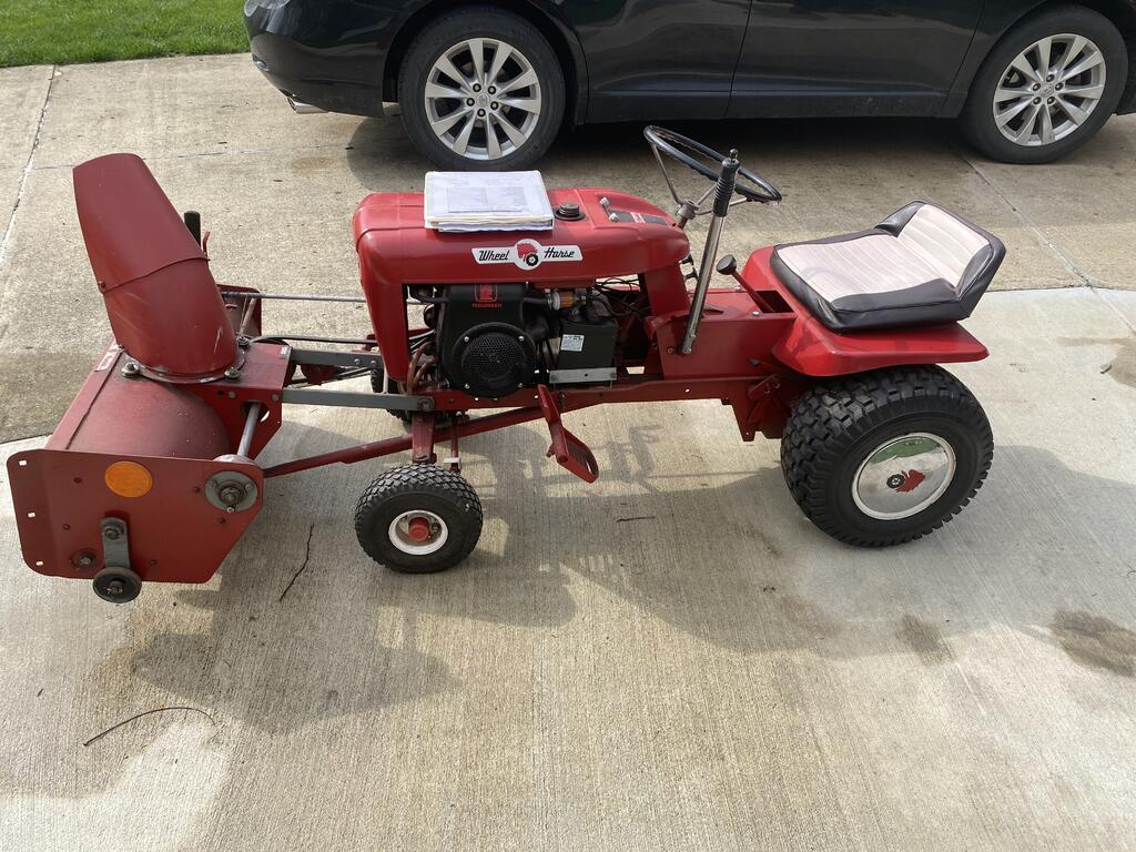

Lane Ranger 12,134 #3 Posted March 15, 2023 3 minutes ago, Ed Kennell said: No real experience here, but it looks like it would work. Although the lift systems seem poorly designed. The lift push point on the plow frame should be lowered to increase the lift leverage. yes I used one of these plows for my Lawn Ranger I had and I have to say it was not a very good attachment. The weak point is the way the lift bar is made with flat steel. My dad was a blacksmith and I had him mske me a heavier lift bar for my Lawn Ranger plow and I still thought it was not adequate support. I think you can make it fit on your Commando 8 but if you want to use for work a short frame snow/dozer blade would be a better bet. picture is of my old 1967 Lawn Ranger just before I sold it. Wheel Horse sold a lot of the Lawn Rangers and I read where Cecil Pond said it was one of his favorites. 4 Share this post Link to post Share on other sites
