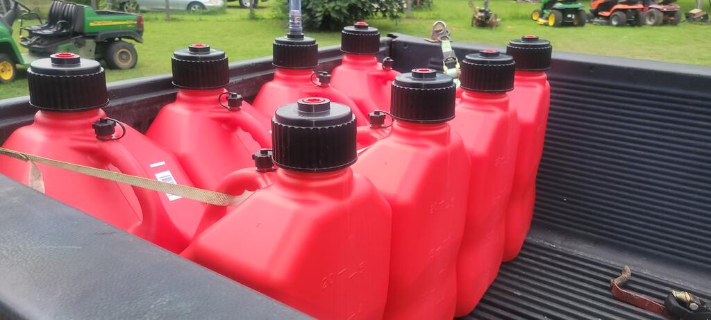

RED-Z06 2,720 #4 Posted March 11, 2023 Yall still screw around with epa/osha cans? Fully vented, no safety crap...will hold nearly 6g each 1 Share this post Link to post Share on other sites
clueless 3,436 #5 Posted March 11, 2023 38 minutes ago, RED-Z06 said: Yall still screw around with epa/osha cans? Fully vented, no safety crap...will hold nearly 6g each down here in the summer just make sure you keep the vent cap open. 1 Share this post Link to post Share on other sites
RED-Z06 2,720 #6 Posted March 12, 2023 1 hour ago, clueless said: down here in the summer just make sure you keep the vent cap open. I keep gas in a shed far away from my shop because grinding and welding, i keep the main caps tight and barely crack the vents, they've done great. Now if they'll be in the sun...yeah you better open those vents or youll have a nice balloon 🤣 Its nice being able to dump 5 gallons in a minute or less, love these things Share this post Link to post Share on other sites
SylvanLakeWH 32,141 #7 Posted March 12, 2023 3 minutes ago, RED-Z06 said: Its nice being able to dump 5 gallons in a minute or less, love these things Brand? Share this post Link to post Share on other sites
RED-Z06 2,720 #8 Posted March 12, 2023 Just now, SylvanLakeWH said: Brand? VP Racing Pit can 1 Share this post Link to post Share on other sites
RED-Z06 2,720 #9 Posted March 12, 2023 Looks like the price has shot up. 2021 i got 4 for $99 on Amazon then again 4 more a week later. They are a bit more now. I got a single spout, and put it on 1 lid, when I empty that can i just swap lids to the next full can. 1 Share this post Link to post Share on other sites

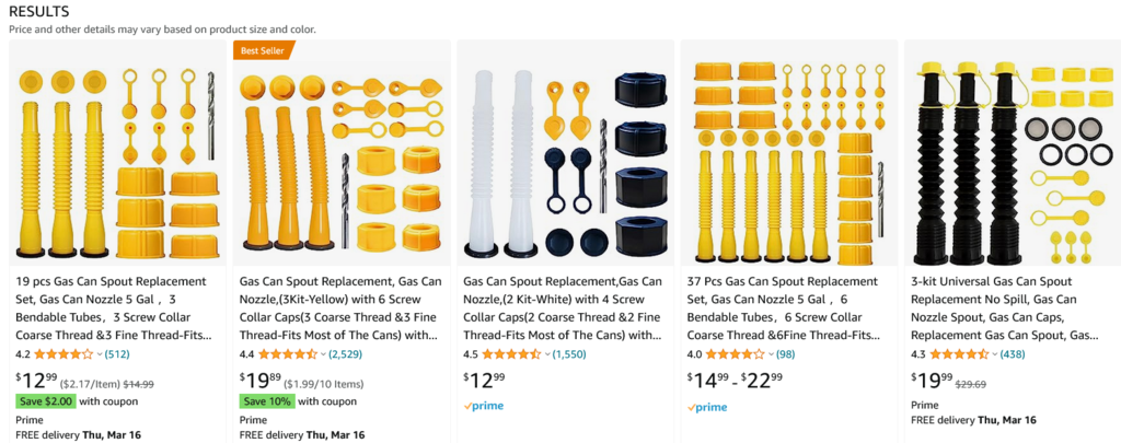

cafoose 3,817 #10 Posted March 12, 2023 I got these from amazon. Easily converts PIA cans to the old style. https://www.amazon.com/s?k=gas+spout&rh=n%3A15684181%2Cp_72%3A1248862011&dc&ds=v1%3A50HQeCPhyGJcwczFUP9gNXIgkZGCla8aJ5c3RXfzU%2B0&crid=DTUKM9VUMIL8&qid=1677281610&rnid=1248859011&sprefix=gas+spout%2Caps%2C146&ref=sr_nr_p_72_2 1 1 Share this post Link to post Share on other sites
