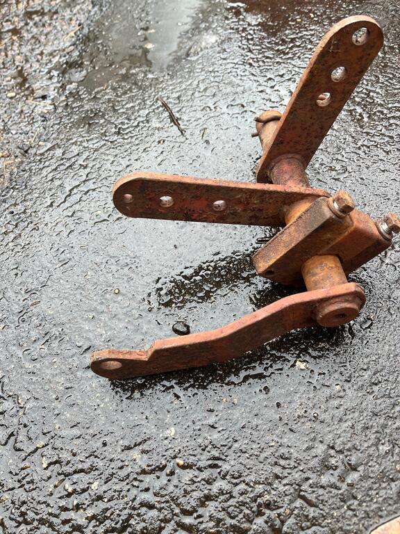

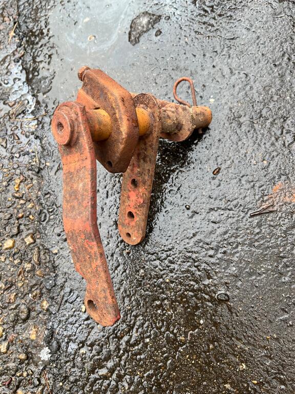

wallfish 20,576 #26 Posted March 11, 2023 (edited) This is for the older tractors but I think they had one for the C series too. But as you can see it's just a shaft with the handle removed and a bracket welded on in place to accept the actuator connection Edited March 11, 2023 by wallfish 5 1 Share this post Link to post Share on other sites

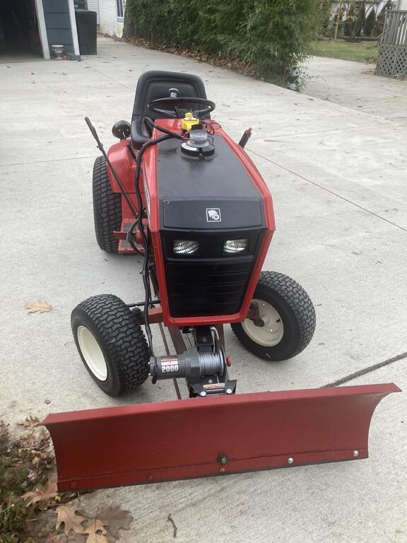

SylvanLakeWH 32,464 #30 Posted January 15, 2024 Update: Transferred to the C-105 and cleaned things up. Works like a champ. 3 Share this post Link to post Share on other sites

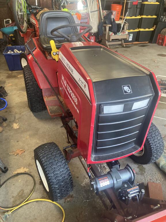

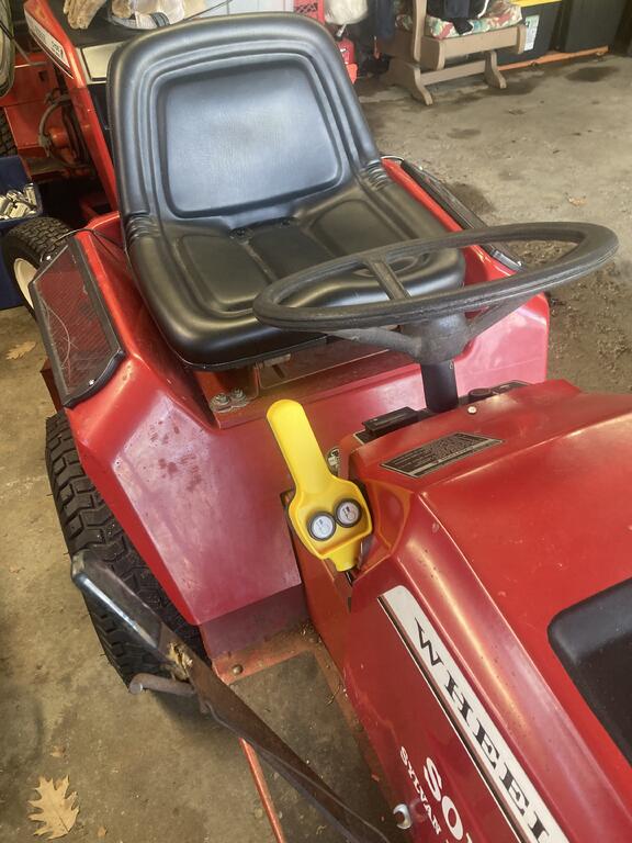

Ed Kennell 47,268 #33 Posted January 15, 2024 2 hours ago, SylvanLakeWH said: Works like a champ. Remembering the winch lift problem I had on my Yammy 4 wheeler Jim. How do you control the winch overrun with your short hook up? 2 Share this post Link to post Share on other sites
SylvanLakeWH 32,464 #34 Posted January 15, 2024 (edited) 2 hours ago, Ed Kennell said: Remembering the winch lift problem I had on my Yammy 4 wheeler Jim. How do you control the winch overrun with your short hook up? I remember. I raise it around 2" from ground. Gives me 2" of wiggle room before lock up... The push buttons are quite easy to gauge movement. I will probably add a spring per your great suggestion but it's working quite well as is... Just need to get 'round to it... at -5 this morning - meh... Edited January 15, 2024 by SylvanLakeWH 1 Share this post Link to post Share on other sites
Ed Kennell 47,268 #35 Posted January 15, 2024 1 hour ago, SylvanLakeWH said: The push buttons are quite easy to gauge movement. Great set up Jim. Just wouldn't want you to "fat finger " the up button and wreck something. 1 2 Share this post Link to post Share on other sites
SylvanLakeWH 32,464 #36 Posted January 15, 2024 1 minute ago, Ed Kennell said: Great set up Jim. Just wouldn't want you to "fat finger " the up button and wreck something. And as my fingers do indeed reflect my derrière... that is a valid and probable point! 2 Share this post Link to post Share on other sites
