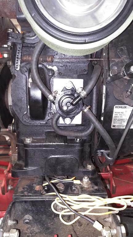

peter lena 10,107 #14 Posted March 11, 2023 @Horseoholic been using a CAR- BOLE electric pump for years , no problems at all , also wired in a single green led light at dash , to verify operating function . pricing was also good , very reliable . look it up , cost me about $ 20 , try amazon , pete 2 Share this post Link to post Share on other sites

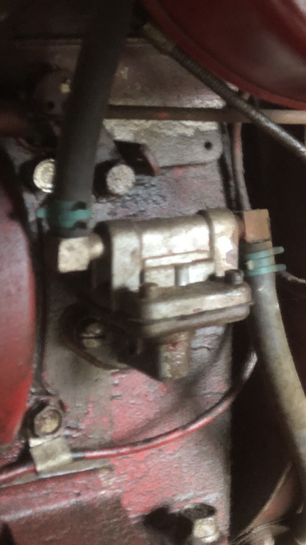

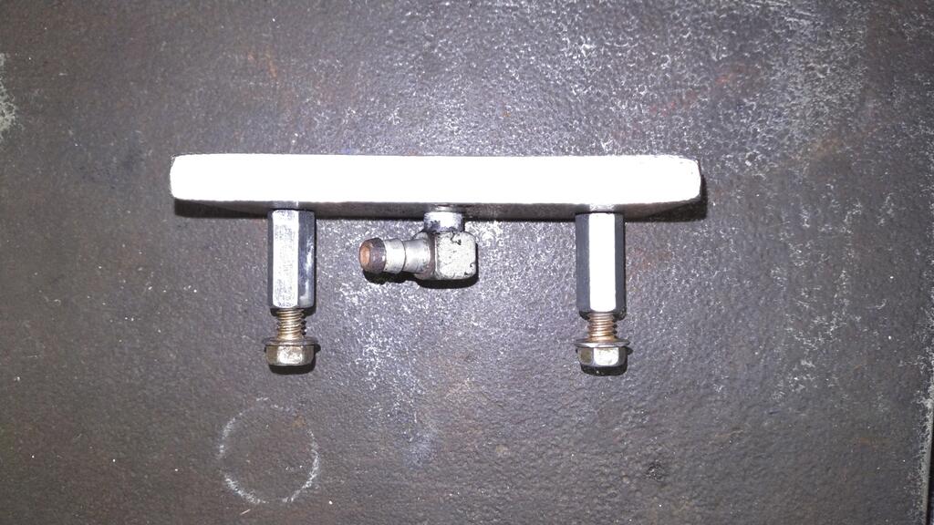

Bill D 3,193 #15 Posted March 11, 2023 I've done this conversion in recent years. Use a Briggs or Kawasaki pump. Homemade mounting plate. Works great. 2 Share this post Link to post Share on other sites
peter lena 10,107 #16 Posted March 11, 2023 @Horseoholic https://www.amazon.com/CarBole-Universal-2-3-5P-S-I-Operating-Self-Priming/dp/B01IR6BNKY/ref=asc_df_B01IR6BNKY?tag=bingshoppinga- this the one you want , low pressure part# 42 S , sorry about the other info I sent you , mounted it up front just in front of engine , or you can mount it close to tank . pete 1 Share this post Link to post Share on other sites

Mike'sHorseBarn 3,704 #18 Posted March 11, 2023 6 hours ago, Bill D said: I've done this conversion in recent years. Use a Briggs or Kawasaki pump. Homemade mounting plate. Works great. I've been wanting to try this....... Share this post Link to post Share on other sites

Bill D 3,193 #20 Posted March 12, 2023 4 hours ago, Mike'sHorseBarn said: I've been wanting to try this....... Here's another picture to help you make a mounting plate for yourself. Good luck with it. 1 Share this post Link to post Share on other sites

peter lena 10,107 #25 Posted March 13, 2023 @Horseoholic have these on my engines ,https://www.amazon.com/EVIL-ENERGY-Return-Petrol-Aluminium/dp/B08JJ128LN?th=1 , that vertical hose to carb area is a perfect spot for it , also use clear . vinyl fuel lines , so you can see the fuel hold . arrow on valve facing UP TO CARB , verifies fuel hold to carb , also ues dark green squeeze clamps , for a size to size fit . if your pump is faulty , get that done first , or combine the fix , pete 1 Share this post Link to post Share on other sites
