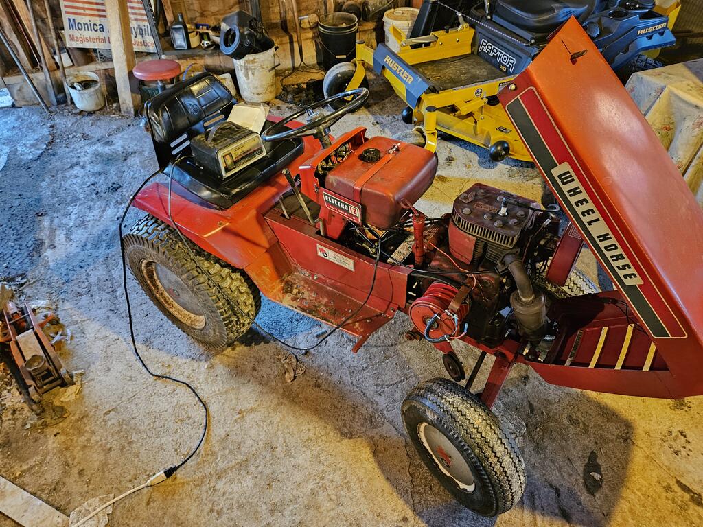

Mike'sHorseBarn 3,429 #1 Posted March 9, 2023 (edited) Is there a way to test a rectifier and see if it's bad? I'd like to test that before I just throw a new one on. I'd like to diagnose if it's that or if the problem is under the flywheel. Edited March 9, 2023 by Mike'sHorseBarn Share this post Link to post Share on other sites
