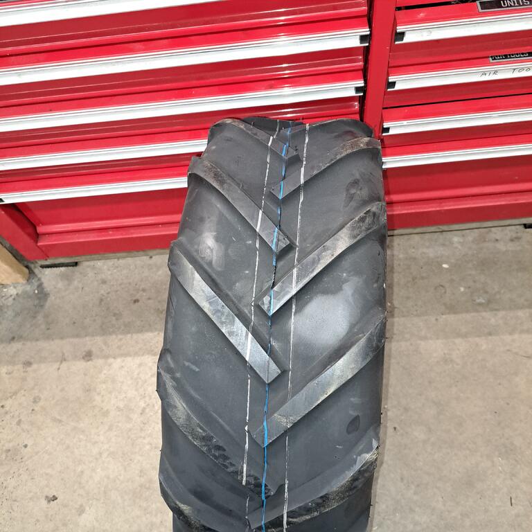

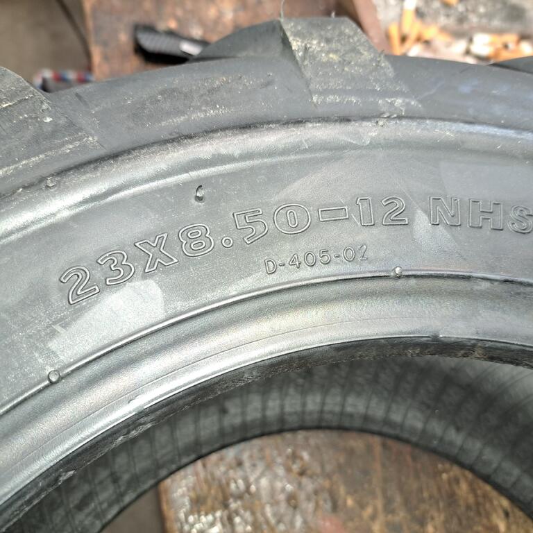

Pullstart 71,003 #20 Posted March 9, 2023 4 minutes ago, ri702bill said: Agreed, but do read the product reviews first..... And read the product details instead of the pictures @WHX??…. Uncle Jim recently got a screamin’ deal on some ag tires on eBay but the pictures and descriptions were totally different from each other! He still won, but it was like a lottery waiting for the package to come. We were taking bets on tread design, and whether they were going to be for a GT or a walk behind snow blower! 4 Share this post Link to post Share on other sites
WHX?? 57,642 #21 Posted March 9, 2023 (edited) 38 minutes ago, Pullstart said: And read the product details instead of the pictures @WHX??…. Uncle Jim recently got a screamin’ deal on some ag tires on eBay but the pictures and descriptions were totally different from each other! He still won, but it was like a lottery waiting for the package to come. We were taking bets on tread design, and whether they were going to be for a GT or a walk behind snow blower! Screamin deal is right. Shopping for tires for Aunt B and I run across a pair of Dees in 23x8.50- 12s for 57 clams shipped from a reputable seller. I couldn't believe the price and show the ad to Dan to make sure I am reading the writeup right. He says yep and I pull the trigger. Then I share the ad with Kev. He eagle eyes the pic and notices it says 16" size on it. Oh oh ... now what are we gonna get. I was gonna pull the trigger on some more and pass the deal forward but decided to wait until they were on the porch for inspection. Right size but totally different tread pattern than in the listing. Go back to order more and now listed at 189 bucks a set shipped. Crap oh well must have been a goof up when seller first listed. Wonder if one of the seller's employees got a butt reaming. 🤔 Edited March 9, 2023 by WHX?? 1 3 Share this post Link to post Share on other sites
