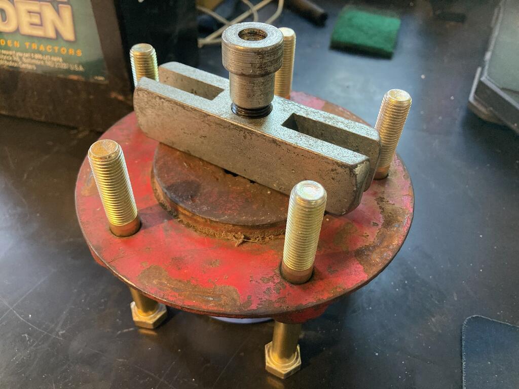

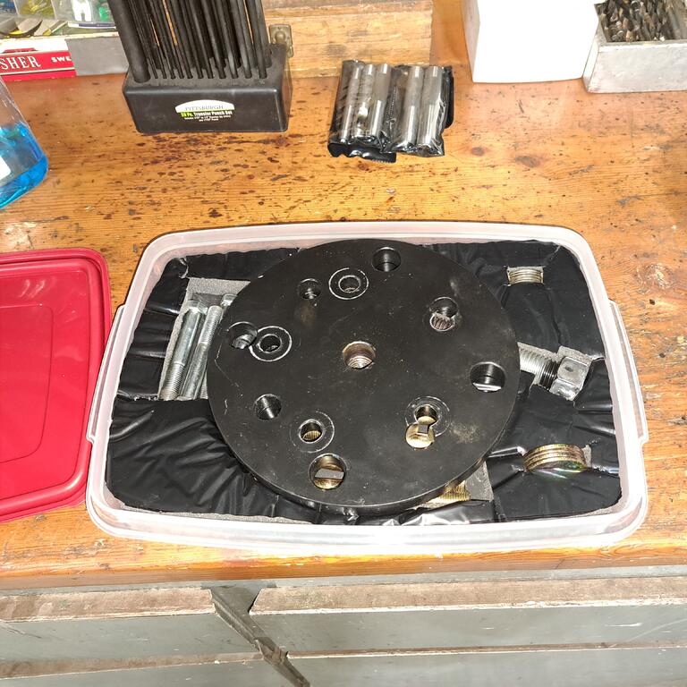

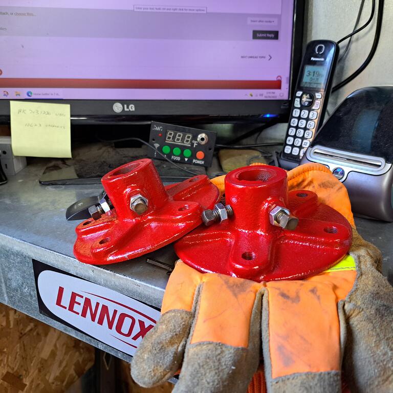

WHX?? 58,188 #29 Posted March 8, 2023 (edited) 7 hours ago, ebinmaine said: Been holding them for ya. Groove is gone but the bore is good. Throw em in a bucket and hoard em. RJG gave me a pair that I reworked and was going to pay them forward but ended up using them on Aunt B. Would be nice to have a fine thread in the center Dan but we'd have to go shop at McMaster. Mine came in a nice custom storage case... ... hope she doesn't notice her Tupperware missing. Edited March 8, 2023 by WHX?? 2 1 1 Share this post Link to post Share on other sites

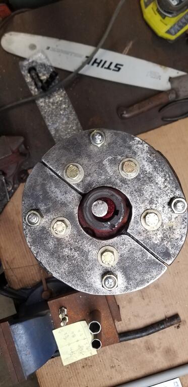

gt14rider 1,278 #30 Posted March 8, 2023 Here's one of mine pulls from the back 1 4 Share this post Link to post Share on other sites

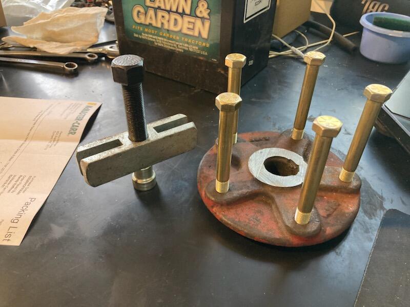

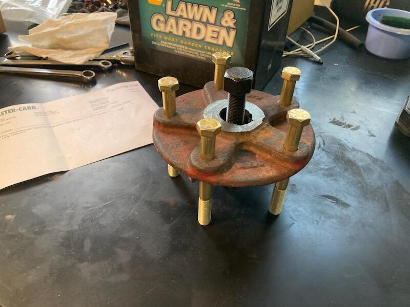

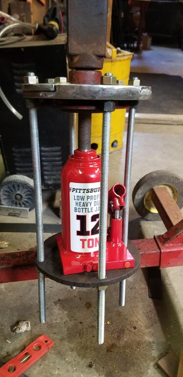

ineedanother 2,871 #31 Posted March 24, 2023 Other than hand tools and a drill press I don't have machines to manufacture things the way I would like so I have to make do. I have some hubs to pull but have been soaking them for weeks and they don't look too bad. I cut an old mangled hub back with a reciprocating saw to maximize the travel, bored the holes to 7/16", got some 7/16-20x4" from McMaster-Carr and repurposed an old puller. I'll find out this weekend what breaks first 3 1 Share this post Link to post Share on other sites
