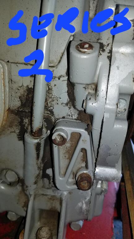

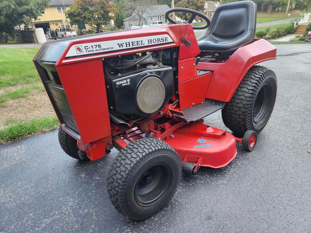

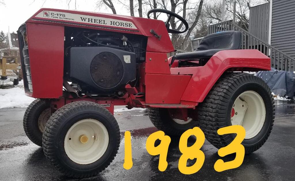

I have two C175s, both hydros -- acquired 2 yrs ago -- still learning about them.......using both, and doing various rehabs, repairs, upgrades, etc plus using for different tasks. I am aware of the basic mechanical design difference of the S1 vs S2 -- re: the crank and the S1 oil circulation deficiency and the Kohler/WH decision to design the S2 engine solving the S1 "flaw". I have what appears to be a 1983 model C175 with # 01-17ke03, #26795 with twin # KT17s-24223 # 12170338 that is Series 1 and BLACK in color ......... I also apparently have a 1984, C175, model #11-17ke01, #3299, but with no engine model or spec # decals, but is a Series 2 engine ( see photo ) and its GRAY in color.
I am trying to understand some of the production and replacement process WH used for both the two C175s I have now.... plus, I am considering additional C175s in the future with the KT 17 engines?? What model years was the Series 1 solely installed as their original from the factory engine? What years was the Series 2 solely installed and sold as original from the factory engines? What years did WH dealers start replacing defective Series 1 engines with Series 2 engines? It seems strange to me that WH would be installing new Series 1 engines as late as 1983 tractors like mine if they knew the Series 1 from 1980,81,82,83 was a defective problem design? When did WH begin to exclusively only install Series 2 engines in their new C175 WH tractors. One confusion is if ALL 1984 models directly from factory were Series 2 .... OR ...... were Series 2 only REPLACEMENT engines when Series 1 failed and dealers did replacement? thanks for any insights -- Bill
As a general rule, when you find a gray engine it was a replacement/service engine. This also holds true with the K model engines. Most dealers did not bother repainting replacement engines.
The full pressurized Series II KT17 spec# is 24300 and higher.

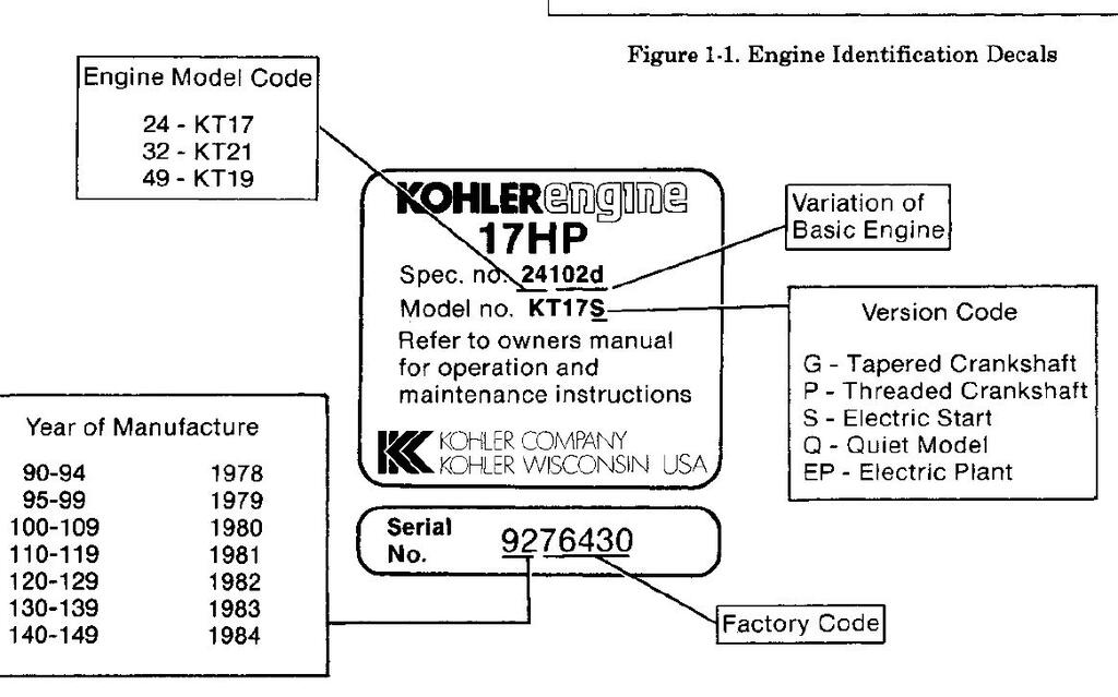

thanks !!!!!!! So then what is the difference and significance between the Series 2 engine spec with an "S" in the number, and an engine spec with "no "S" in the number ? The R.Sq "manuals" section states there is a 1984 spec of KT17S-24223, as well as KT17-24223 with no "S" ?
Additionally, if as you indicate the Series 2, KT 17 spec is "24300 and higher", why does the manuals section state a suffix # of 24223 which is a lower number for Series 2 ? These are the parts of the issue that confuse me I am trying to understand???? Thanks again!

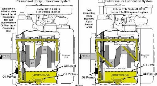

I can't speak to the serial number ranges or years of production. I have a complete series I KT17 and a Mag 20 "short block" in a box. I was gonna rebuild the Mag eventually, and use what I can from the KT externally. It's a shame really, because the KT is a great runner. But it has blowby that pushes oil into the breather.
Biggest difference as I understood was the lube type. Many of the internals can be swapped- including up to the Magnum line. The cranks obviously can't be swapped, but the jugs, pistons, rods, etc are the same for a given size.
Found a diagram that was helpful in explaining the lube differences too.

As for the S you should look at the KT 17 Service manual it explains a lot of things like production dates.

we got our two C175s 2 yrs ago -- the 1983 is S1 ( black ) ........the other is 1984 ( gray ) is S2  - the S1 runs fine but low hours -- hopefully it has a good life with us and was cared for by prior owners but we dont know its origin so its guessing game -- we have one small up and down yard slope for mowing -- so up it and down it in 10-15 seconds and we have one small side slope -- maybe 20-30 seconds - so hopefully that's not enough to damage engine -- we will keep oil changed and full !!!!!!!!! i would love to know the actual percentage of the S1s that were built that went bad and had to be replaced -- and if the damage was mostly all abuse, poor care, and lots of slopes??? Was it 5 percent, 10, 50 percent???  If they had good care and no slopes/hills, did they have a good longevity? I've seen many comments of S1 owners who have had no problems????? For us i guess only time will tell ????
