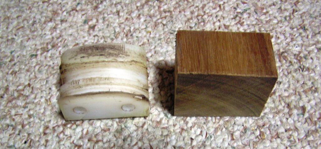

Wayne0 1,187 #1 Posted March 5, 2023 (edited) So, I found out I need a new chain tensioner on my blower. Looked it up (PN 957699) and almost fell out of my chair! $83 and change. Said to myself' "I can make that". End grain will be the wear surface. (original was wood btw) Easy, peasy! I did it, and it works perfectly and when it wears out I'll just make another. This is VERY hard wood. Edited March 5, 2023 by Wayne0 4 4 Share this post Link to post Share on other sites

ri702bill 9,400 #3 Posted March 5, 2023 Did a machine for an Automotive OEM near the Manchester Airport back in the 1990's. A large conveyor loop, had to transport HOT - live steam hot, 150 lb molds in and out of the oven... Conventional plastic glides would not work... They told us to use a wood material called Arguto - knot free hard maple that was impregnated with parafin. It was a stable material - cut and formed like aluminum bars. It performed like ice under a skater - the parafin melted under the pressure, then re-solidified immediately - stuff wears like iron....... 2 1 Share this post Link to post Share on other sites

Wayne0 1,187 #8 Posted March 5, 2023 BTW, the chain was junk too. Listed as "unavailable". It's just a piece of #40 roller chain. The original has no connecting link. It does now! 1 Share this post Link to post Share on other sites
