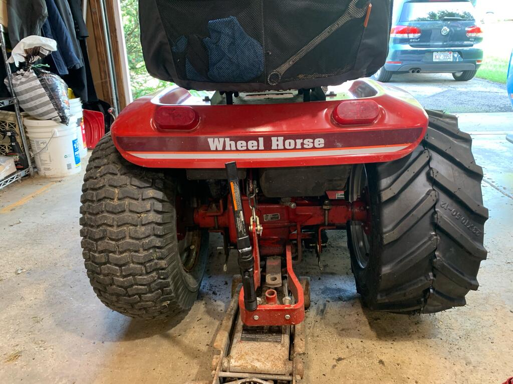

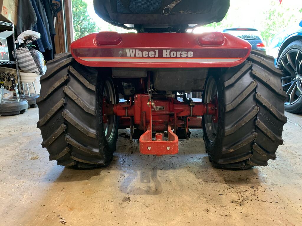

Here's my 418-A with 23x10.5-12 Ags. First pic has original 23x9.5-12 on left for comparison. Purchased from MillerTire. Word of caution...a 42" deck will hit the 10.5" wide tires.

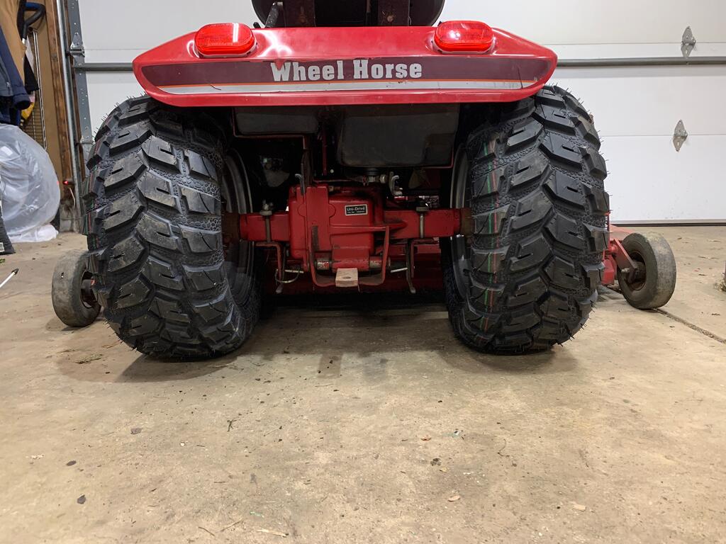

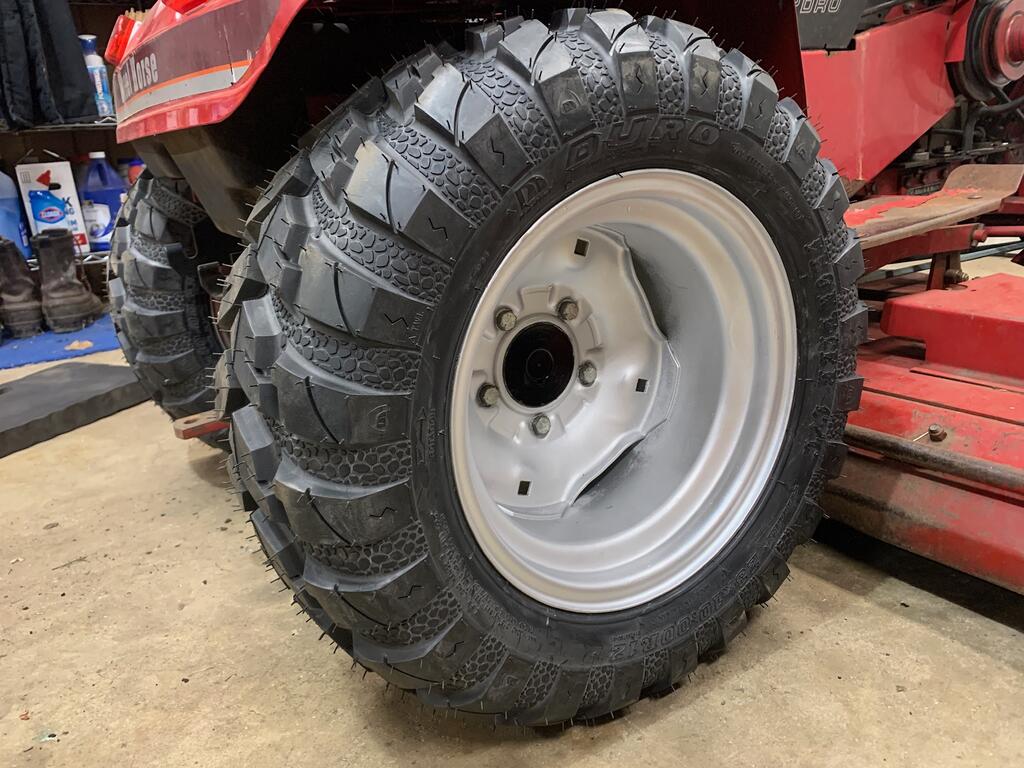

I also put these 23x10-12's on my 520-H. Got them from eBay.
