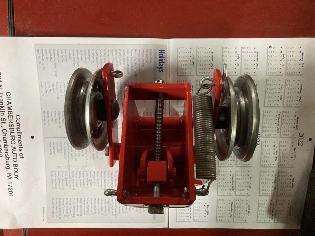

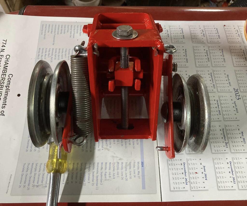

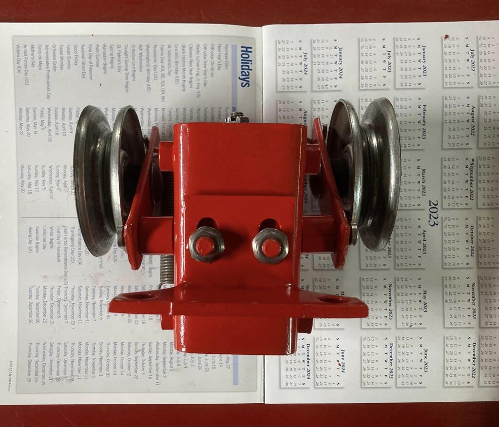

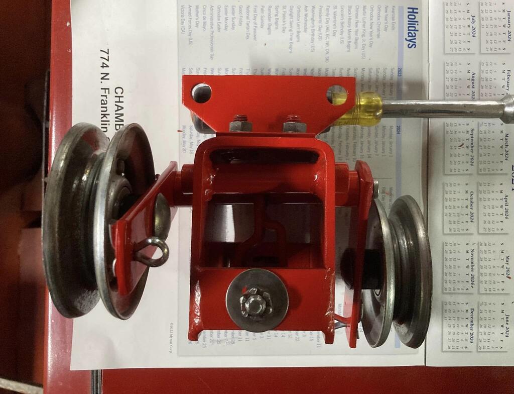

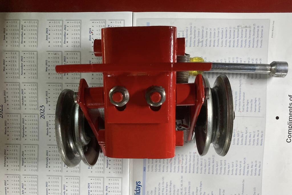

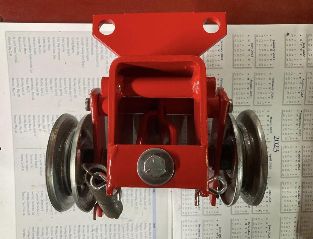

"Manic-Mechanic" 1,486 #1 Posted February 28, 2023 (edited) Hello, I am rebuilding the Mule on this tractor ahead of mowing season. So, not too many reference pictures of this assembly are out there figured might as well post some. Notice: it can be changed around so it'll adjust on either side or spring load either as well. I imagine if the adjuster was to fail, a pair of springs would possibly suffice? Edited March 1, 2023 by "Manic-Mechanic" Text Share this post Link to post Share on other sites
